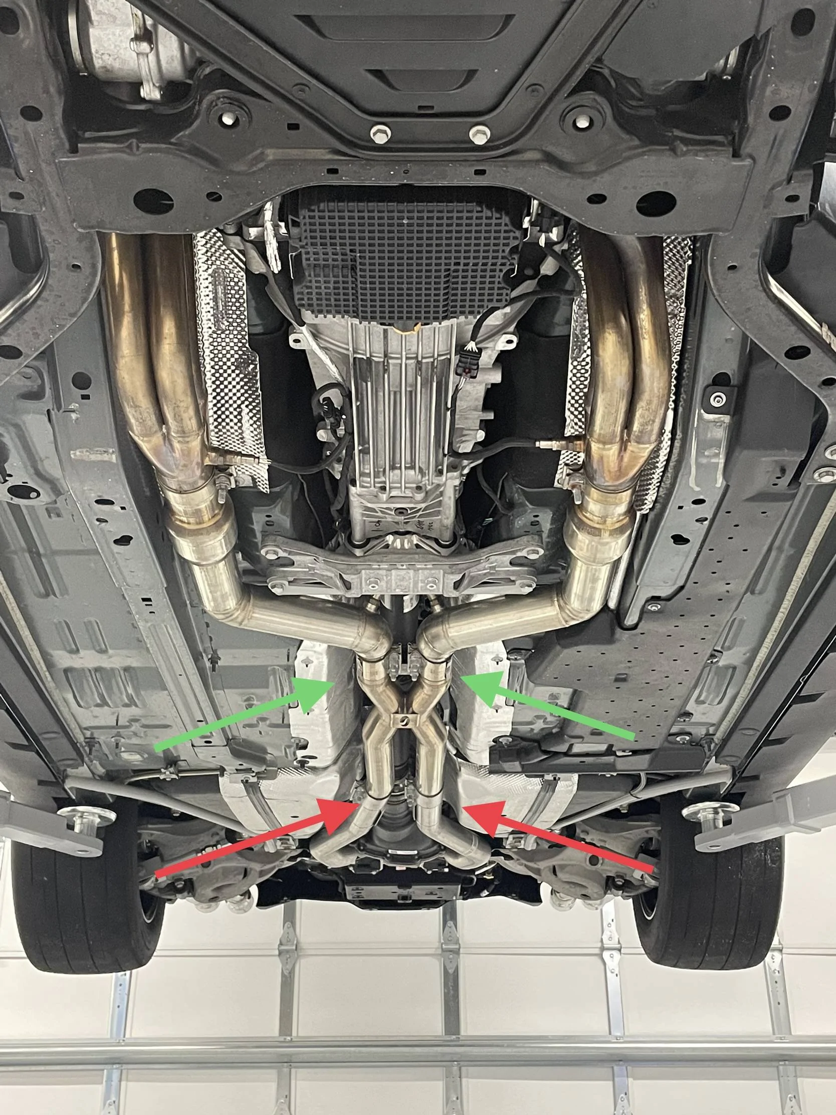

The only downside to welding the X or H pipe in place is, when it comes time to pull the exhaust for any reason, you won’t have the flexibility of removing only a portion of it and therefore, it will be more cumbersome. The factory clamps are high quality, but the clamps that came with my Steeda X were nowhere near as good. I never even used my supplied clamps. Instead, I ordered new ones on Amazon that were equivalent to the factory clamps for the rear section. Green arrows in pic reference the factory clamps and the red arrows reference the aftermarket clamps that I used in lieu of the supplied Steeda clamps.

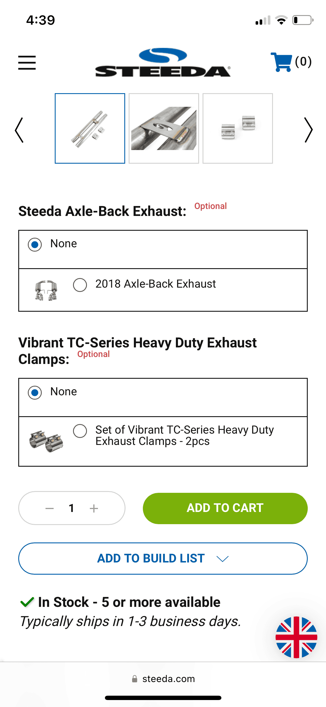

I did hear that they offer a chargeable upgrade now ? :like:
WD :like:
Good find on your end!
It should be included in the kit. If quality is one of their main priorities, then these higher quality clamps should be included. It's a great selling point as well.

OP the Steeda resonator deletes are on sale right now as FYI.
The heavy duty clamps are a ~$75 add on
