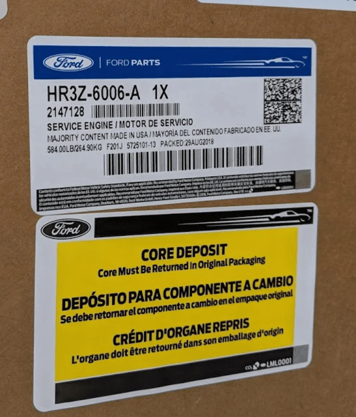

ok, I called a "guy", lol
Part numbers:
HR3Z-6006-A (w/SVT package) R model?
HR3Z-6006-B (Less special equipment) Non-R?
No idea why there's a distinction. @EF300 is yours an R?

This is the part number that showed up for me.
HR3Z-6006-A
you show
HR3Z-6006-B
Anyone here have detailed parts access and know the difference? I can see from cursory look this B number is a thousand dollars more. I'm almost convinced mine did not have attached flywheel.
Are both new or is one re-manufactured?

After more research, it may be related to whether or not it has an oil cooler. I don't remember looking carefully, but perhaps there are fittings for the cooler on one and not the other. That being said, by 2017, all GT350s had the coolers, right? :-\ We'll find out eventually, but probably something silly like that being the difference.

HR3Z 6006 A is GT350R engine tag HA555A from 1/24/17
HR3Z 6006 B is GT350 but that number has recently changed to the new level KR3Z 6006 B. Perhaps @Epiphany has better insight into the differences, if any between R and non R.... but for whatever reason, Ford parts catalog does have different part numbers listed. It could be any number of reasons why.
There is NO reman yet for these. They are NEW
