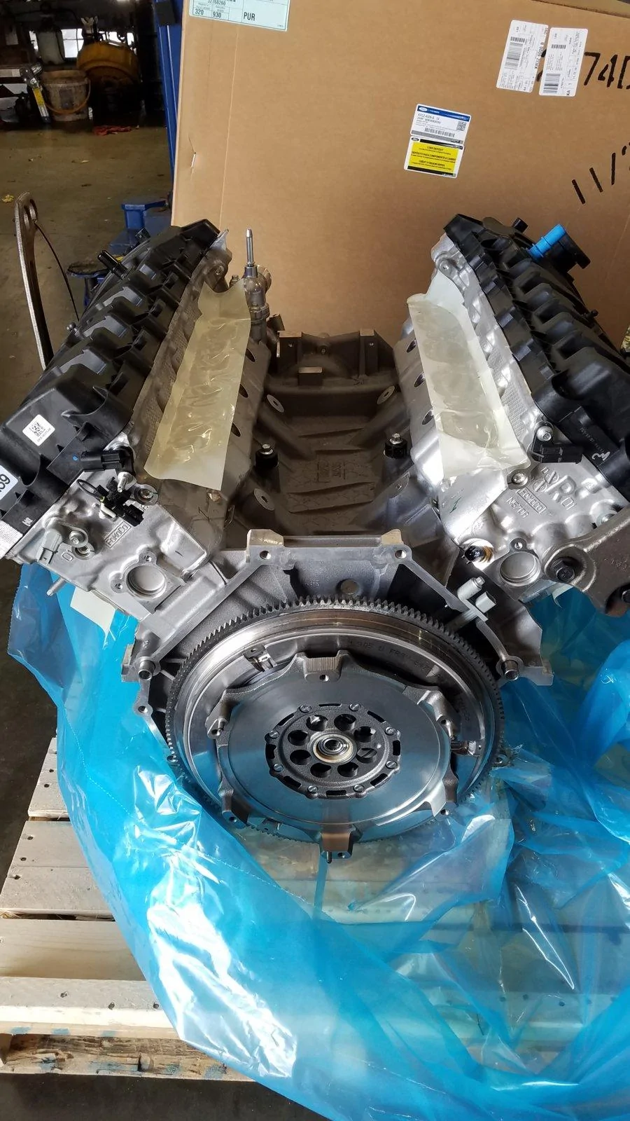

Here's that pic
Damn, why did ford cancel the warranty, was it modified ? This kind of stuff scares me, my service manager said I was lucky AF that i didn't tune or otherwise modify the engine b/c ford would have canceled the power train warranty.

So since the new motor came with a flywheel installed I am making the argument that A Worn clutch disc and pressure plate should not be installed on a new flywheel. I'm going to try to use that to get Ford to warranty the clutch out as part of the job. They're going to submit it. We will see what they say. There is another car in the shop right now that is having a McLeod clutch installed for some reason. Surprised the dealer is agreeing to install it but they are.

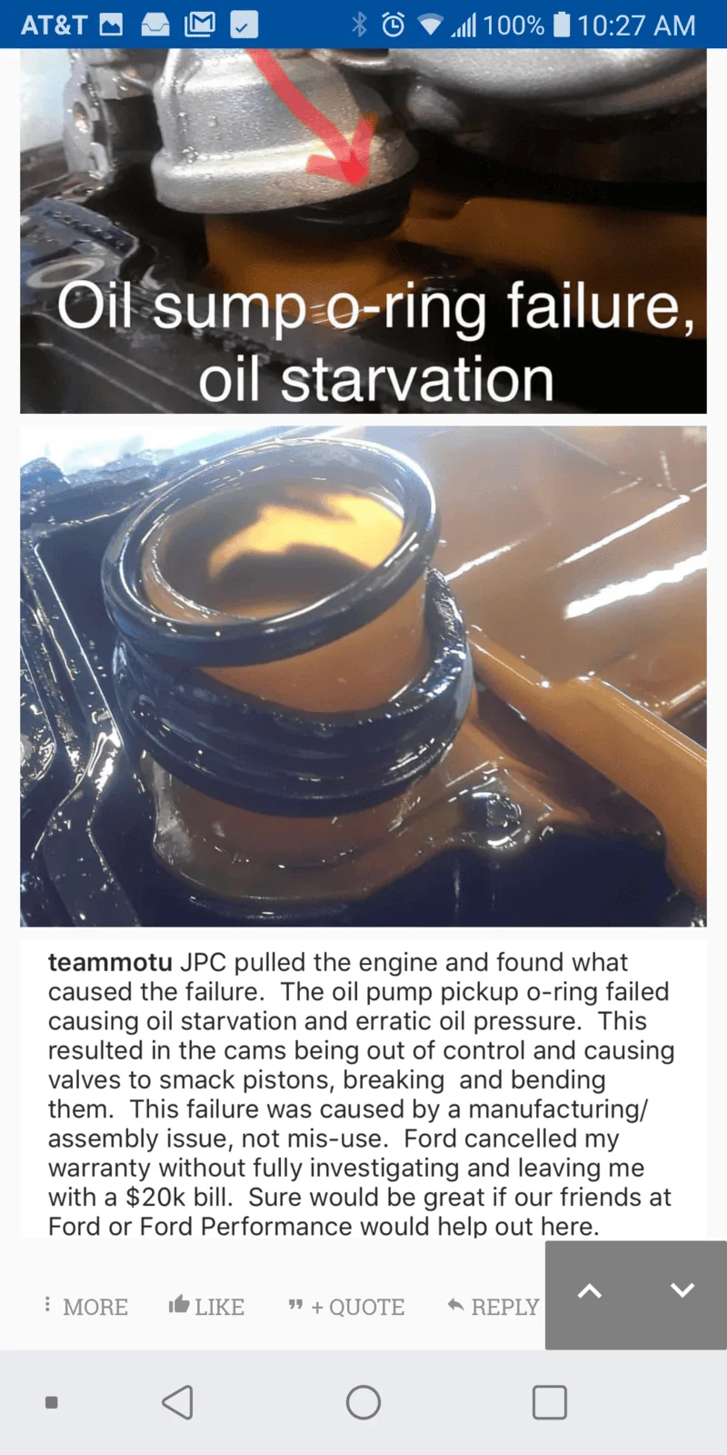

Recently there was photos of a bad o ring at the pickup. In that case, it was the cause of the oil starved engine.
Here's that pic
I did look up the design yesterday and that coupling was troubling for me. It's a composite with a rubber grommet. I'm no engineer, so all I can do is talk about something I know nothing about, but this looks like a risky decision. With head or vibration, you could have funny things happening at that junction, especially at 8k rpm. MMR has a solid pickup tube they offer you can use with their oil pans or standard GT oil pan. (not sure if I can post link) Problem is 2-fold however. We aren't certain this is an issue with the design yet and if you open the oil pan you have voided warranty. :-\
You realize that Ford engineers already tested the crap out of it, right?

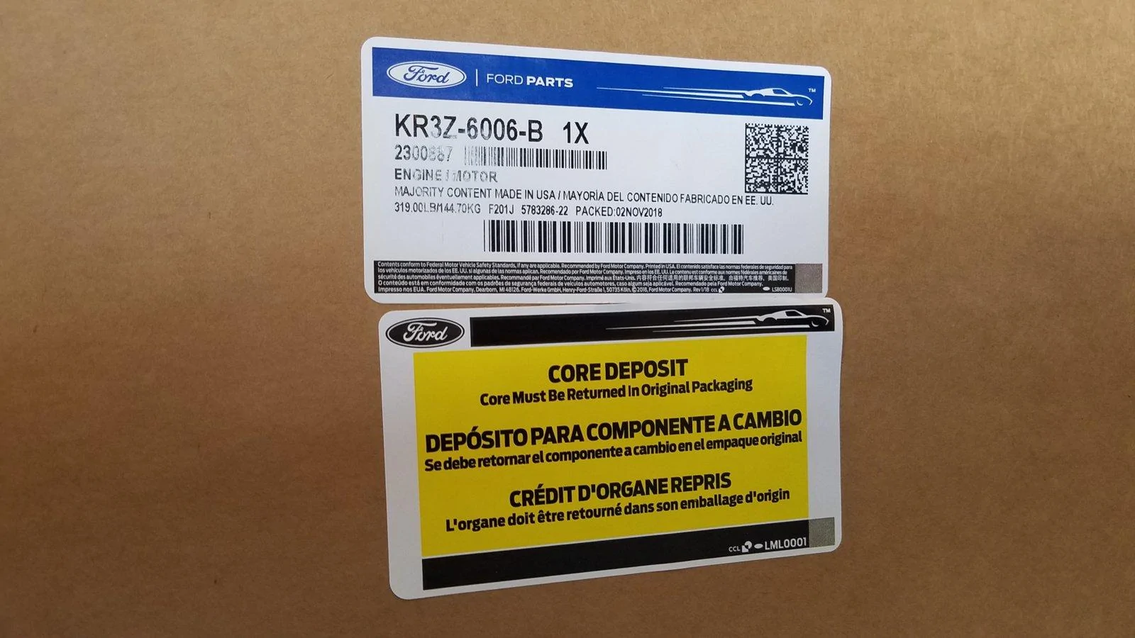

This is the part number that showed up for me.
HR3Z-6006-A
you show
HR3Z-6006-B
Anyone here have detailed parts access and know the difference? I can see from cursory look this B number is a thousand dollars more. I'm almost convinced mine did not have attached flywheel.
Hack, I understand your point, but I don't believe that control really exists. That we can reasonably rely on that assumption as absolute proof that this cannot fail. Maybe the o-ring supplier changed in between, maybe they didn't get "all" of the testing they needed. Engineering mistakes happen and I'm not upset at that, its part of the job, every decision is not always perfect, even after testing. For me it's more about finding out the root cause, and having Ford address it, for the sake of all of us. Even if they don't address it, we can have the aftermarket solve it when we are out of warranty.
Ford did a good thing with this car, bold, road racing mustang that departs from a lot of what was traditionally expected. We all went out there to front of the line to support this, now we are facing what could potentially be an engineering issue and for the sake of us and the car itself, needs to be fixed. I would hate for this mustang to be just known as the one that "blows motors". We'll see.
HR3Z-6006-A
you show
HR3Z-6006-B
I have been told by multiple people that this is a new not remanufactured engine. This one comes with the canister style filter. Which type of filter did your engine come with? Maybe that and the flywheel is the difference.
