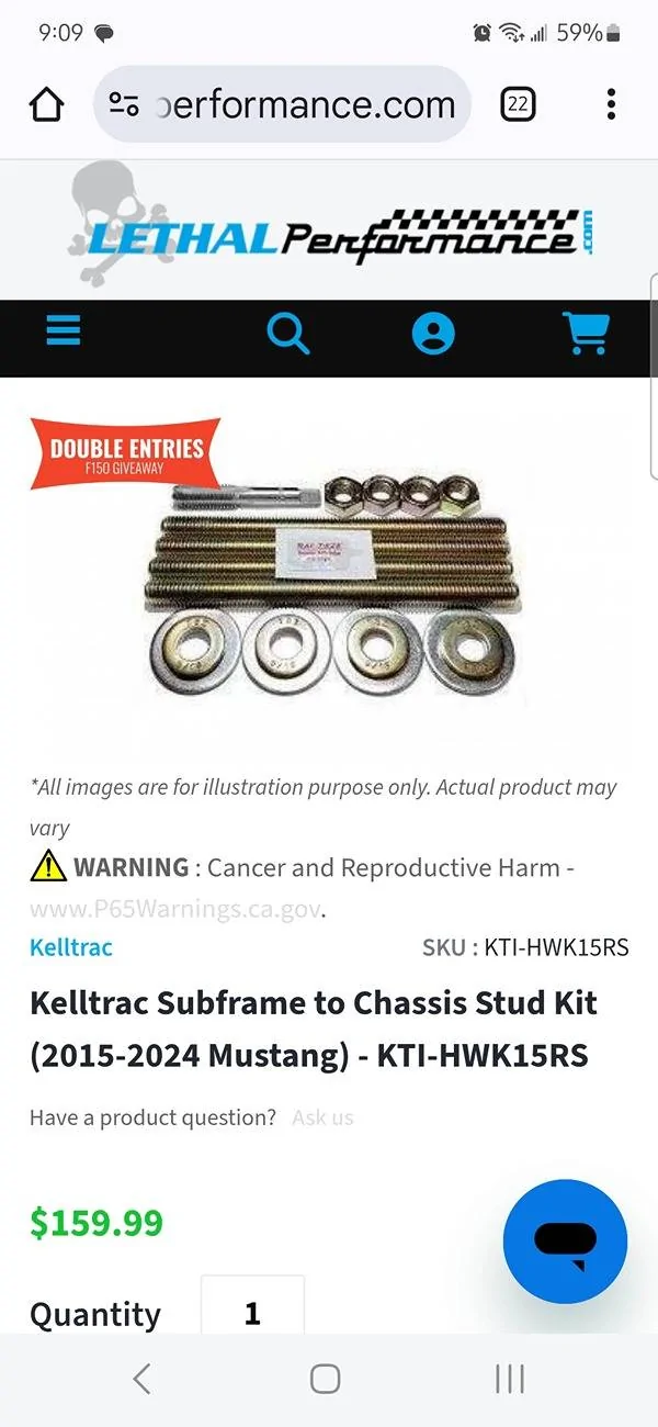

Ise the stud bolts kits. That way when you lower again you don't have to remove the OEM bolts. Plus you never put stress on the frame nut plates. Have fun
What stud bolt kit?

What stud bolt kit?
