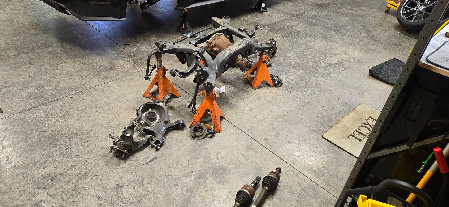

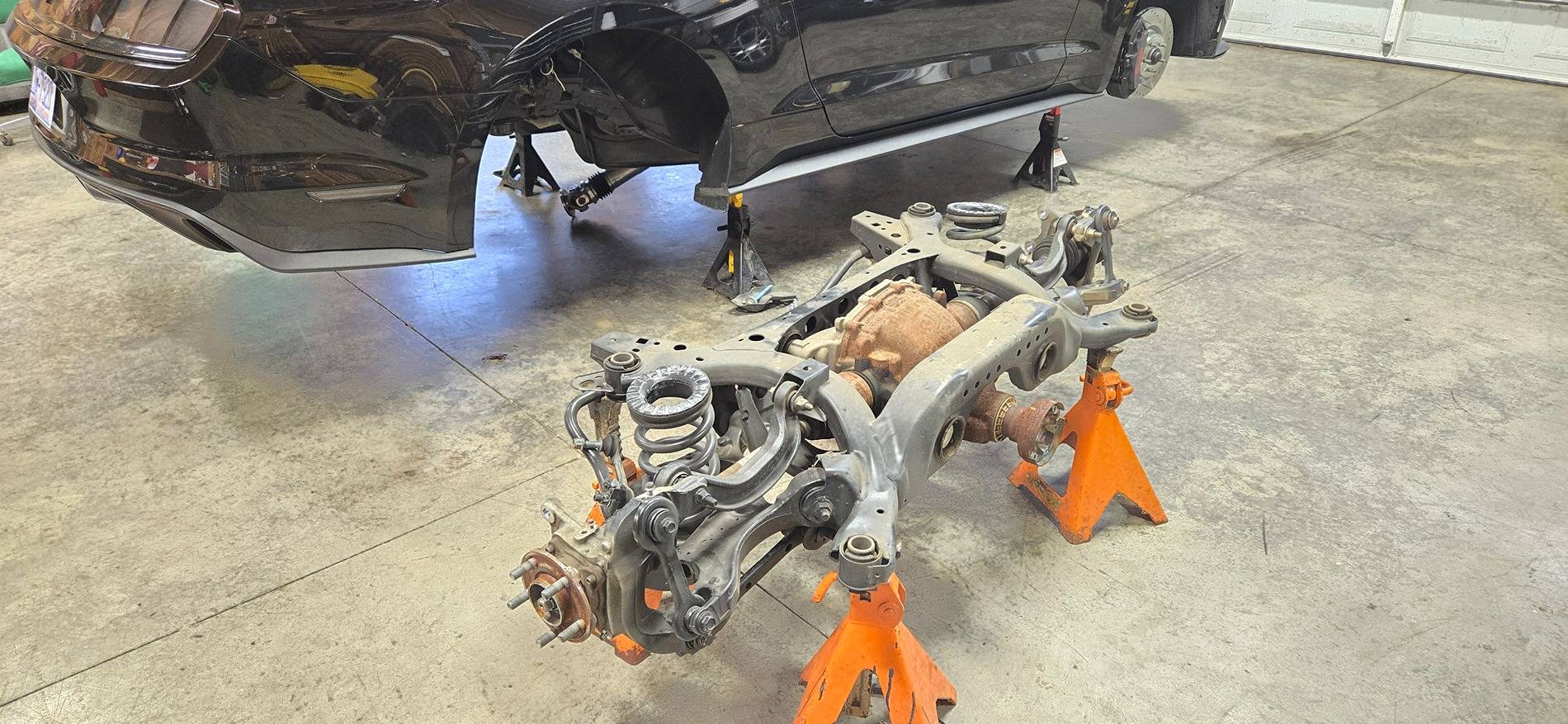

Well that escalated quickly... The car was sitting on it's tires this morning in my garage. Decided to start preparing for install of Steeda Diff Bushings and Through Bolt Kit, amongst other upgrades back there. Long story short, I found myself removing the rear assembly to make my life easier. It wasn't too bad actually. Going to go ahead and do some things I wasn't planning to, but it will be good and done for the long run.
Honestly, the hardest parts were the DS bolts (which I just did a couple weeks ago when I installed the Steeda 1pc Alum DS šŸ™„ and getting the driver's side Halfshaft out (it was in there buddy). But other than that, just bolts and nuts.

You did the right thing by removing it and it will indeed make your life much easier for those mods. I did the same thing when I installed my IRS upgrades.

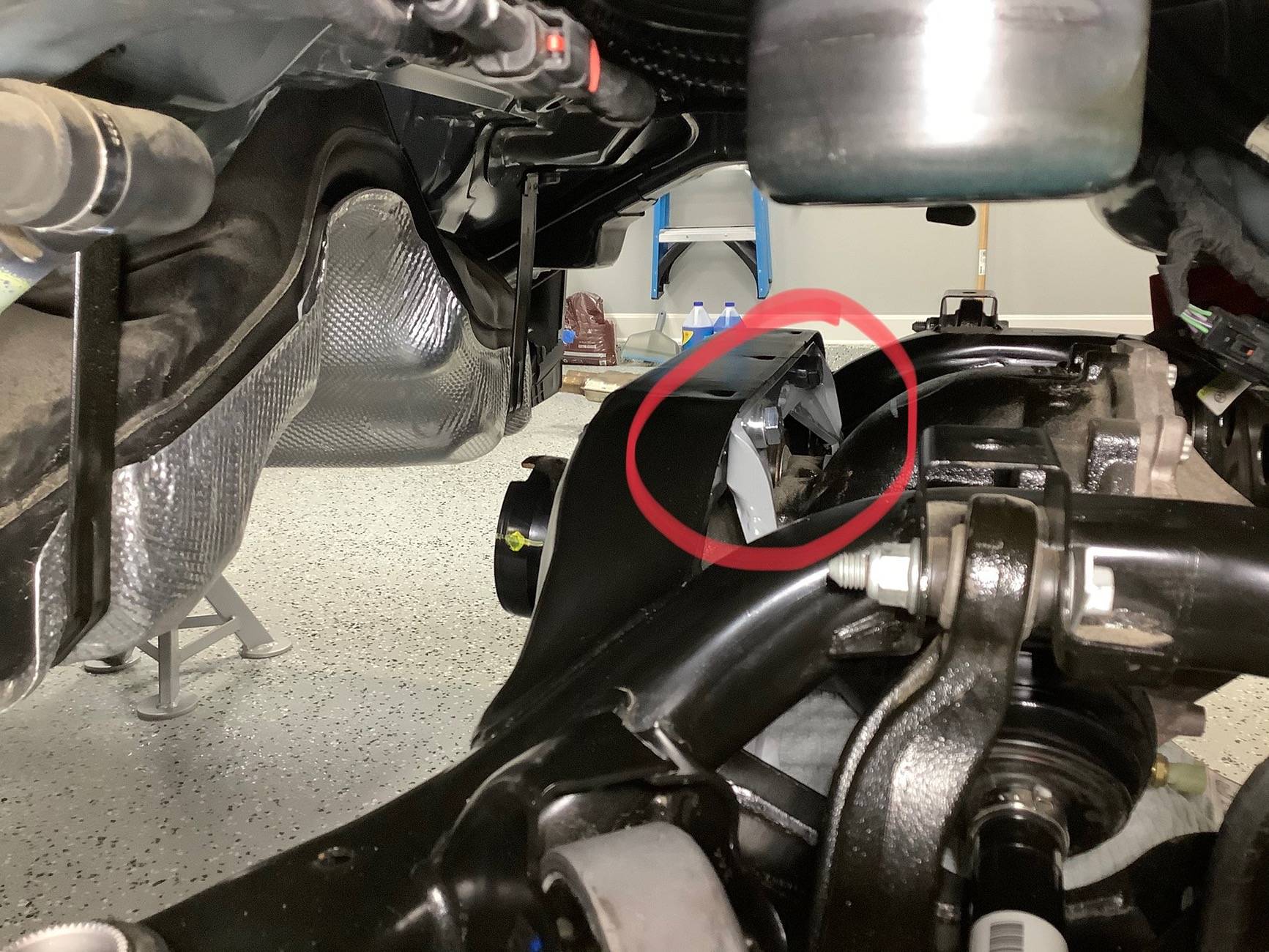

The differential bracket is supposed to strengthen the front differential ears and better support the diff. itself. I was going all in when I installed my IRS mods and wanted to add everything possible that could help make it better/stronger. I also didn’t want to drop the IRS again late on down the road to do things that I knew I would eventually want.

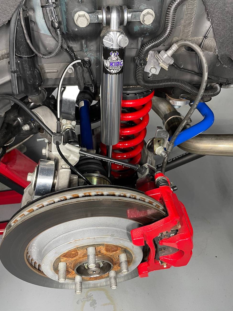

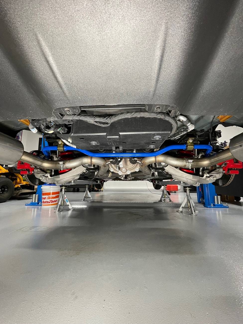

Very nice NGOT8R!! I have Viking shocks sitting in the garage waiting on reassembly as well!

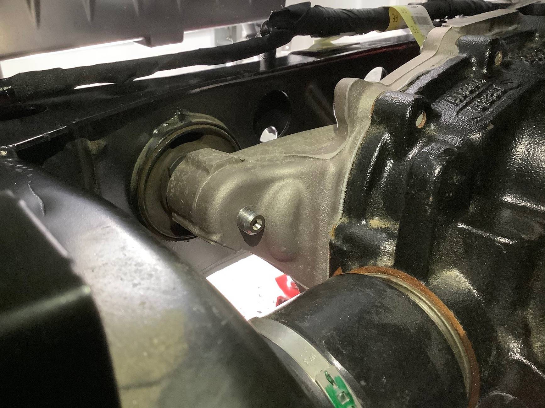

They have some cracking, but are not torn (I wouldn't say anyways). You can see the fractures from stress, and they are on their way to being torn in due time, but not there yet. The polyurethane bushings would require removal of the factory bushings, correct?
I did some reading on the BMR Camber Lockout Kit, and I understand the appeal to that. I don't necessarily like the fact that you are "locked in" (pun intented) into one of two locations though.
With that, I am looking at the Steeda Rear Camber Adjustment Kit 555-4126. I realize it is difficult to get to the drivers side for adjustment (fuel filler), but I have a very good alignment guy and we work together on the car. That is the way I am leaning anyways.
Still looking into the RCLA bearings. Thanks for the pics and info, that is what makes this forum great.
Thanks! Yes, the Steeda camber adjustment kit is also an option. I looked at it for mine, but decided against if for the reason that you stated. I figured with their adjustable toe links, I would be able to dial in the necessary camber and not risk it slipping and losing the settings. I recall reading about that when I was looking into that mod.
Yes, but if you’re careful, you might be able to remove the bushings without damaging the shell.
