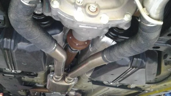

I heat-wrapped my exhaust next to the differential. Also changed to Amsoil fluid. No overheating warnings for me so far! Have only ran the car in about 95 degree weather so far, nothing over 100 yet...
