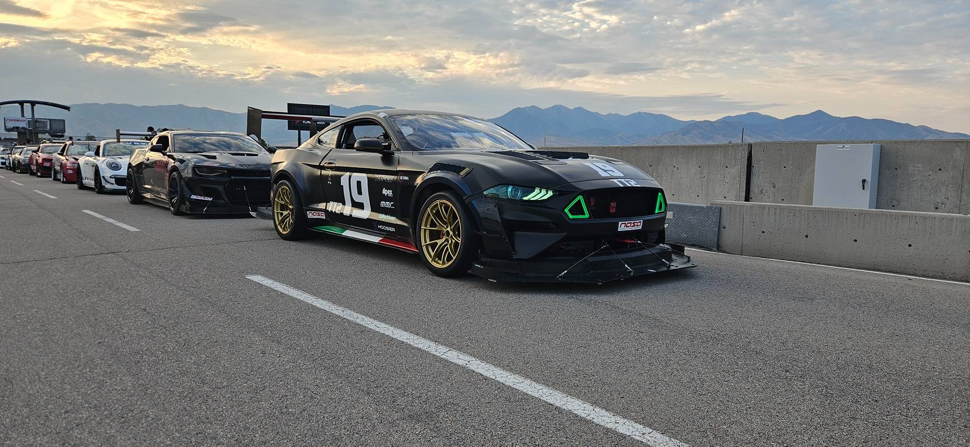

My example.
I used to change oil every event.
This time
I did 350miles at NATIONAL NASA RACING.
85f With 285f oil temps. i can guarantee i push the car :) ( right @Ewheels ?)
My sample came perfect.
He said to reach 1000miles and test again.
Hope this help
Ps. Olive oil was awesome. I made also many bruschetta!
