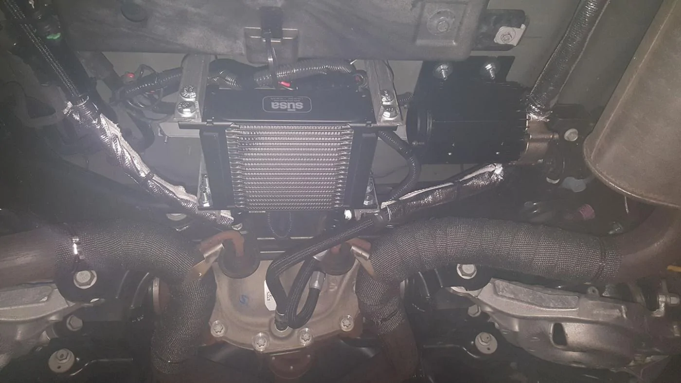

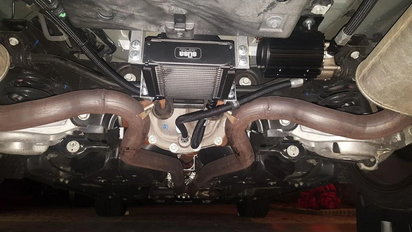

I think we may have released some spy shots on FB, but I think I emailed them to [MENTION=22354]tedj101[/MENTION] :ninja:
Ours uses a Setrab cooler with fan and Mocal's top of the line pump.
The Pump Specifications:
Flow 1-3 GPM / 50 psi max rating, 350Âşf maximum temp rating, self-priming, quiet low vibration operation. 10,000 hour rated bearings & motor brushes, hardened bronze pump (spur) gear rotors, black anodized aluminum heatsink, nickel plated pump head, stainless pump head fasteners, 3/8" NPT inlet/outlet, high temperature internal wiring, 3 foot wiring lead, rubber-isolated mounting bracket and feet, dimensions 6.2" x 4.1" x 4.0", weight 6.2 lbs. 12 volt, 5-12 amp* nominal. We wanted something reliable that would not draw much current. Cheaper pumps usually get hot and then the current draw spikes.
We also employed Goodridge and used their latest G-Max 825 product which is simply an amazing product. -8 Hose and fittings but the hose is actually 40% Lighter, 10% larger ID and offers 20% more flow potential over the old school rubber. It also bends like a pretzel because it is a smooth bore PTFE inner liner.
So we want to do some further testing, we may alter the position of the assembly. We wanted to keep it away from damage during an off but still allow air flow over it. We are still working on a single plate mount that will not require any holes to be drilled in the car. The fittings in the stock Mustang rear cover are very tight, it's why we are going to the Shelby rear cover, it offers more clearance and makes setting the fluid level much easier.
We have the harness mostly figured out, we just need to produce it so it is simple to install. This will not be for everyone, completeness and quality come with a price. The space available for a dual purpose street car is challenging.
