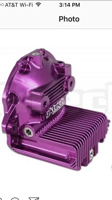

Any more info on this shelby finned diff cover?

Would anyone be interested in something like this?
I can have these made pretty easily but they wouldn't be cheap due to how they take on a lot of load.
They'd come standard with a fill and drain port as well ass an inlet and out for cooling lines. I can also have the return from the cooler line be directed to the pinion to help maximize efficiently.
I could also see a half quart increase in capacity as well.
These would probably come in around 1k or so.
On my 15 Ecoboost with Big turbo kit and a list of other things a mile long I noticed my differential becoming louder and louder after each event. Since the 15 didn't have a temp sensor I would just use my infrared. I eventually sold the car due to the numerous issues but I think a billet diff cover as shown would make a drastic difference.
