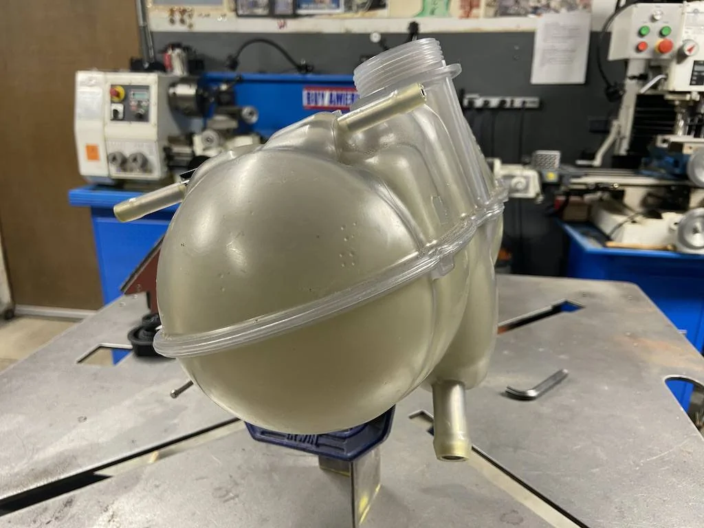

The tank dumps coolant over board, different design than the football . Early model Mustang, late model recirculates coolant .
FYI
Oem Bottle will do the same thing. Just doesn’t have a line that directs it.
Not following that, guessing the difference is early versus late model.
FYI
I'm also not following. All expansion tanks recirculate coolant, and all will dump coolant if need be.
Picture worth a thousand words.

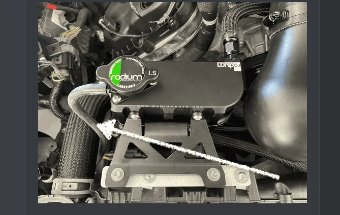

Was speaking about the Radium tank. The tank's most current part # is for a 2015 Mustang. Also the line looked to be an overflow ?
Thinking that the tank might be for an early model car ?

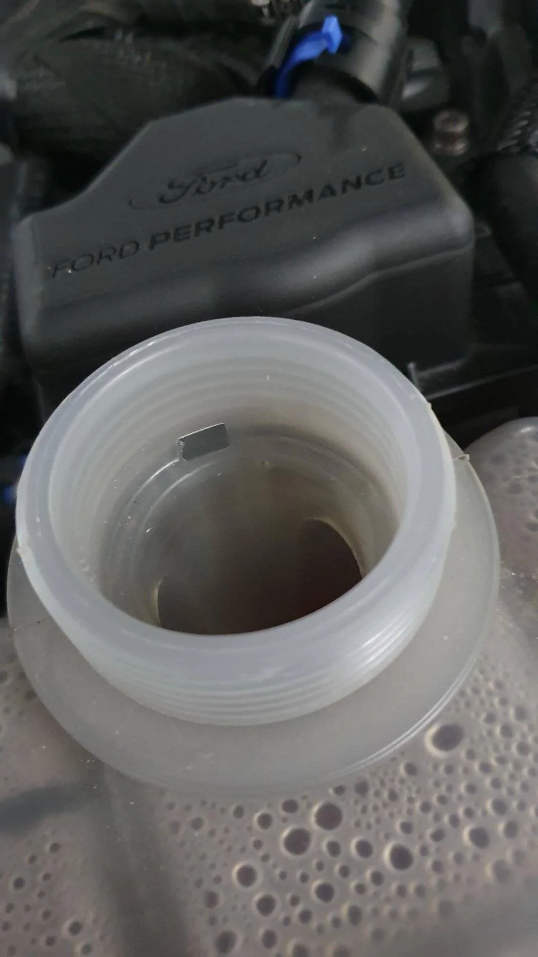

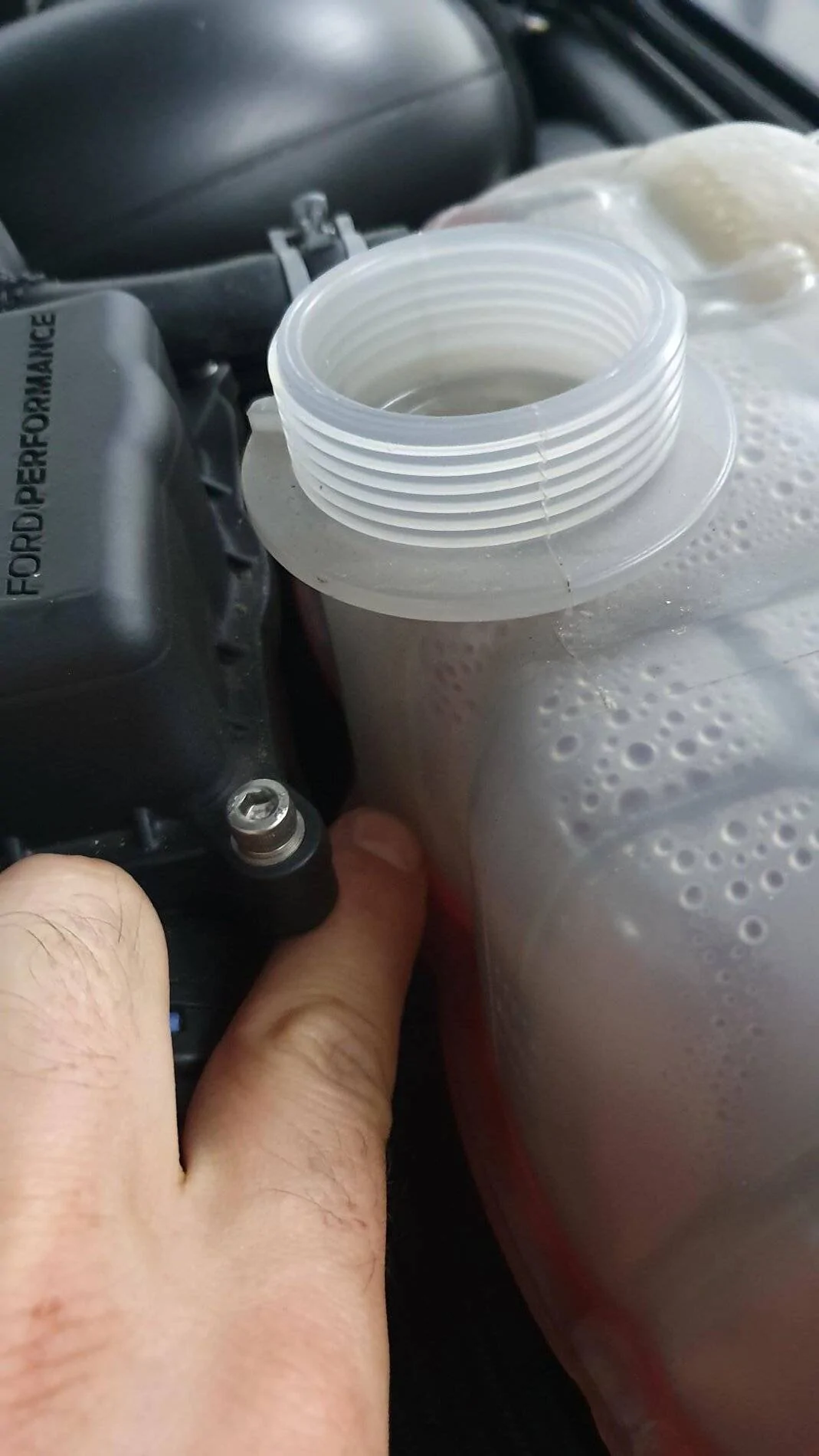

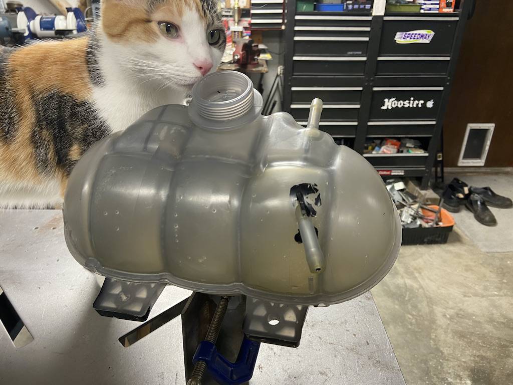

All expansions tanks have an overflow, incase you overfill it or pressure get's too high. Difference is the s550 overflow is incorporated into the tank itself. It will vent through the cap internally, through the internal hole and then drain out the rear of the tank. I just took a couple of pics to show you. All the s550 tanks are the same. :thumbsup:
it works with our cars as it has a 1.5 bar pressure cap like factory. Take your stock cap off and you’ll see the hole inside where the coolant will blow out in like this radium tank would.

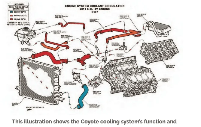

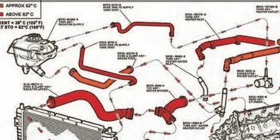

I am not sure what you're pointing at ?
Football has 3 ports .
Looking at the coolant diagram. 3 red lines off the football, are plumed to capture the coolant. No coolant is blown overboard, again maybe it is a newer design.

Look inside where your cats face is..... I can see it when I zoom in on the picture.

I think he's talking about the square hole at the bottom of the threads.
