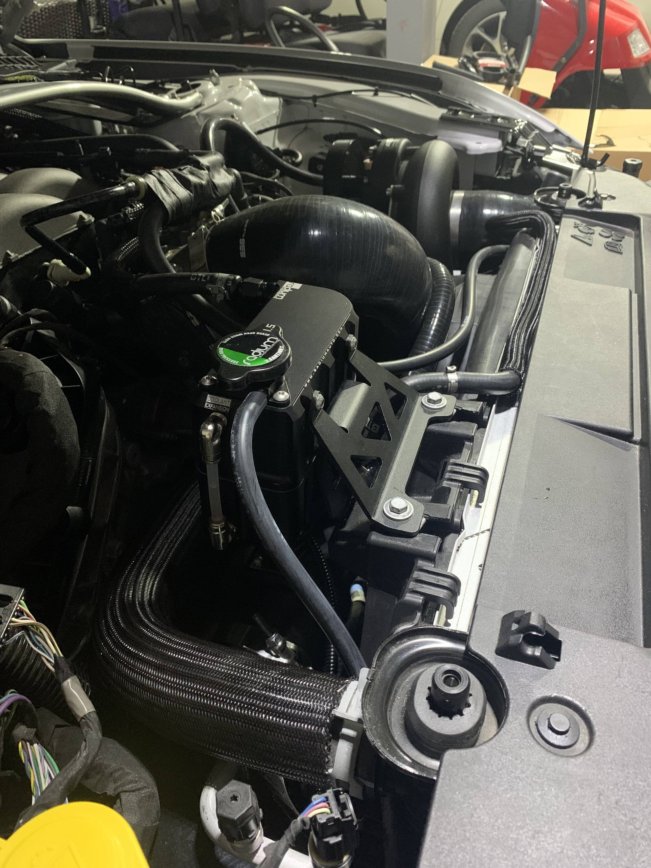

Anyone here upgraded the ugly plastic coolant overflow tank with the Mishimoto. Any issues? I have the Ford Performance oil seperator and i've read posts where they say its a tight fit. Also worried about the little tube on the side breaking loose and losing coolant. Thoughts?

I did and if it's the one with the sight gauge I had a problem. The nipples that attach to the tank and hold the clear level tube popped off and overflow tank fluid was lost. Oddly the nipples just press over the fitting oring. I found correct orings and replaced them and it seemed fine but a couple days later same issue. I contacted Mishimoto and they said they carried no parts (really) and I should file a warranty claim to replace the entire tank. What a crock. I went to Advance Auto, bought brass plugs and plugged both ports. I'll just visually check it occasionally. I originally ordered my tank polished but the polish job was terrible. I had it powder coated.

Thanks for the input, that is what scares me as I read the reviews of several guys that had that sight tube pop off. What a poor design. It's an accident waiting to happen. If I go with it I might plug mine as well. Do you have a link to the plug part and a picture?
