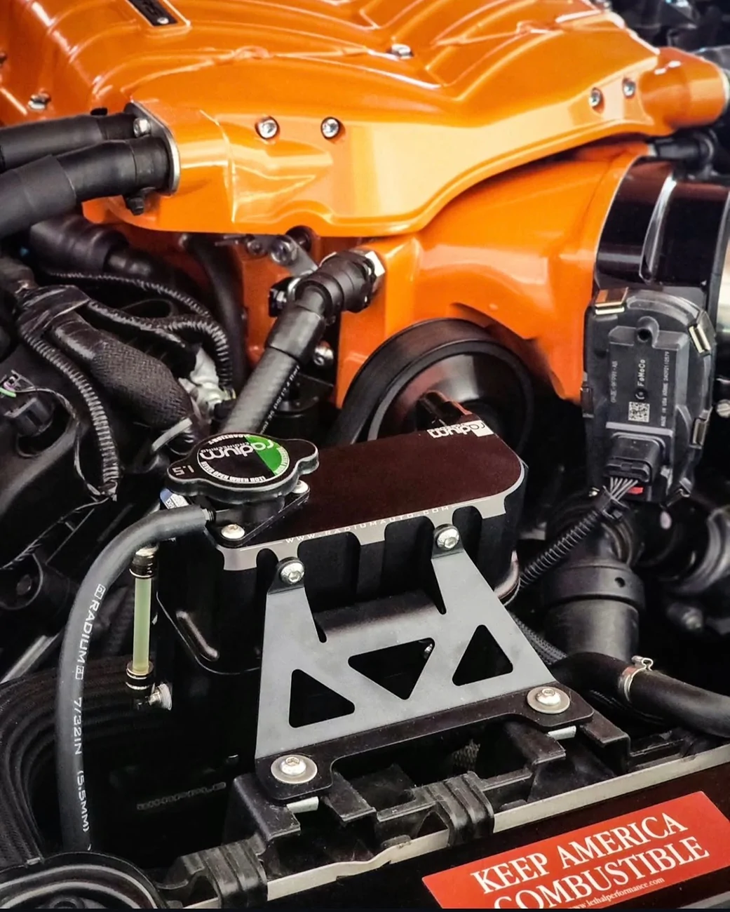

I appreciate the info and the pic! That’s all I needed lol, I’ve had an orange stage 2 Whipple on order since thanksgiving…. I’m hopefully getting close to getting it, so your pic was perfect! Ordered my Radium!

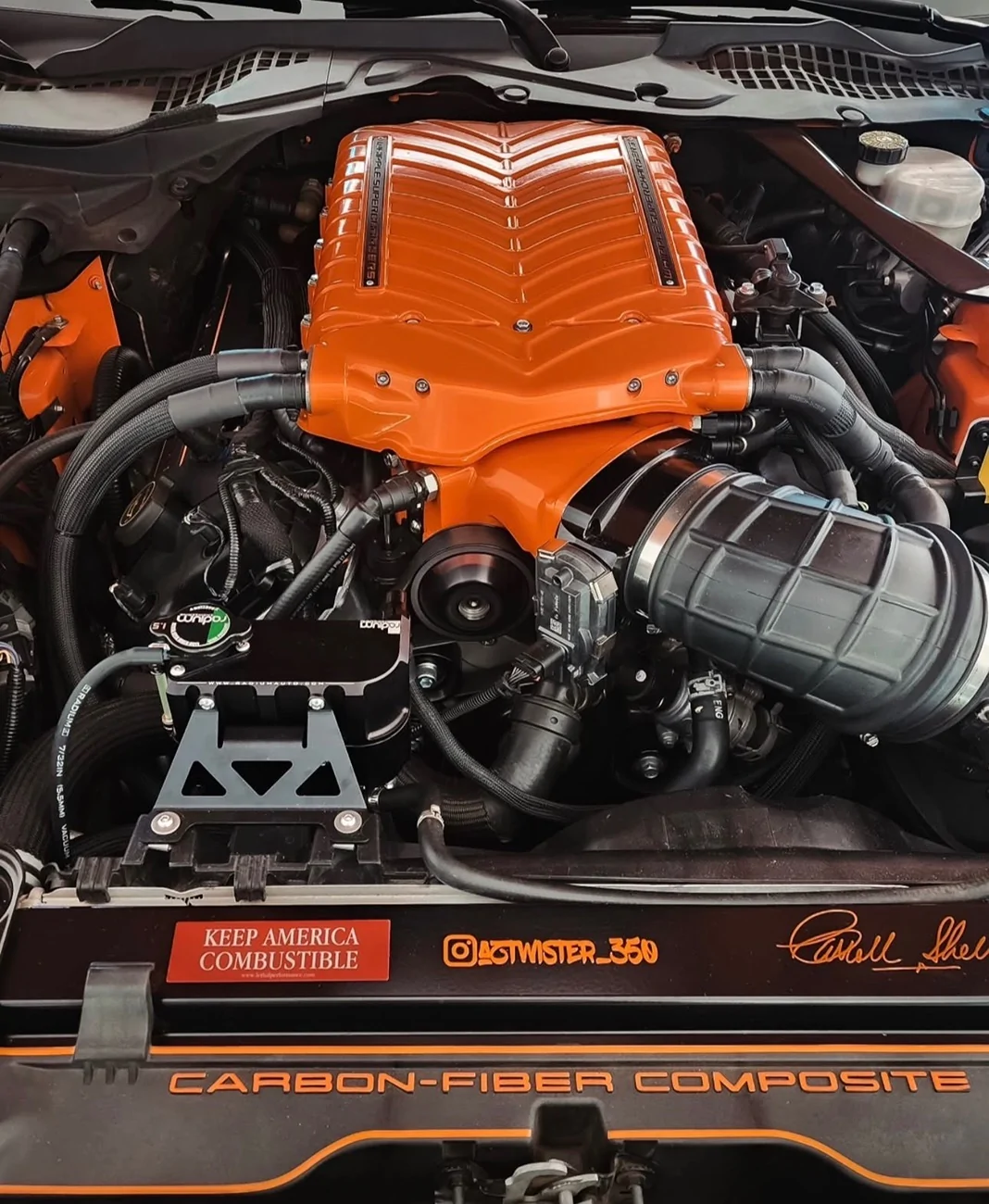

Great! Hope you like it. It took nearly five months to get our Whipple, but we also did the powder coat color.
You should be fine, but anyone reading this with GT350 and Whipple — you will need an L connector on radium for hose behind pully otherwise pully will rub against hose.
The main thing to remember this is not a reservoir tank, it’s essentially a next gen design of the old radiator cap. Fill it to 3/4 after install. It will go to full level and pretty much stay there. Excess coolant will vent off. If it falls below 3/4 when cold, top it off to 3/4.
I like the way it looks and has kept the engine in optimal temp even during a short track run.
if you have any questions about install, reply back to thread.

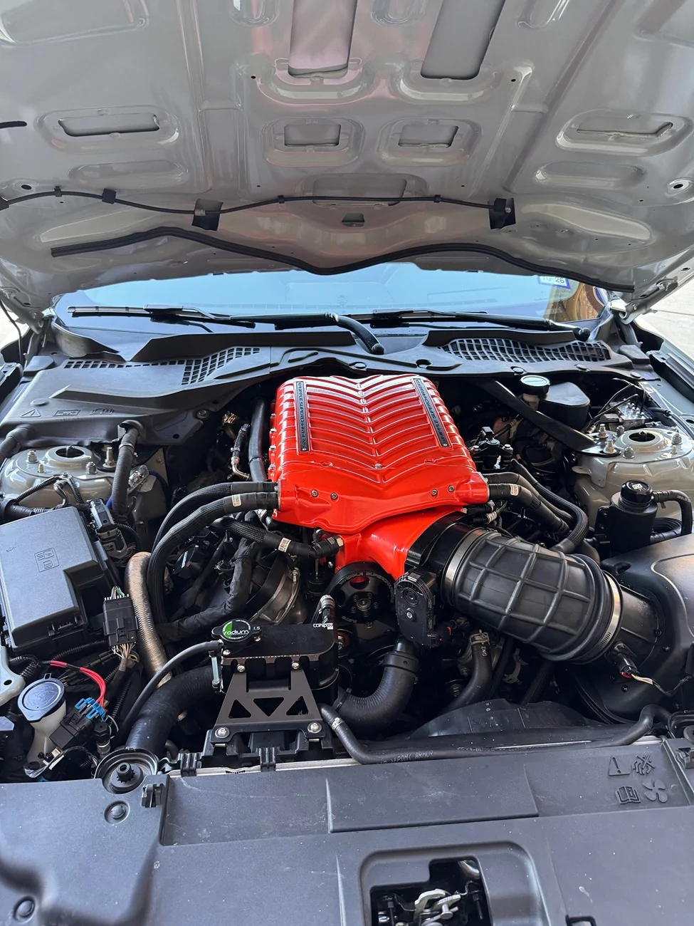

Update, whipple came in! Been running the Radium coolant take ever since and have been super pleased with everything no issues or complaints!
