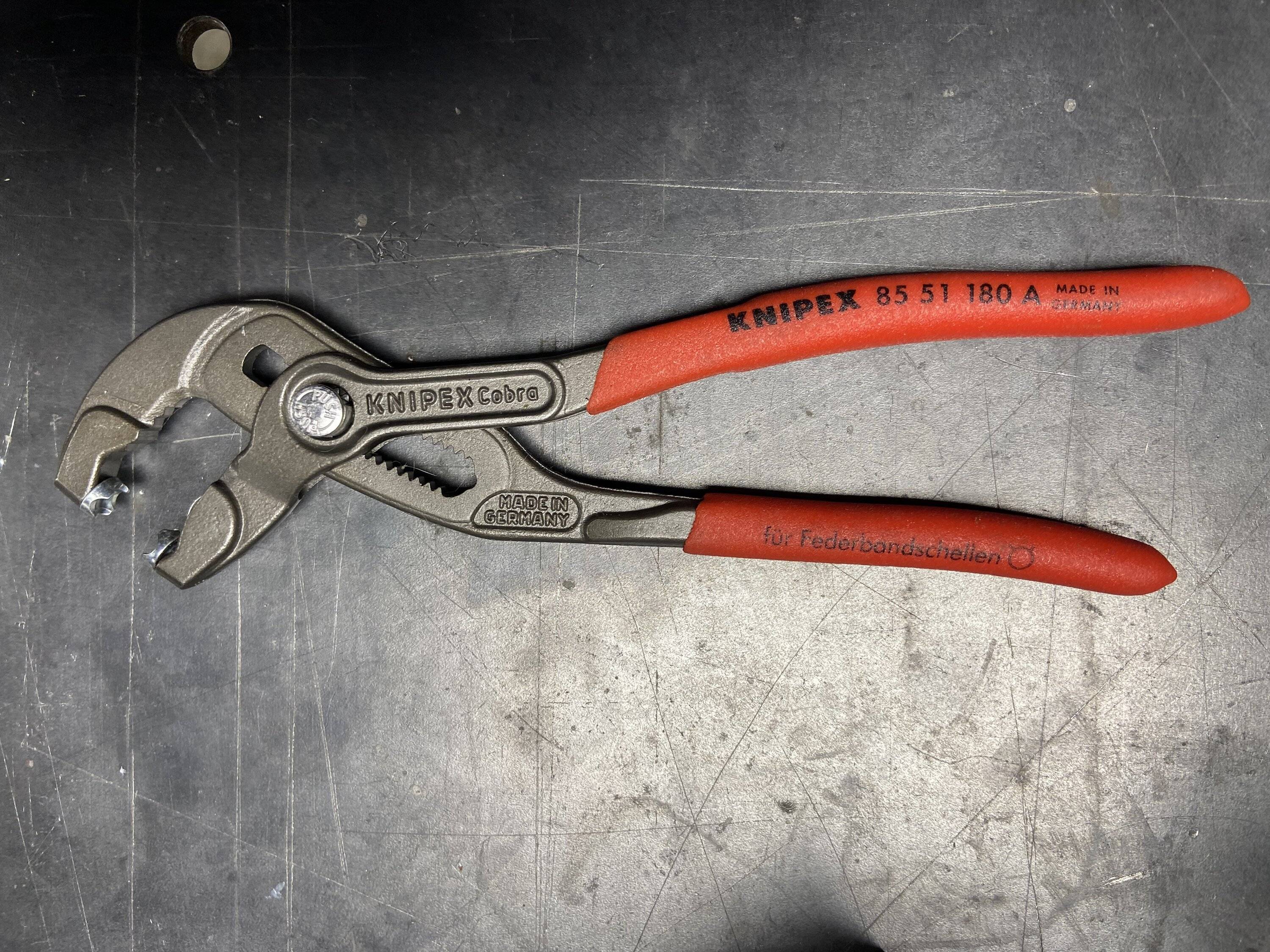

Any thoughts on the steeda model? SHelby American makes one but it's $500 sheessh...

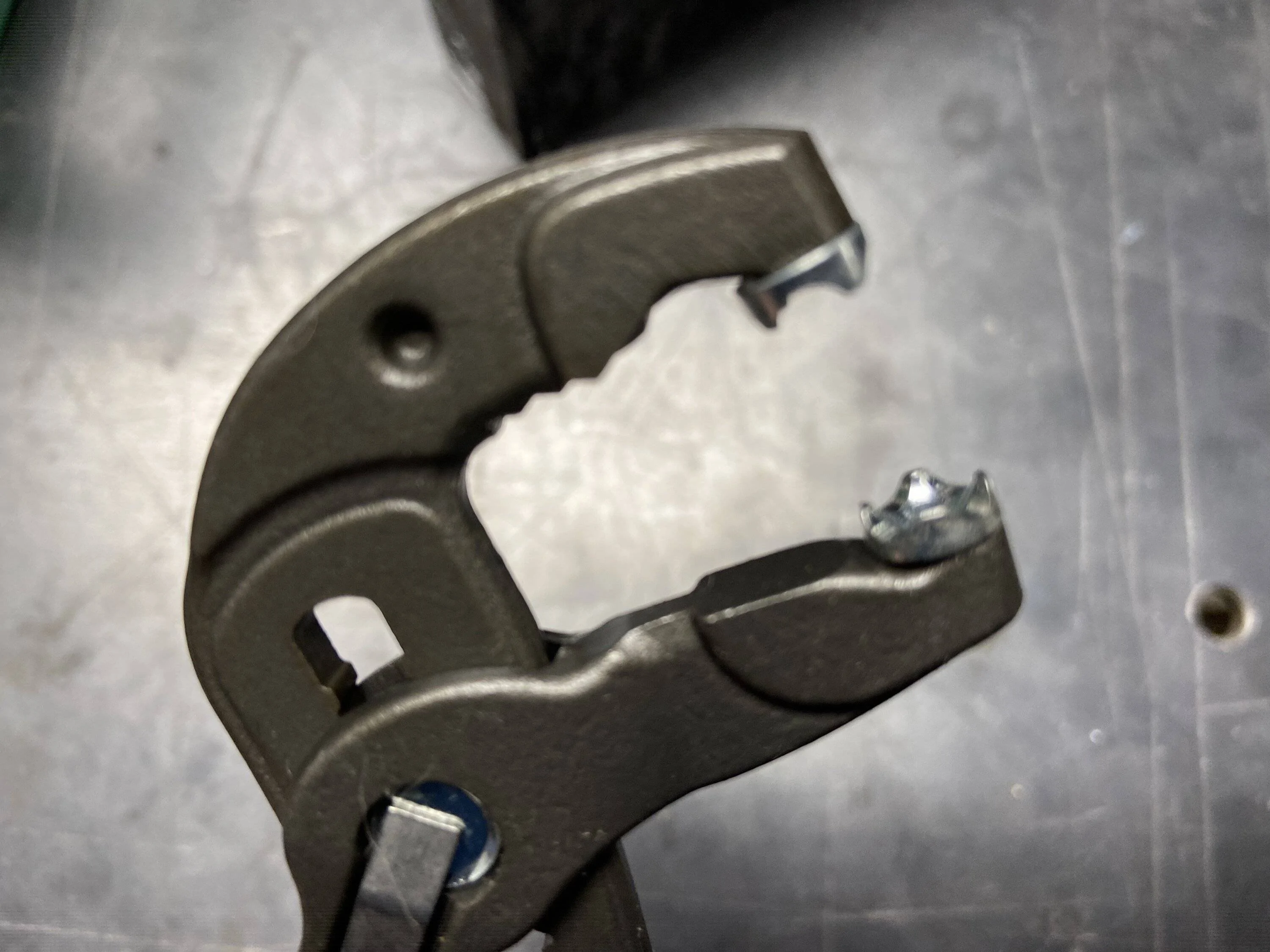

Yes, a great fit, would recommend this tool.
Pricey, worth the cost.
Jaw insert rotate, very handy in a tight space...... esp lower hose.

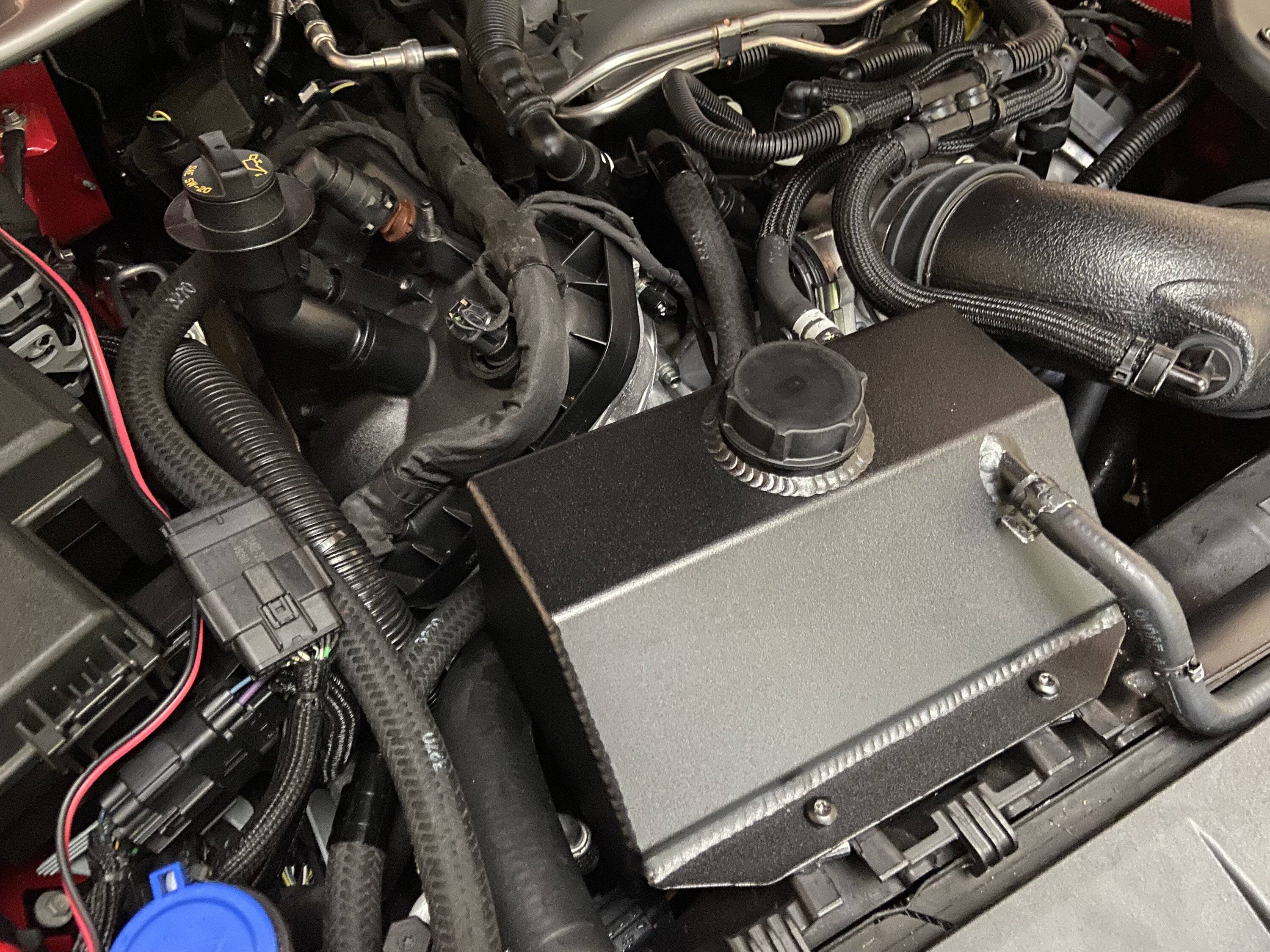

I am running the Radium expansion tank and really like it.
THanks.. I'm just really really leery of the site tubes and the possibility of these breaking or coming loose...

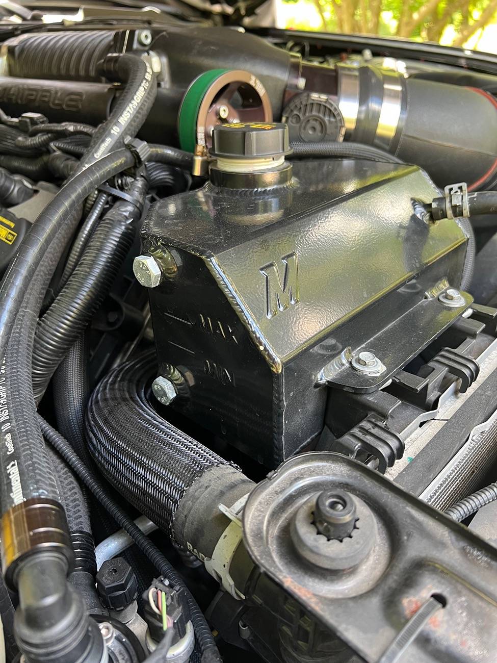

Just wanted to provide another data point, mine blew out the sight glass (plastic) after a few thousand, dropped some fugly bolts in because I was in a rush, haven’t looked back since.

Anyone here upgraded the ugly plastic coolant overflow tank with the Mishimoto. Any issues? I have the Ford Performance oil seperator and i've read posts where they say its a tight fit. Also worried about the little tube on the side breaking loose and losing coolant. Thoughts?
The little tube does break and Mishimoto has no replacement parts. They want proof of purchase for a complete replacement. Total bs as I had mine powder coated. I bought two brass plugs and eliminated the sight gauge. Things might be different now if they've had enough complaints which I'm sure they have.

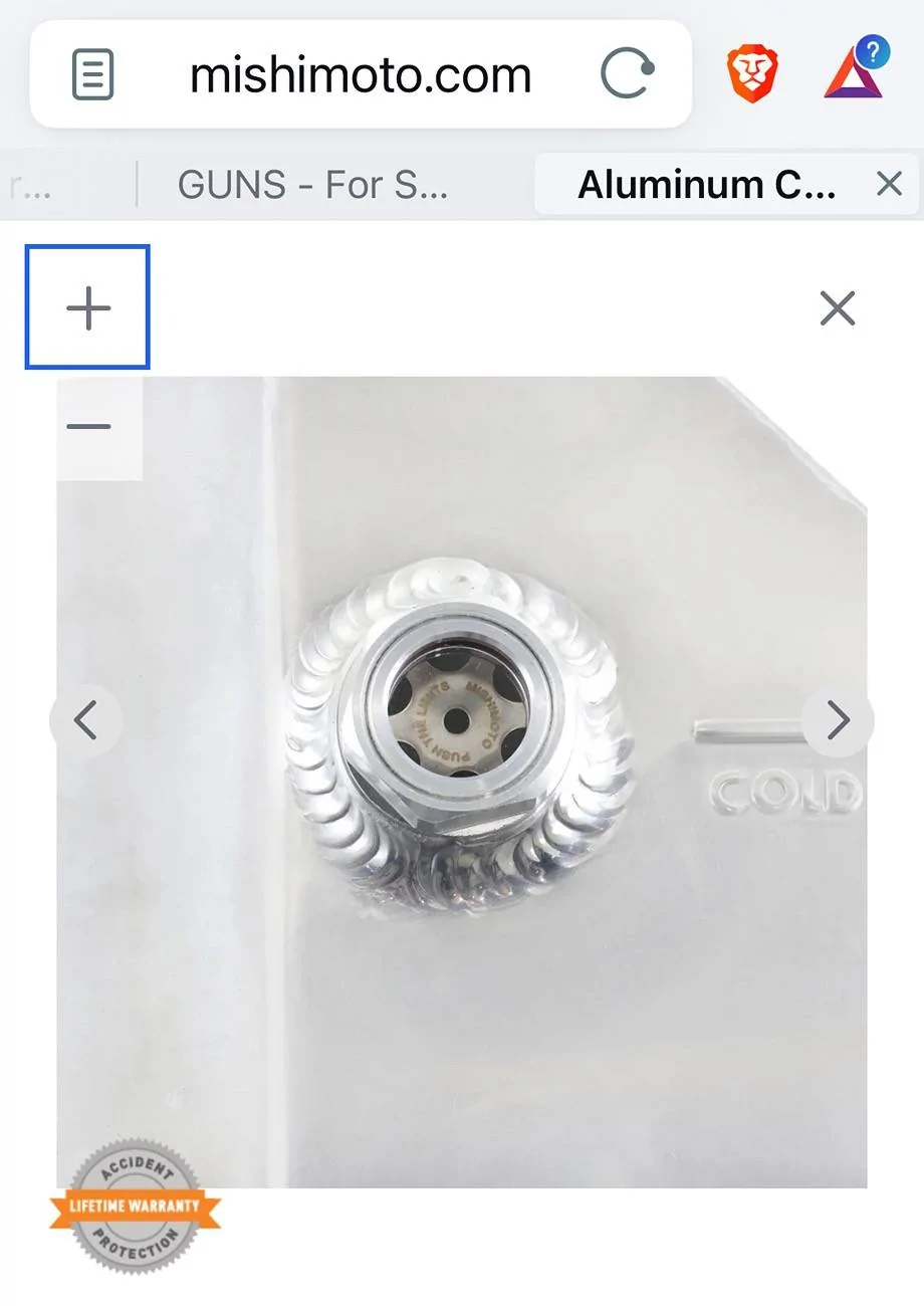

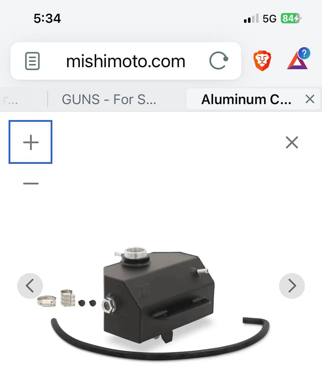

Mishimotos version 2.0 has an inset round sight glass versus the sight tube so you can see the coolant level in the tank. This eliminates the possible tube popping off. Much better design. Tell us you knew you had a problem without telling us you knew you had a problem.

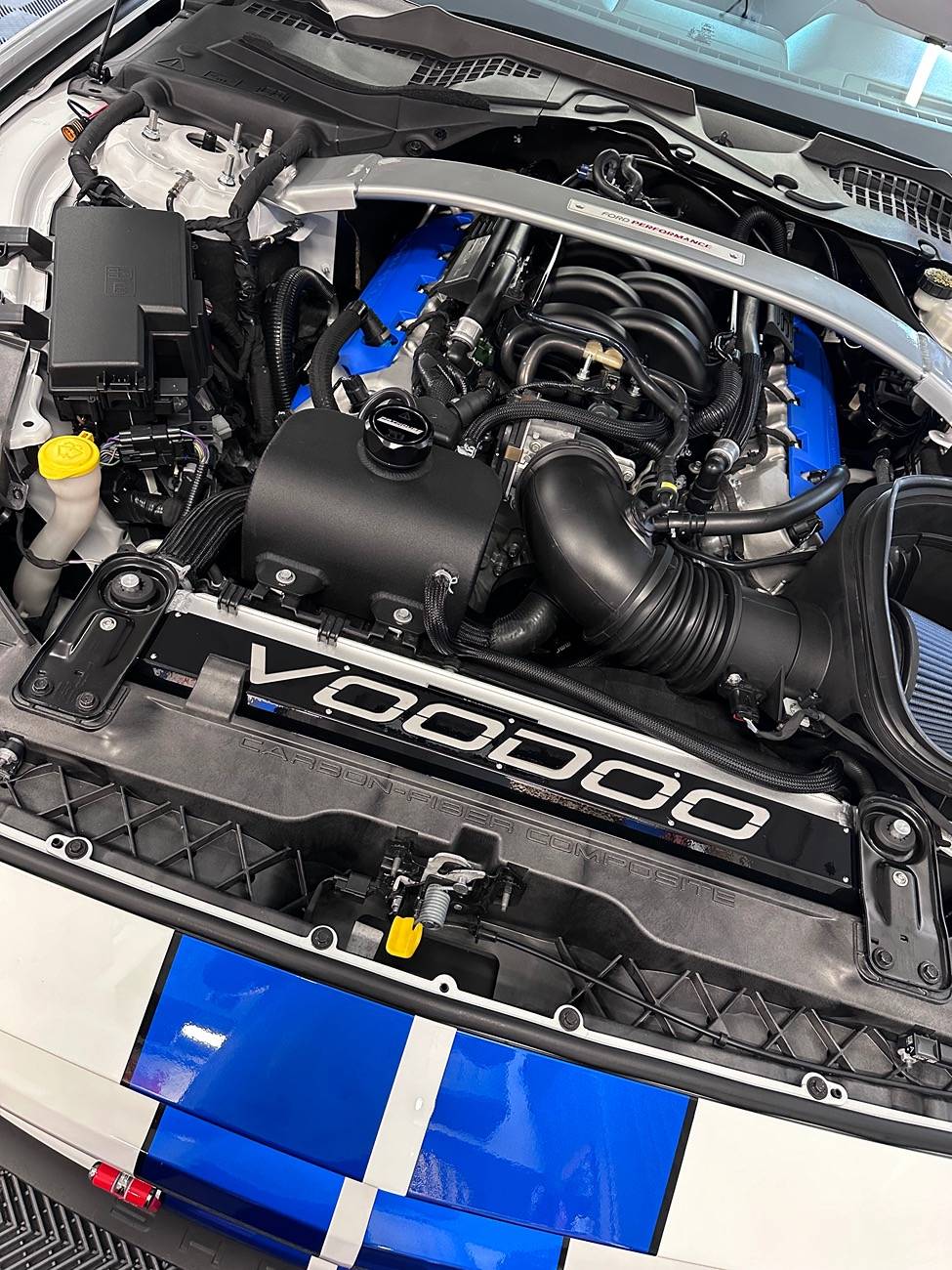

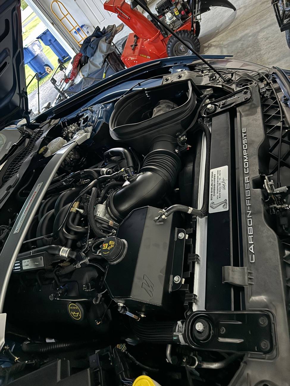

I installed it. I have the JLT catch can and it is a tight fit. So far no issues with the tank. I did the Mishimoto radiator at the same time.

yeah that was just a bad decision from the get go. Left a lot of dead bodies behind for sure...

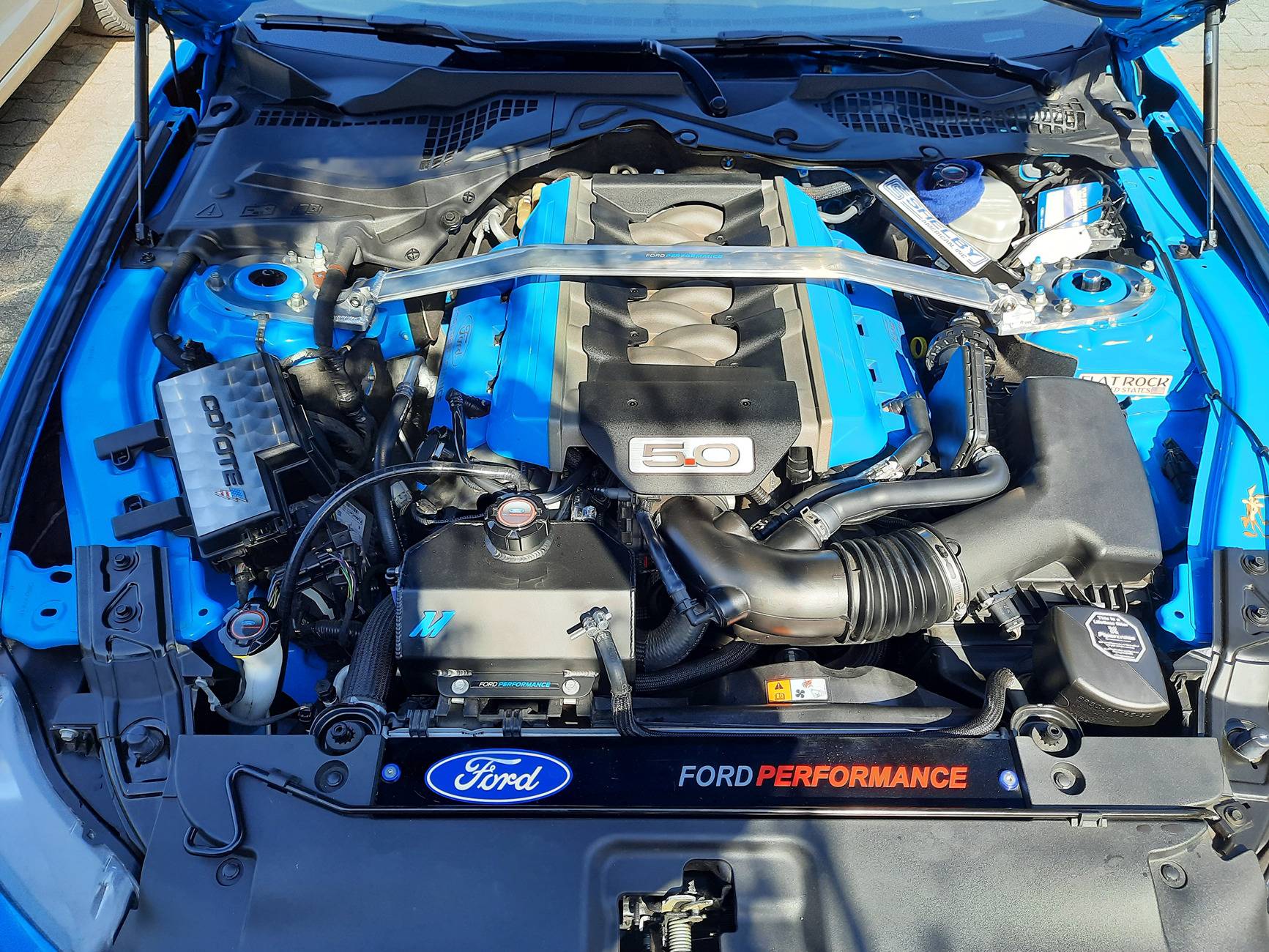

I have Mishimotos version 1 and hope the status indicator stays intact
