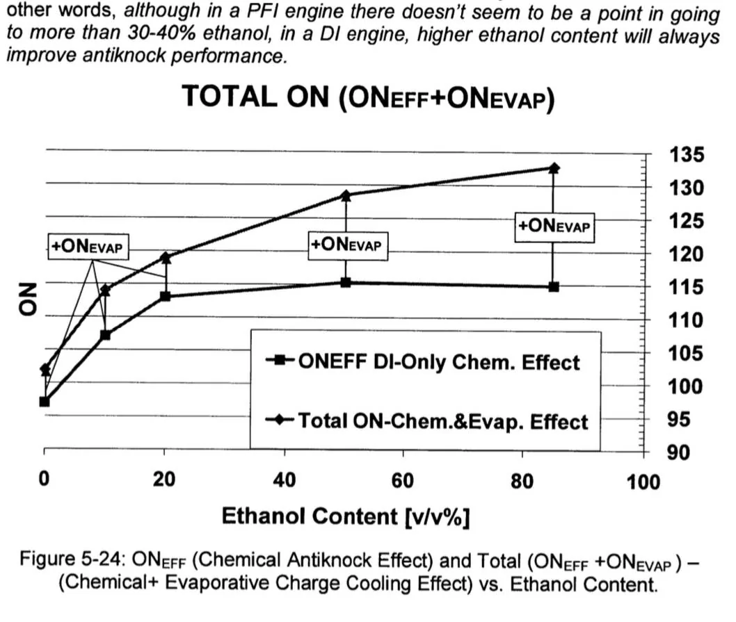

With ethanol, you get huge benefits from the first bit and then diminishing returns, see attached pic. I have mine set to add “all the timing” at anything over about 50% but this could probably be lower. Btw gdi compounds the effects of ethanol.
@robvas the AFR would be 9.8/1 at 85% but 12/1 at e50. You set the AFR in the tune and if it’s not right then fuel trims are off. Or do flex tuning and let it learn the AFR.

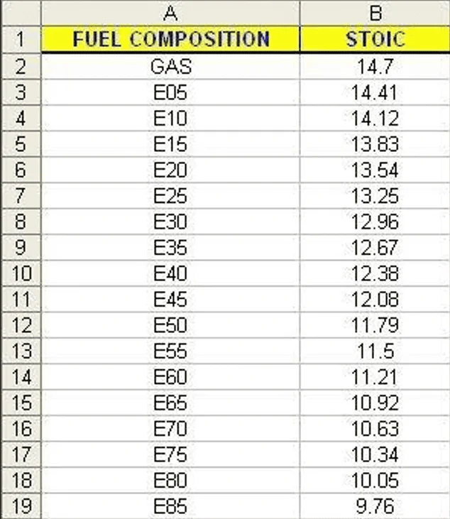

Here's a nice little table I use when tuning at various ethanol levels. I run less timing at 70% ethanol and below. At 75%+ it's all the timing. For example - Boosted application 1000+WHP Stock Gen 3 block.
