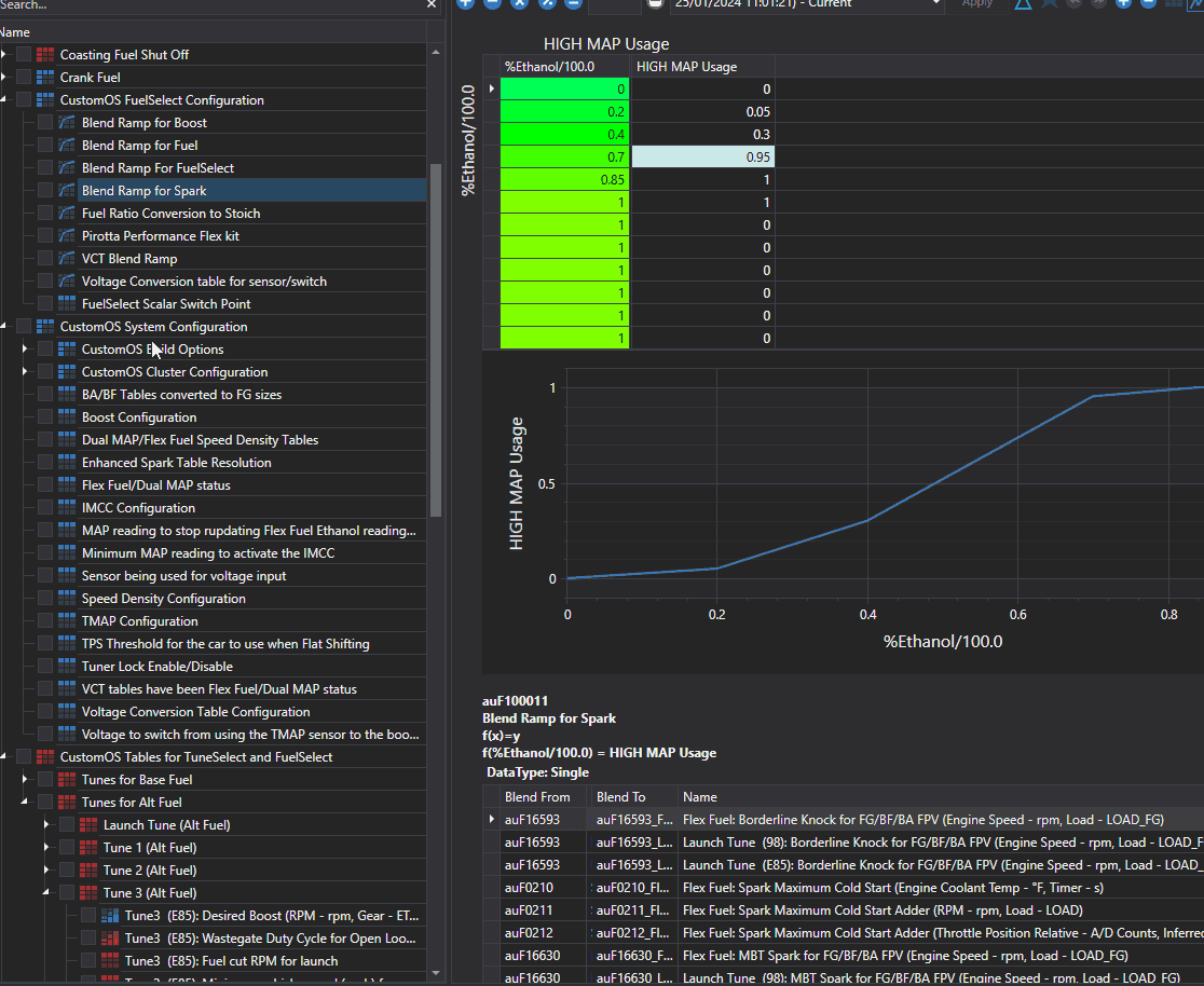

There’s a tuner-defined blend curve. Here’s an example of one I’m going to try out this spring. In this use-case, the left column is E%/100 and right column is the map use ratio.
You can see I have it set to do no table blending at 20% and below. Then it’s 100% on E85 tables at 65% ethanol and up. There’s a separate stoich table that is unaffected by this blend so it’s not like AFR/lambda will be wrong because of this blend curve.

This blend table defines the curve that both sets of tables are interpolated by.
So, if a tuner decided to do a load limit based on ethanol content, the interpolation between those two tables would follow this curve.
Hypothetically: I could set a load limit of 1.6 on my pump gas table and a limit of 2.2 or whatever on the E85 table while running a pulley that makes 2.0 load. Ideally, the upper and lower load limits would be calculated by the tuner to not allow max load until there’s enough ethanol, but that would be simple to figure out.

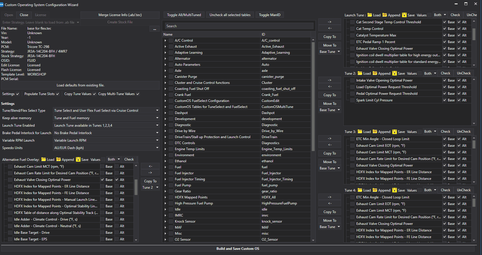

We actually have 4 blend curves under the hood, we can expose them to allow different blend curves for different parameters if people ask for it.
You wouldn't hurt my feelings if you gave us one more blend curve to work with. Do we need it? Probably not, but having the option would be nice. Looking at the OEM F150 logic as a guide, the curves are all over the place. Having a bit more granularity in our control over table blending might not hurt.

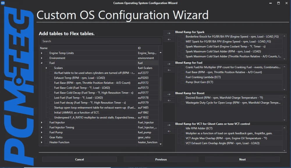

We could have 100s of curves technically, there is no real limitation, the hurdle is making the UI not bloated. Eg you'd need a way to assign which parameter goes to which curve. We did this in the Falcon with a multi screen wizard here:
However this wizard had 6 pages and was quite cumbersome/slow to navigate for tuner pumping out tunes in short time frames.
If you did a wire frame mockup for how we could add which blend curve a parameter is added to, then we could make it happen quite easily. There are already 4 blend curves in the background (3 are just invisible and not used) that we can assign parameters to. If you do this post a thread on our forums and link it here/send it to support, we have a backlog of features however this was always something we planned to add eventually.
The extra curves are great for turbo cars, as often you don't want your spark curve to track your boost curve etc. Same with load limiting, there are many uses as you have alluded to. We named the blend curves in the Falcon, however for the Tricore they would simply be named "Interpolation Curve 1,2,3,4" and everything would go to curve 1 by default.
The backend of the tricore Custom OS is set up so we can do exactly the same thing if there is demand and we can make the UI usable. It is already complex for most users, so if we added this it would need to be something that is hidden by default and you enable via a checkbox etc
Here is how the Falcon CustomOS looks.
You can see which parameters are assigned to which curve via the editor (hidden in the tricore currently via this view) in the Falcon

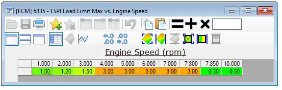

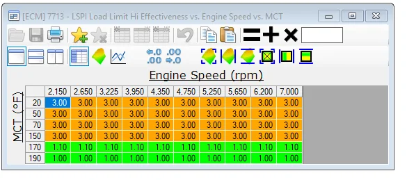

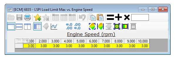

Again, my biggest concern isn't fuel or spark, that's the easy part, it's getting the "map" correct for air loading. It's the ability to run a small pulley on a PD or Centri and choke the tune so that it doesn't make full sauce when on lower content fuel. That's the big risk. I think a flex fuel for anything less than typical 93 limits (say 12 psi) is probably pretty easy. You just adjust fuel and spark and away you go. But for anything that runs higher than sensible boost limits for 93, the risk is making 19 lbs of boost on low E content.
The gen 3 PCM has OEM air load limiters. They aren’t set to do anything from Ford, but they are there. This is one of many.
Whipple uses them to limit boost as MCT temps rise or as ambient temps get too cold. Again, one of many.
I use this one to limit boost at low RPM to keep torque in check and also a soft "rev limiter" that will close the throttle before it hits my programmed rev limiters.
All very easy to set up, and they all work reliably. It would be easy to blend two load limit tables as a function of ethanol with the PCMTEC solution, which is exactly what I plan to do.
