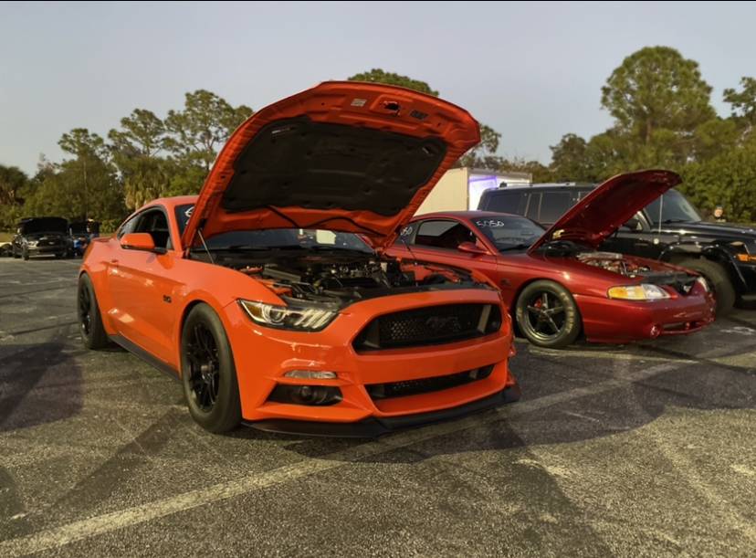

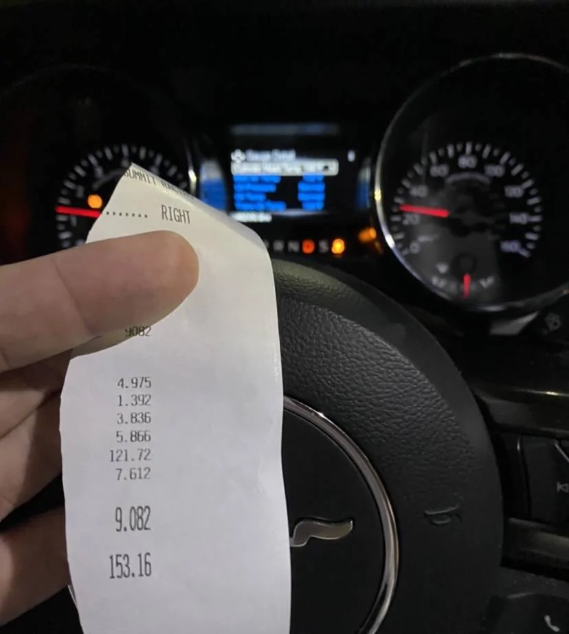

Been a minute but have an update. Went out for the first time this winter to a test and tune night. Got one pass, but that’s all it needed to get a new personal best. Will add a video later on. DA was +300ft. Car is still a…
P1x stock motor car (4.0 upper pulley)
built 6r80 with 2c converter
MSD step/transbrake(new)
Lund racing E85 tune
Gt350 manifold
Full exhaust
Fore innovations fuel system with id1000 and stock rails
Drag brakes
Kmember
F14 drag pack

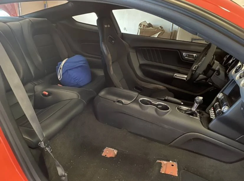

Passenger seat out and fixed driver seat.
Transbrake at 2400rpm only, stock axles, stock front/rear shocks, stock aluminum 3.55 diff, BMR cradle lockout, vertical links, camber arms and Eibach springs only.

Flying! Car is making some steam! Amazing the stock axles are holding up.

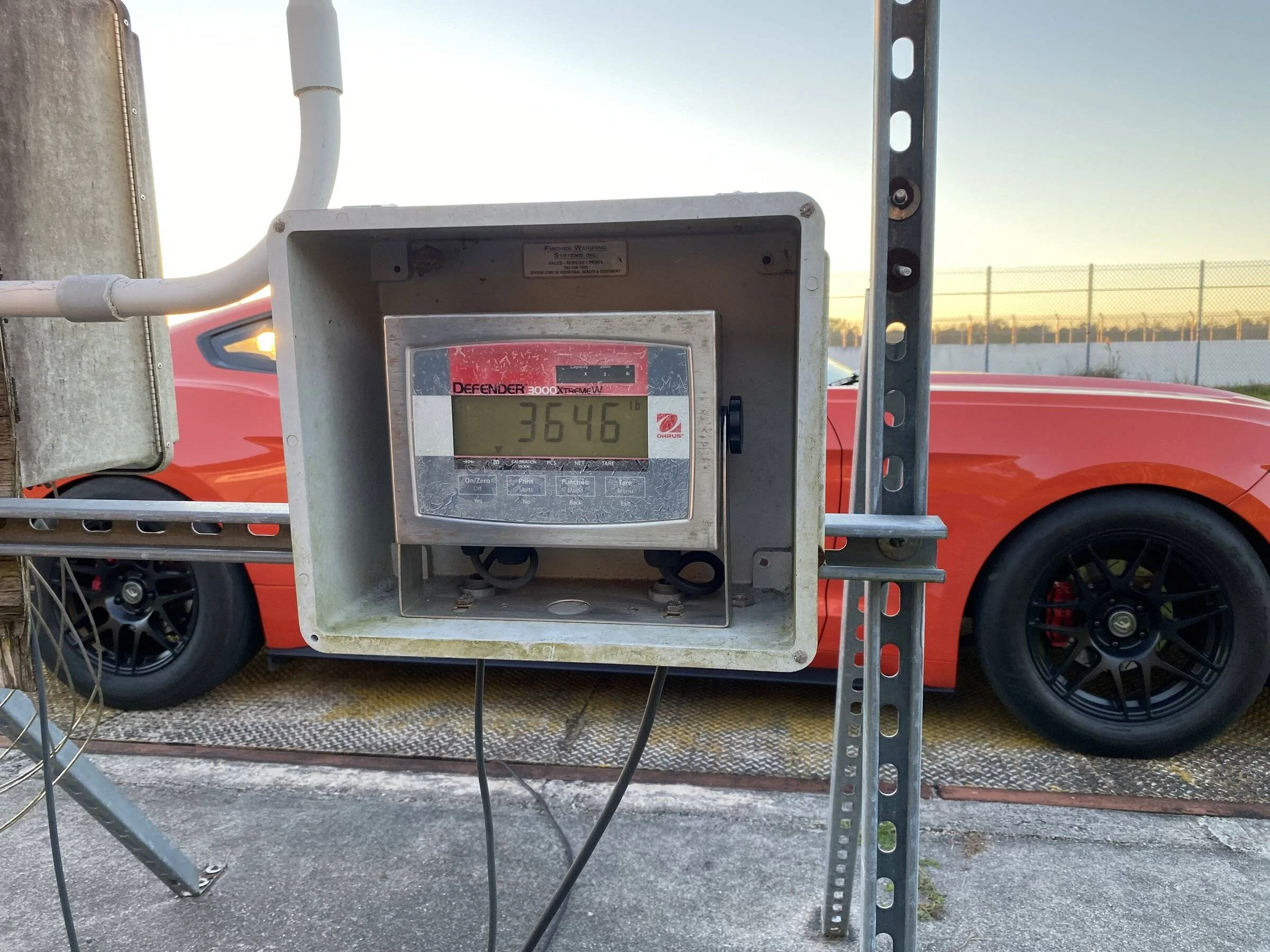

Damn that is moving, almost an 8. What did it weigh in at?

Super impressive. A little more launch rpm would probably get you that 8 second pass, but as I recall you drive it from south Dade to PBIR so I’d be real happy with that!

i think here the spare was in it and it had a little over 1/2 tank

Was going ask what else is missing. Mine weighs a little less and I think I've done just about everything (kmember, brakes, battery, hood liner), but want to keep the full interior. 200 more pounds would be awesome, but promised myself street car.

Still stock battery here, I have used a small one before but becomes annoying. I could remove the back seat and dump the exhaust. Might save another 100lbs probably. Im a heavy guy at 220ish.

I do agree with MKL - raise the launch rpm a smidgeon and drop the 60 even hair and there’s an 8 second pass!

Congrats, I see you in the 8’s soon.
