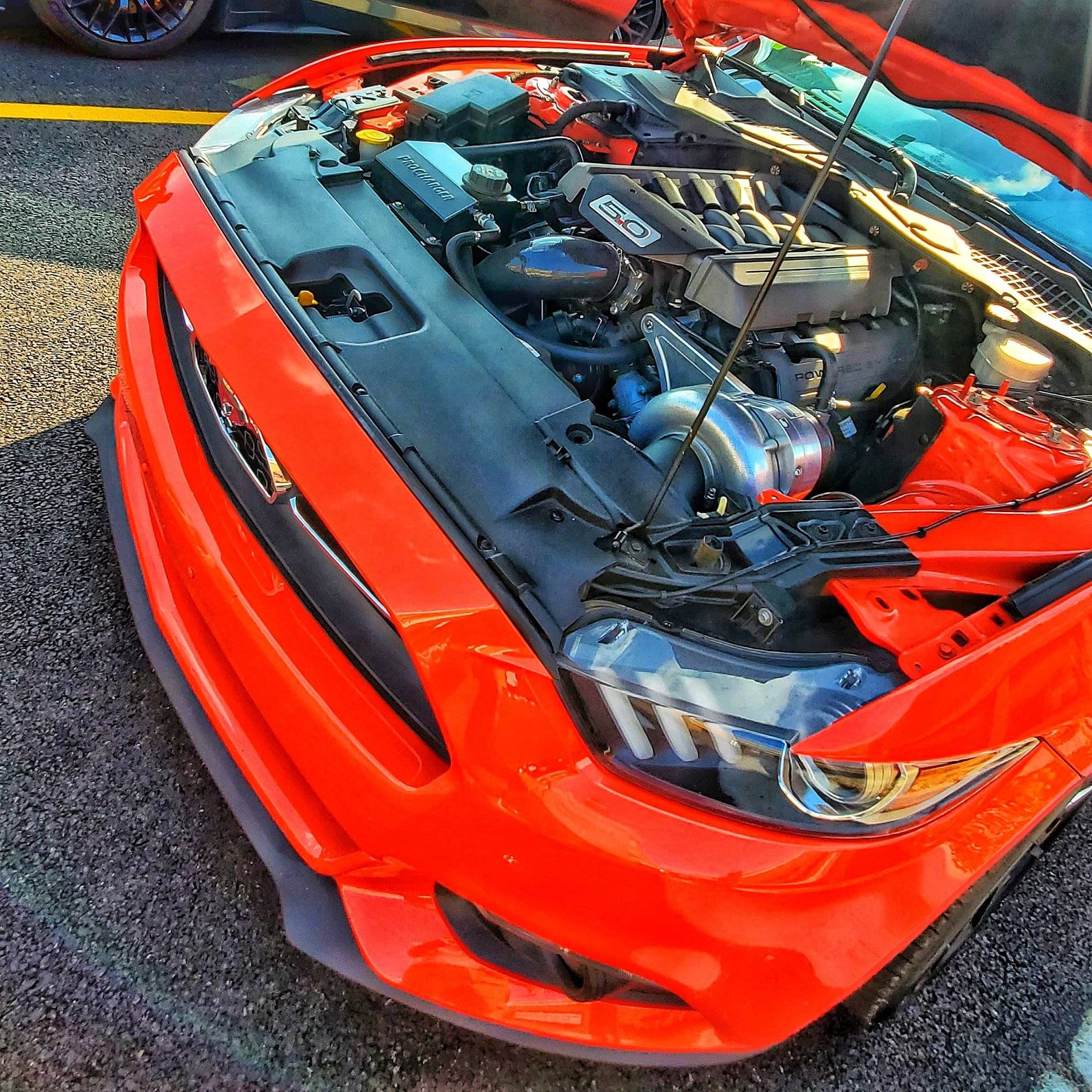

I have a p1x procharger kit with the stage 2 intercooler. My coolant temp never gets over 212 but my cylinder head temps get around 234 in stop and go traffic and 215-220 when doing 80 down the highway on an 80 degree day. I still have the factory procharger tune thru the diablo sport tuner that comes with the kit. I installed a 170 reische thermostat and when I upload the tune it allows me to change the fan temp, which I put to 180, but I am still seeing the same temps. Thoughts? I asked a few Facebook groups and I got answers of thats way to hot and then some people saying it sounds normal. Just looking for other feedback Thanks!
