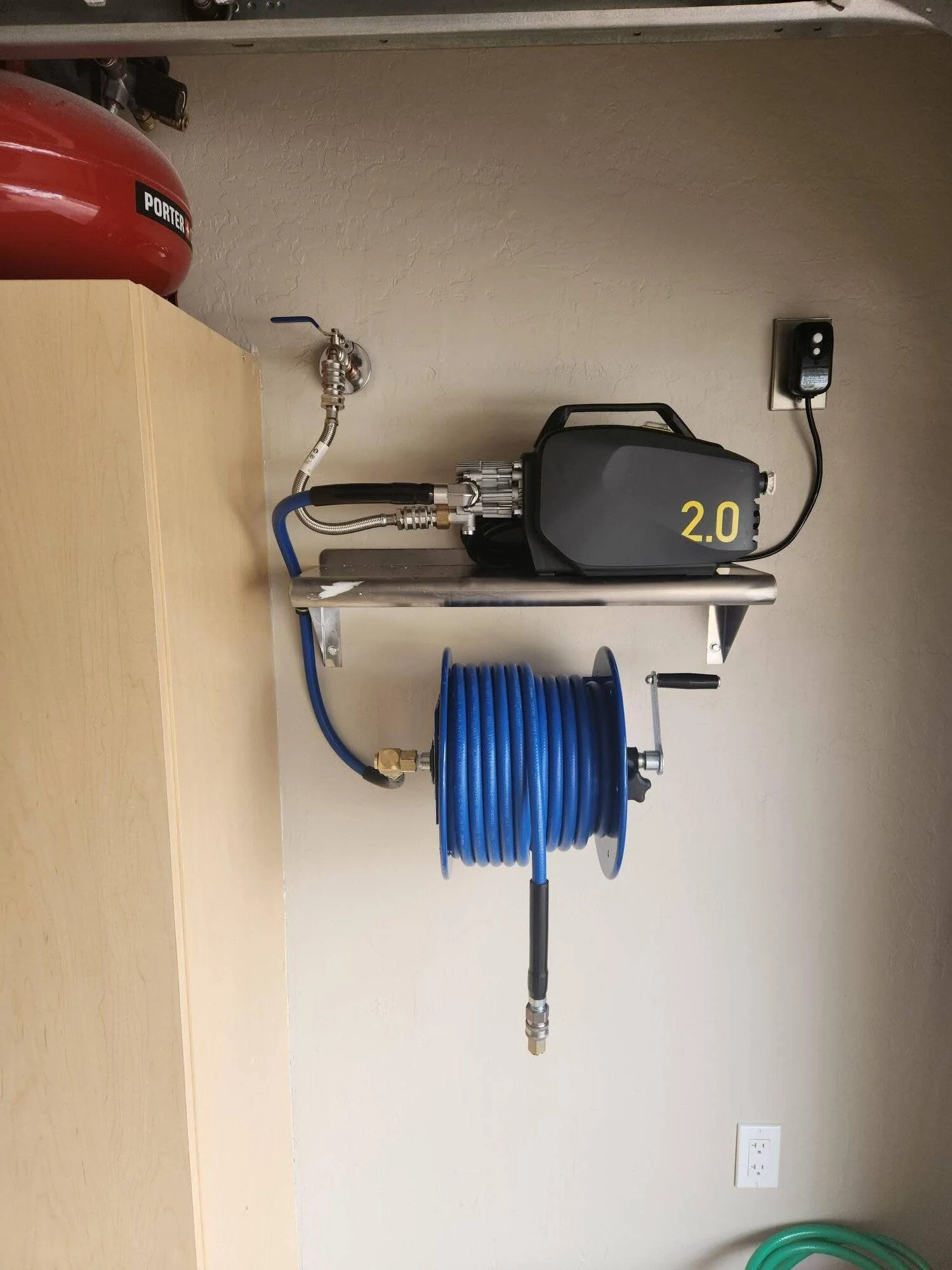

I know I'm late to the party here, but I just finished up my new Active 2.0 setup. Had to get some parts from OG, but mostly from Amazon and the local Home Depot. I can say this setup is a huge improvement over my old Adams power washer. The ease and convenience of a wall mounted system really does make washing the car a better experience.

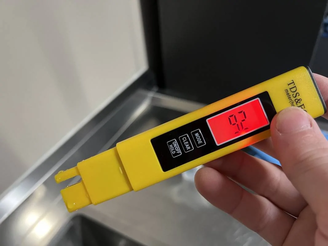

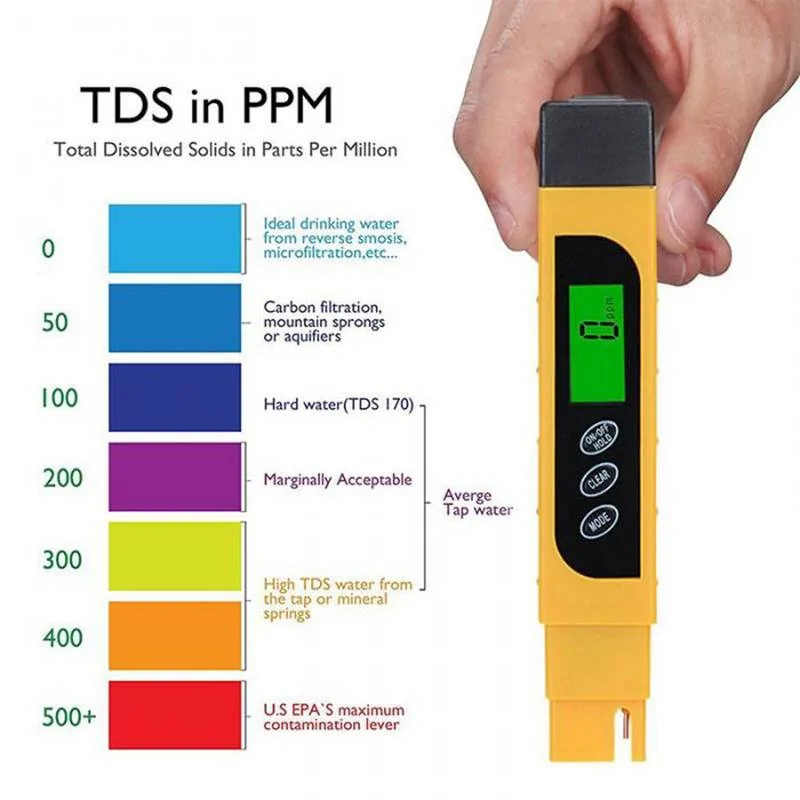

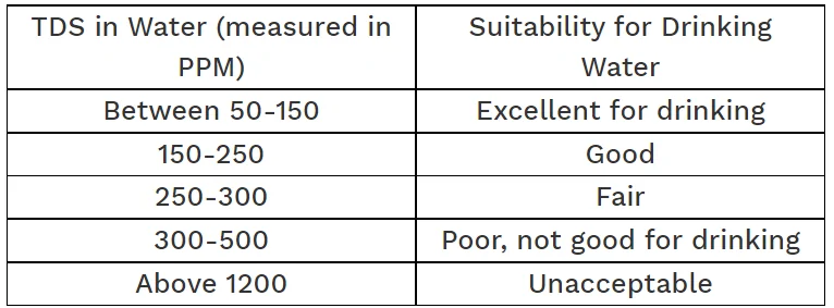

Get yourself a TDS meter from Amazon, very useful to know -
Amazon.com : TDS Meter
I'm very lucky to have good water quality and low TDS where I live, negating the need for a DI system.

NINETY-TWO! D, you have some mighty soft municipal water, assuming that you don't have a a whole house softener or other softening rig. I'm lucky if I can get our water down to 300 with both whole house and a second set of softener carts in the cabinet.

I live in a small to medium sized "rural" town with 3 rivers snaking around the district. We have some of the best water quality in the country apparently.

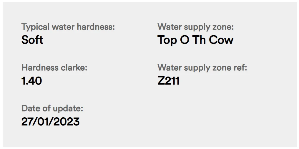

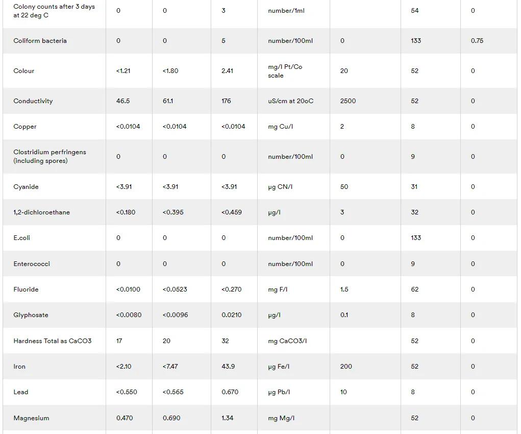

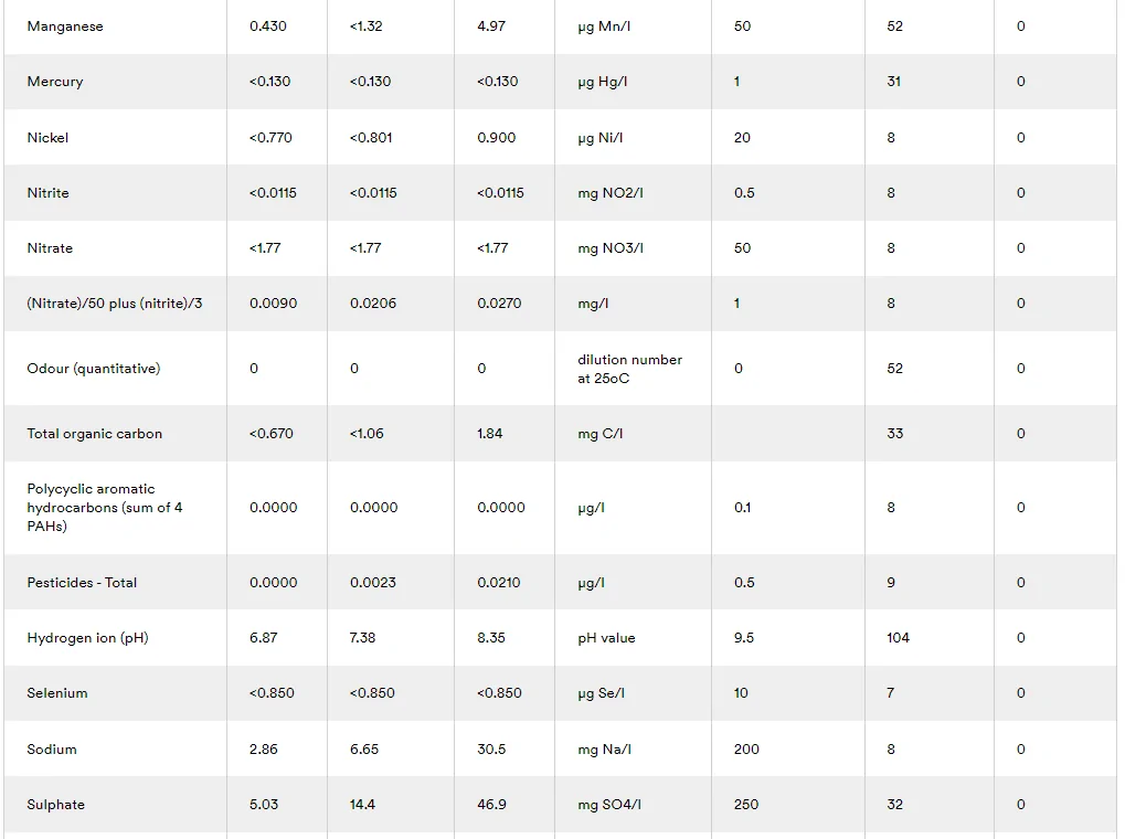

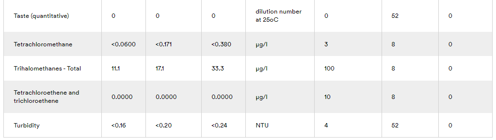

Here is mine from the local water authority :

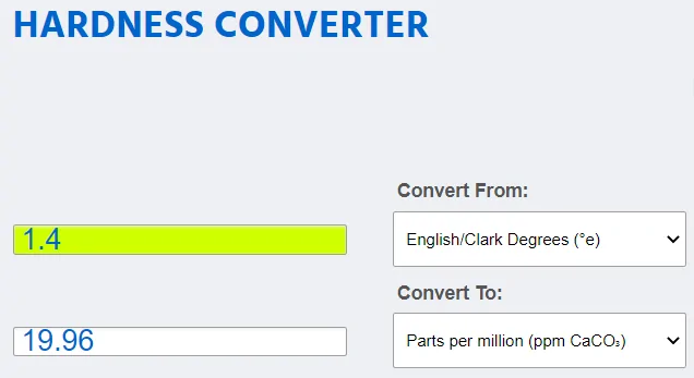

I think the important one is 'Hardness Clarke' which converts to 19.96 TDS :
Have I got this right ? and if so, what do I win ... :giggle:
WD :like:

MOG, WD!!! I am so, so, SO envious of your water and D's! That is simply unbelievable..WOW.
We had an e coli scare quite a few years ago and ever since, the water department has clobbered the water with chemicals but even so, the river water we get is also quite hard.
High TDS water is an insidious enemy aside from the calcium rings around fixtures and of course, car washing, but it can be very hard on essentially any type of plumbing.

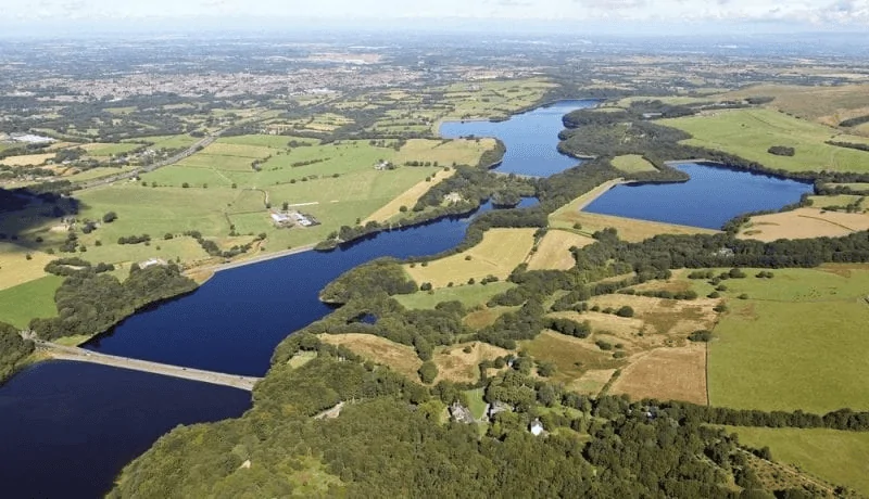

Our water supply mostly comes from here (Thirlmere, 80 miles away in the lake district) :
Supported by some of our local reservoirs (Rivington, 7 miles away) :
I've swam, walked, ran and cycled around most of the places our water comes from, Ironman UK even uses the road that divides the reservoirs in the second photo.
There is a good reason that the UK lead acid battery manufacturing plants were in this area and tapped into that supply :wink:
People haven't believed me when I have said I don't need to dry a car down to prevent water spots, the only need I have to dry a car is if I am going for an ultimate detail or if its a bit breezy and dust is likely to settle in any standing water before it dries.
22 years in this house - still on the original kettle and washing machine with no internal calcium or lime build up etc

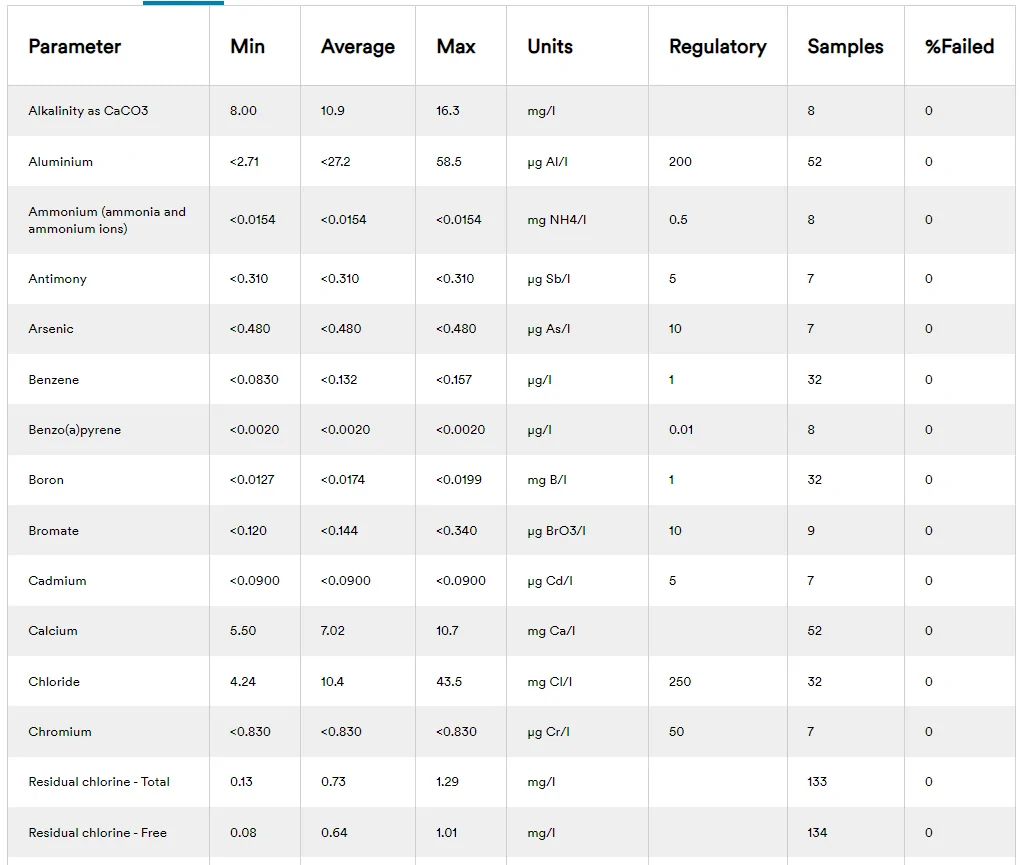

this is my local supply, seems ok but i still can't wash the car properly...........

Chris, This is THE set up i'm planning. Can you please elaborate ? ( I'm more than ok for the Active 2.0) but about intake stainless water hose, hose reel, the hose and also the stainless support?

Here you go. This should be just about everything:
Hose reel:
https://www.amazon.com/dp/B004E3W4QW?ref=ppx_yo2ov_dt_b_product_details&th=1
Shelf:
https://www.amazon.com/dp/B086ZDYG8...pY2tSZWRpcmVjdCZkb05vdExvZ0NsaWNrPXRydWU&th=1
Stainless 90 deg for outlet of Active 2.0 to jumper hose:
https://www.amazon.com/dp/B07DP95QWG?ref=ppx_yo2ov_dt_b_product_details&th=1
75' hose:
https://www.obsessedgarage.com/products/og-hose-upgrade-kit?variant=41382318637207
3' Jumper hose kit with stainless quick connect:
https://www.obsessedgarage.com/coll...ssed-garage-3-8-high-pressure-jumper-hose-kit
Stainless garden hose quick connects:
https://www.amazon.com/MTM-Hydro-St...&sprefix=stainless+garden+hose,aps,221&sr=8-6
Stainless appliance inlet hose (from hose valve to inlet of pressure washer):
https://www.homedepot.com/p/CERTIFI...ess-Steel-Water-Inlet-Hose-WI12SSFM/309398128
Mosmatic swiveling gun:
https://www.obsessedgarage.com/coll...with-quick-disconnects?variant=39171164340375
4.5 opening nozzle kit:
https://www.obsessedgarage.com/coll...tainless-nozzle-4-pack?variant=15889140351048
MTM foam cannon:
https://www.amazon.com/Veloci-Hydro...mzn1.fos.006c50ae-5d4c-4777-9bc0-4513d670b6bc
You can also just order the Obsessed Garage kit if you don't want to source individually. I did it piecemeal because I already had the pressure washer, foam cannon, gun, etc. I ran a dedicated 20 amp circuit, but the active will work on a standard 15 amp outlet too. I ran my plumbing inside the wall, then put 2x6's in between the studs so I had something solid to drill into to mount the hose reel and shelf after I replaced the drywall. Not the easiest of projects, but well worth the effort.
