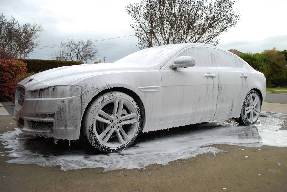

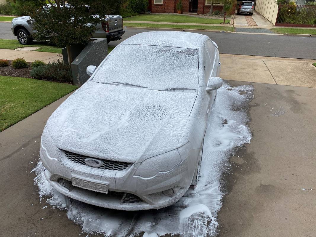

Avoid gas pressure washers for cars, far too powerful for the job in question.
You are correct in thinking flow before pressure. However, its the opposite with foaming where pressure is what creates great foam.

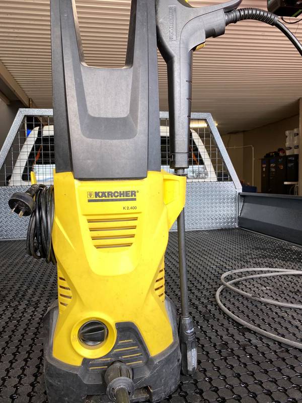

For reference, my first pressure washer was a lowly Karcher K2, and that produced fantastic foam with a basic foam cannon.
The limitations with that machine showed when it came time for the rinse off, the lack of flow really made things slow, probably even slower than just using a garden hose.
If you are serious about using a pressure washer for cleaning cars, at the same time as keeping the cost down, go straight past the big-box-store machines and look at either of the Actives. Both versions were designed primarily for car washing in mind, so they have the flow to go with the pressure. They were also spec'd with aftermarket upgrades in mind rather than having those goofy proprietary connections that need adaptors to make function well.

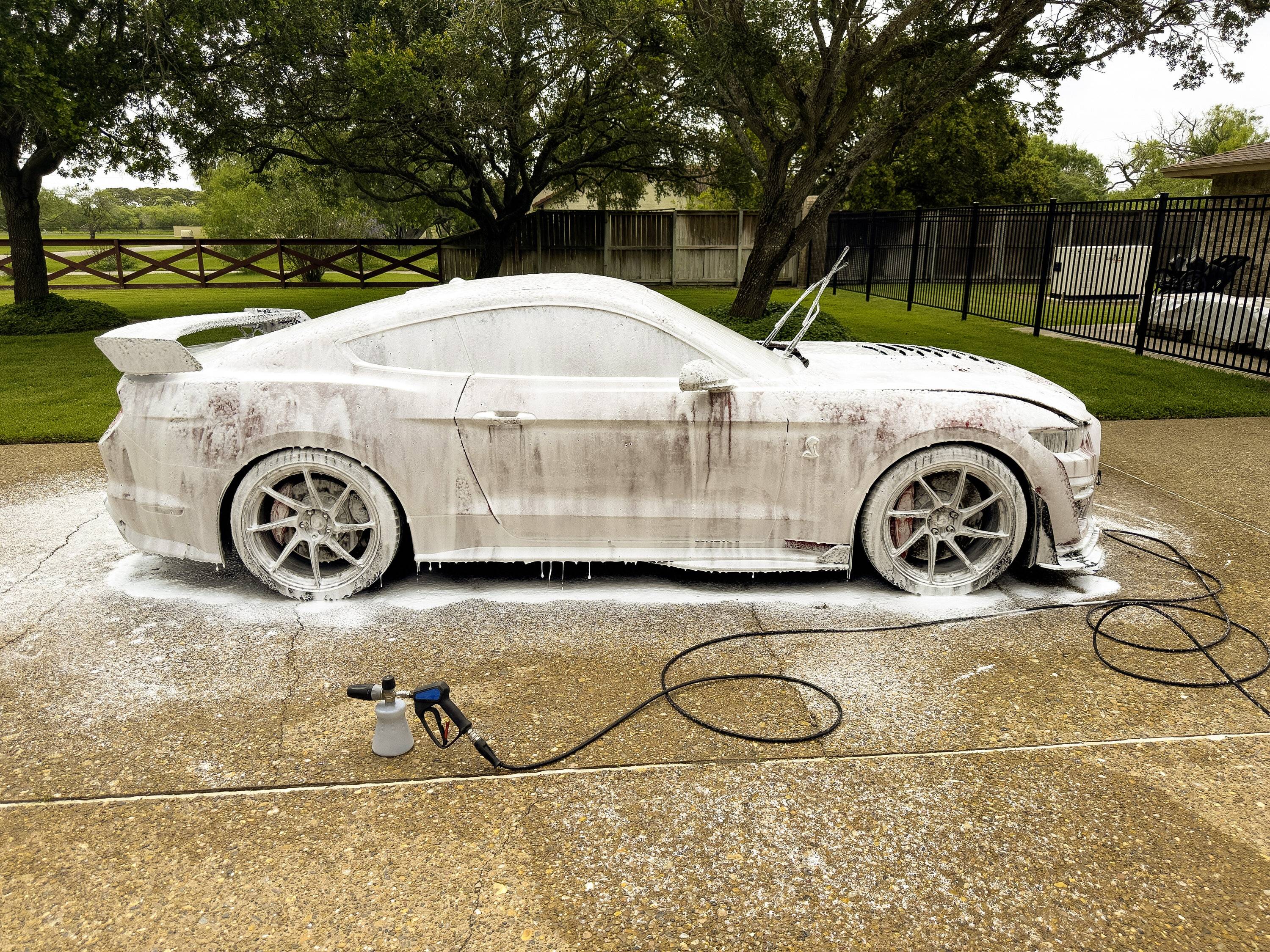

Yep, hard water is the enemy of good foam. We too have hard municipal water but the house is on a softener which brings the mineral level way down and generates excellent foam.
As for the pressure washer itself, I went through THREE inexpensive units (from the CCP,) and none of them lasted more than a year with weekly use.
I gave up, spent the bux, and got a Kranzle 1122TST which puts out 1400psi at 2.1gpm. There is just no comparison between the cheap PW's and the Kranzle in every respect and I expect it to outlast me. Highly-recommended.
I also use a CR Spotless DIC-20 which is a cart with two Big Blue canisters that contain resin making it an additional softener for rinsing. This drops my hardness by another 300ppm.
