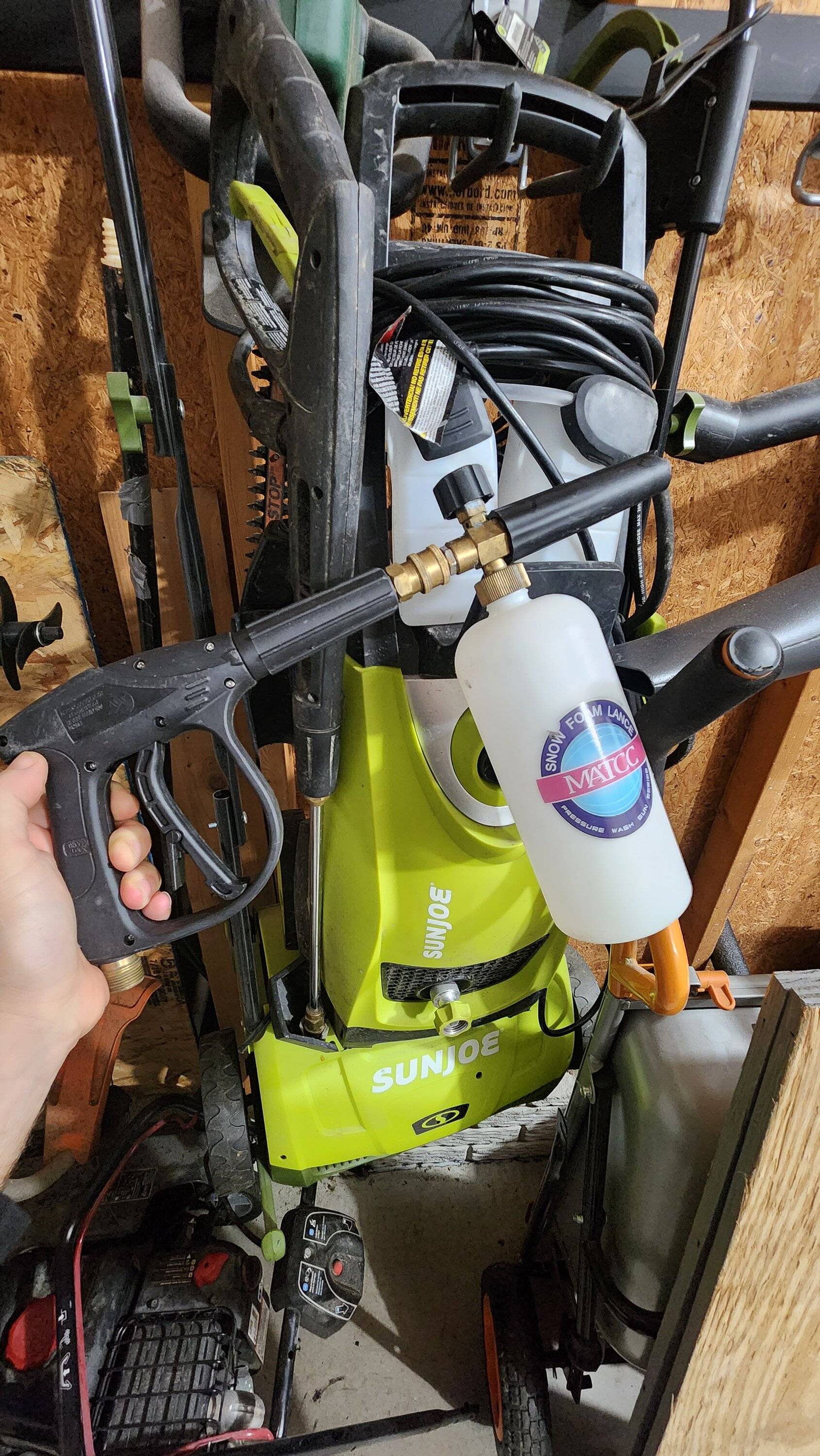

We got a sunjoe electric version. Came with all the foam cannon accessories. Got it on a Black Friday sale for about 80 bucks. Has been perfect for the job.

I also use a sun joe spx3000, I've put it through hell and back, it's more of a "power washer" but it just keeps going. Got a smaller "gun" on amazon as well and a foam cannon and just swap it out if im washing the cars.
Also get soap that will suds up in a foam cannon, some do not.

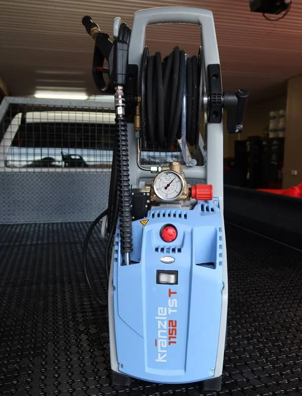

In my experience, the chinese pressure washers will do the job but just barely. They also fail predictably so I quit wasting money and picked up a Kranzle 1122TST. What a HUGE difference from the el cheapo versions!
Yep, it's not cheap and perhaps not for everyone but, if you're ultra obsessive about car washing, this is the way to go.

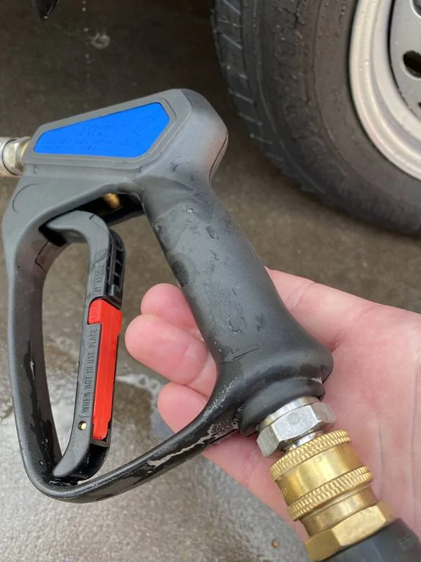

For a long time, I always preferred using a hose mainly because the hassle and annoyance of setting up and using a pressure washer. The majority of pressure washers on the market come with short, crappy hoses and a gun that is unsuited to car cleaning. Combine a crappy hose, crappy gun and crappy OE fittings, using a pressure washer was just a chore.

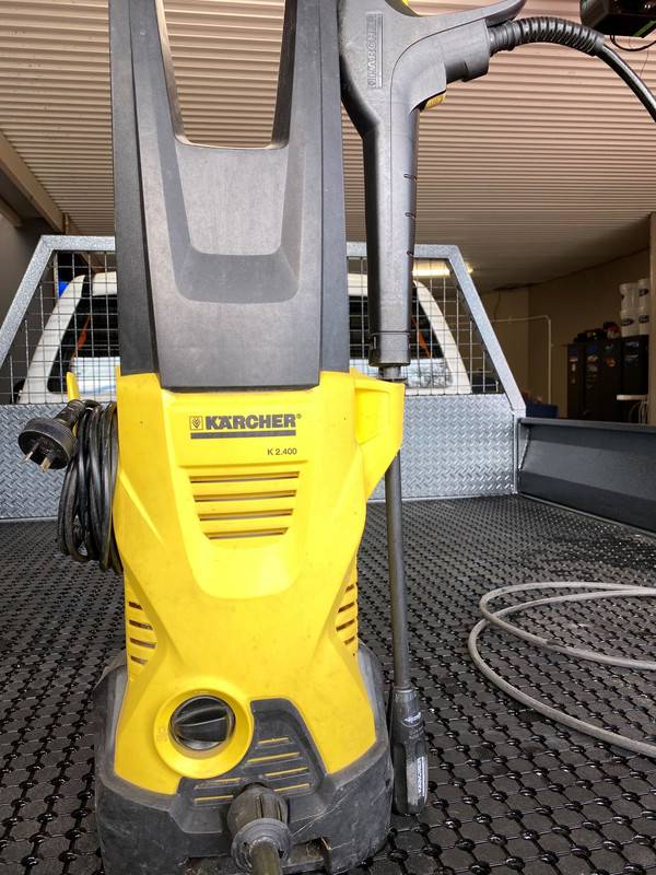

My main requirement when replacing my old Karcher K2 was to be able to upgrade key components so I could tailor the machine to car cleaning. During this process, I learnt a lot about pressure washers, pressure washer accessories and how they all play together to make a machine tailored to car washing. I ultimately went for a Kranzle, and it's pretty bloody awesome, but also very expensive.
Kranzle K1122TST Pressure Washer | Obsessed Garage
For context, I use this machine a lot, I wanted something that was going to be a pleasure to use, serviceable and offer the ability to customize my attachments. I realize this is a very expensive machine, but the use it gets justifies the additional cost.

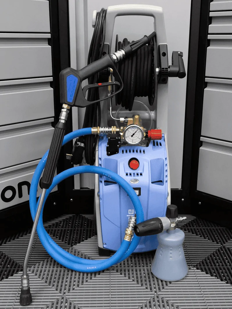

As mentioned, the hoses supplied with pressure washers are generally always far too short for efficient car washing and will necessitate moving the pressure washer around, probably getting tangled with the garden hose and power cord in the process. And the standard guns are too long. Changing these two components will transform a pressure washer user experience, making the process quicker and more enjoyable. This is where adding specific upgraded hoses and guns comes into the equation, and why you should consider the units posted above, as they allow this to be possible.
Linking you to Obsessed Garage, they offer everything you need to upgrade the hose and gun in 3 different tiers. Have a browse through their solutions for each unit, making it easy to just buy everything you need to get up and going.
Solutions – Obsessed Garage

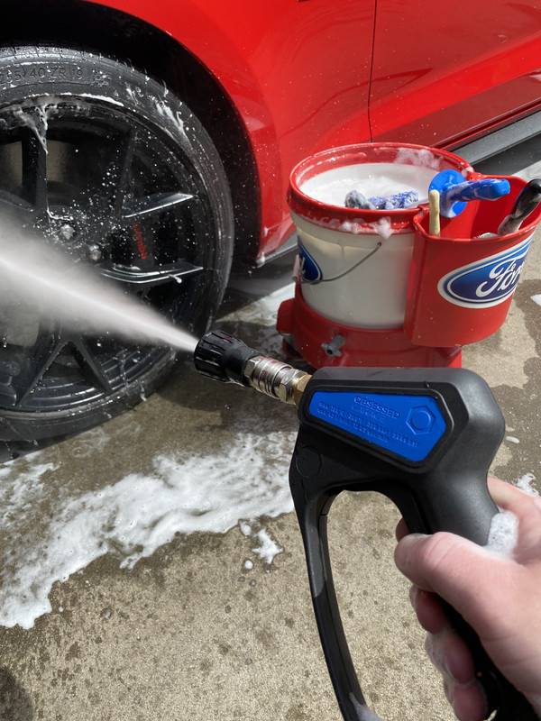

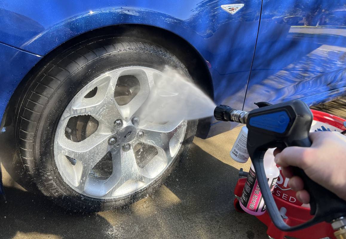

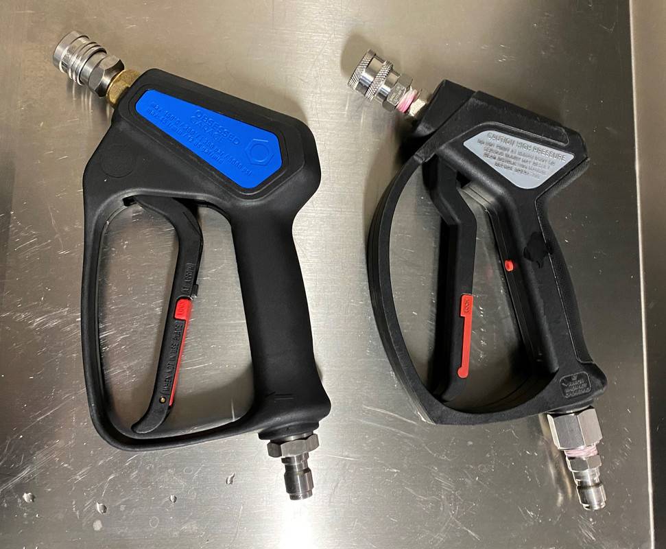

The key thing you want is a gun, I run both the MTM SGS 28 and Mosmatic OG Spec. This makes it easier to attach and disconnect a foam cannon without goofy proprietary fittings. These also swivel so the hose doesn't bind up. -
In short gun format, this makes wheel cleaning much easier.

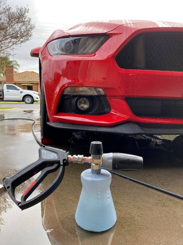

Your foam cannon then connects to the short gun -

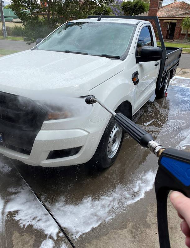

Optional, you can also add a wand for easier rinsing -
The above can usually be adapted to standard pressure washer hoses, although hose upgrades are very much worthwhile -
Pressure Washer Hose | KobraJet 3/8 Inch | Obsessed Garage Store
Gray KobraJet 3/8" Pressure Washer Hose – Obsessed Garage
High Pressure Hose | Pressure Washing Hose | Obsessed Garage
Adding all this to a cheap pressure washer might sound like madness, but these items can be transferred over to newer machines when required. As mentioned, most of the above is linked to Obsessed Garage, but they can be had elsewhere too.
