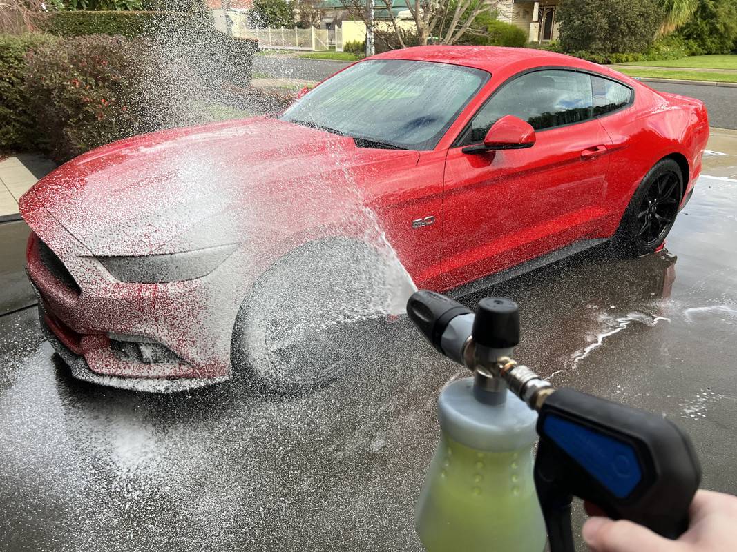

For me, one full bottle will foam two cars.
If the bottle is empty, I drop the head into my rinse bucket and it sits on the grit guard until I give it a shake, dry it off and then store it when I'm putting my stuff away.
If the bottle is half full I store the bottle 'as is' with the head on it until text time I need it - but I tip it forward as I'm walking to the garage to empty what's in the gun (only so it doesn't drip on the garage floor lol).
My foam gun is 12 years old and I have never had an issue with it bar one, when I stripped it, couldn't find anything up with it, ultrasonically cleaned the gauze (nothing came out), put it back together, and then over two washes it came back to life - I can't explain it, maybe an air lock or something ?
I also store pre mixed solution in the bottles with no issues. I have two bottles to minimise how often I need to get the neat solution bottle out to mix it. I use a funnel and a tape line on my bottle so I don't have to wash my funnel and measure the concentration each time I wash a car.
Having said all the above, you guys now know how good my water is so that may be a factor in the long life / lack of cleaning of my gun / storage of my solution etc.
My bottle only has a small hole, but it's no problem with my hot water bucket filler (a gutted hose end that just gives a straight splash free flow) :
Everything I try to do with my car wash procedure is designed to do it properly (as a priority), but also as quickly and easily as possible (second priority, but still very important when you have a family). Five mins saved on the outdoor hot water bucket filler, five mins saved by not mixing chemicals every time, five mins saved by not cleaning my gun every time etc etc all add up :like:

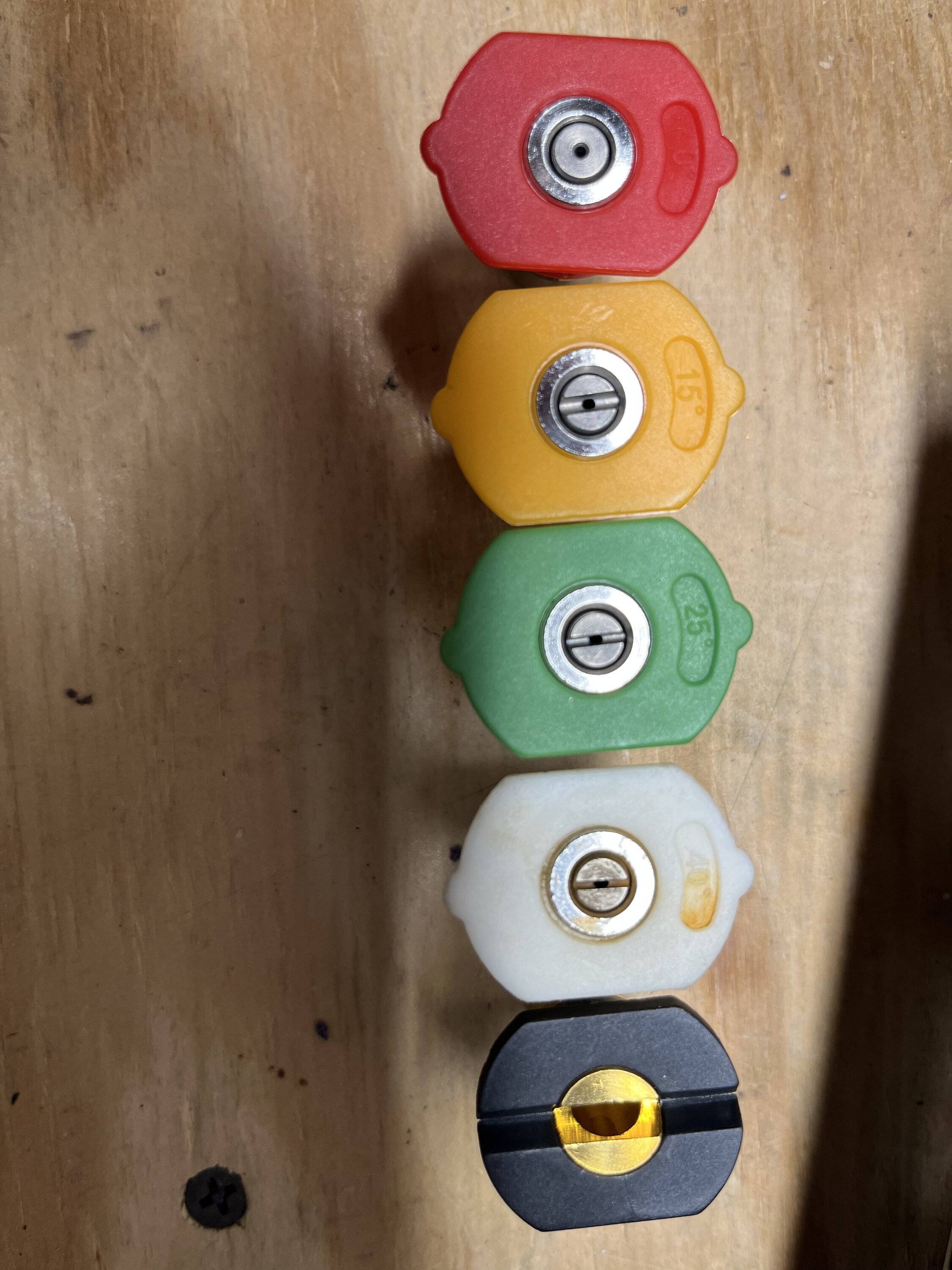

The attachments are spray nozzles that control the spray pattern and pressure of the water coming out. They should have a degree listed on the ends. 40 degree is pretty typical for car washing and more than enough pressure. You can use 25 degree but do not go more aggressive than that. You will damage the paint. I’ll try to snap a pic of mine so you can see where it’s marked

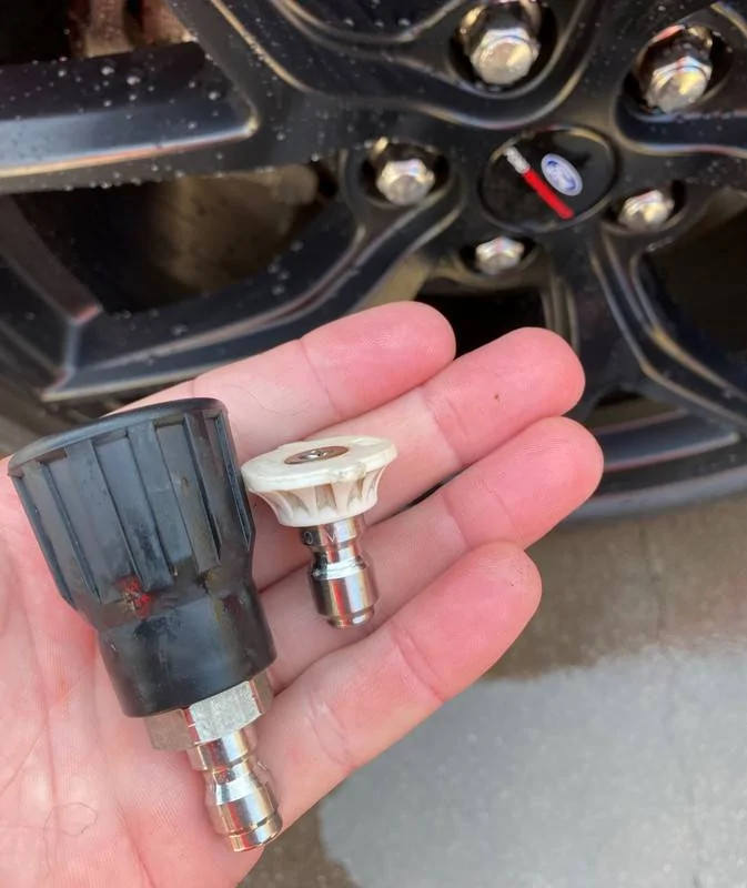

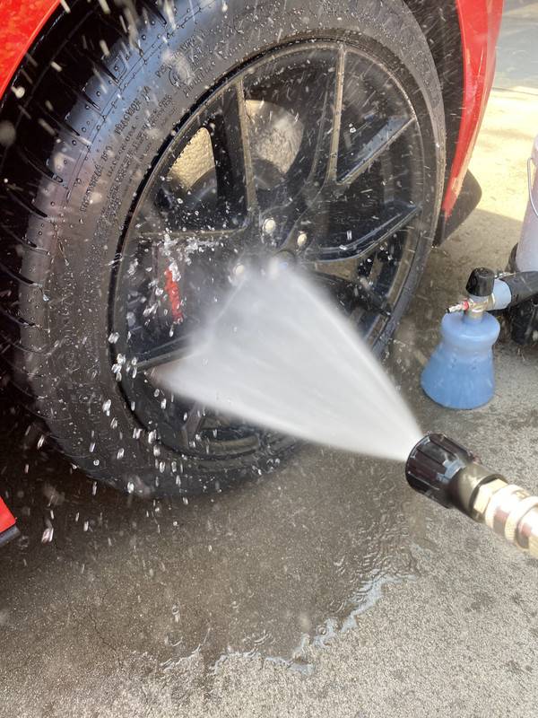

Here’s my nozzles. If you zoom in you can see the markings on the end. I use the 40 degree for my car, the 15 degree is good for spraying all the salt off my garage floor in the spring. The black one is for soap if your pressure washer has a soap compartment attached to it (mine does but I don’t use it). That tip works well for filling the buckets with water at low pressure

I use the OG 40 degree nozzle and it’s much better than the cheap snap-in ones that come with most washers. Those have a “hot spot” pattern at the outer edges where there is more pressure and less pressure in the middle. The OG nozzles have a much more even pressure across the entire fan pattern of water. Plus they have a nice rubber shroud that encapsulates the nozzle to prevent any dings should your accidentally bump your paint.

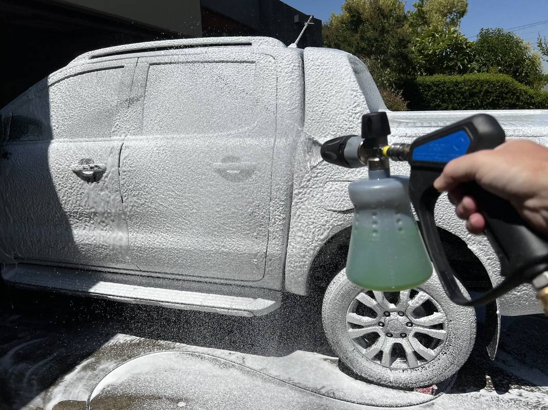

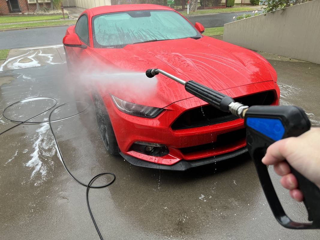

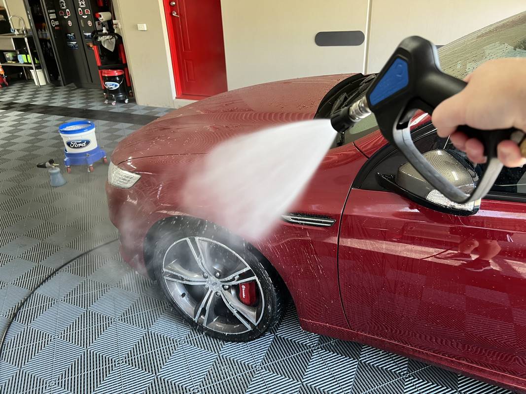

Firstly, well done on the upgrades, it will take a lot of the hassle out of using a pressure washer and improve the user experience massively. I will answer your two questions in separate posts, starting with nozzles.

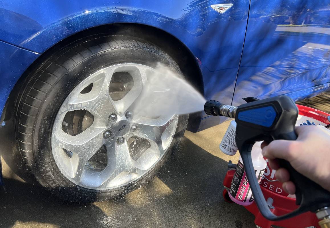

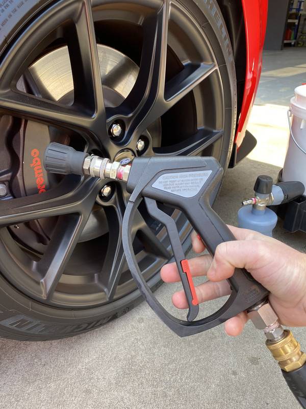

The SGS 28 (and other aftermarket "stubby" guns) does not come with an integrated sprayer nozzle. This is intentional as it gives you options.
For example, it allows you to choose the angle of the nozzle. For car washing, stick with 40 and 25 degree tips. I find the 25 degree tip is better suited to wheels and the 40 degree tip for washing the body. In other words, buy both!
In short gun configuration, and fitted with a 25 degree tip, this is the ideal setup for cleaning wheels.

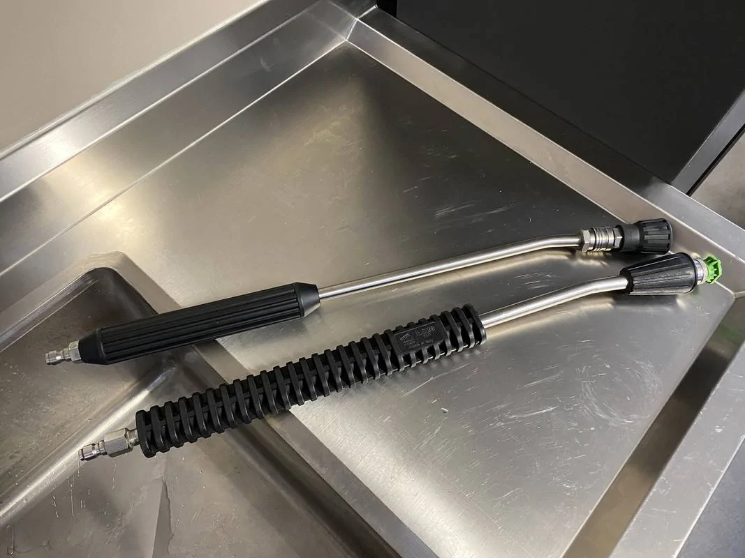

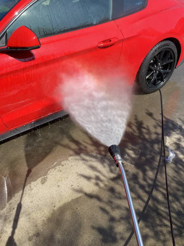

Secondly, it allows you to fit a wand. This is mainly desirable on larger and taller vehicles. I don't always use the wand for rinsing, just depends on the car I'm washing. (The wand and stubby gun have the same outlet fitting, so you interchange the nozzle between the two.)
OG Spec Stainless Steel Bent Wand | Mosmatic | Obsessed Garage
It also allows you to fit your foam cannon easily -

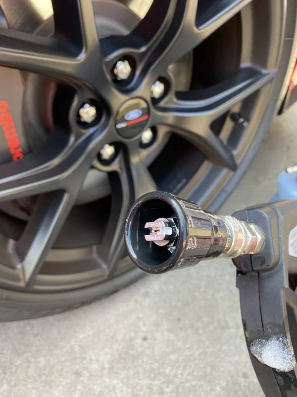

There are two main types of nozzles used on stubby guns and wands. The most affordable are the plastic winged tips, white for 40 degree and green for 25 degree -
Stainless Steel 1/4" Nozzle 4 Pack | Pressure Washer | Obsessed Garage
The second type are the rubber shrouded tips, offering a layer of protection between the metal nozzle and the paint of your car. (Accidents happen, these help mitigate this).
Mosmatic Stainless Nozzle Assembly | Pressure Washer Tip | Obsessed Garage Store
MTM Hydro - Acqualine Nozzle Guard | The Rag Company
From what I have observed, these nozzles offer a more defined spray pattern and have higher quality connections. We are only talking minute differences here though.
Also, as mentioned, you need to match the nozzle orifice to your specific pressure washer, this is for optimizing the flow rate while also being friendly to your machine. For a Karcher K3, you need the 3.0 size.

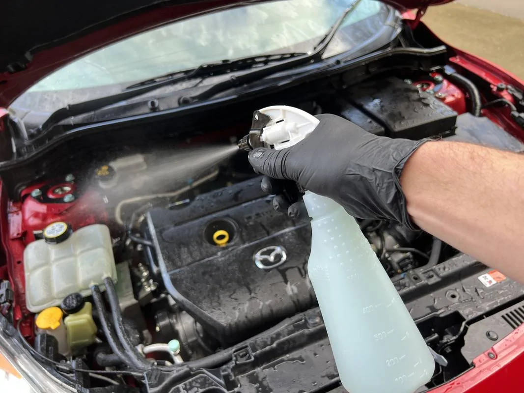

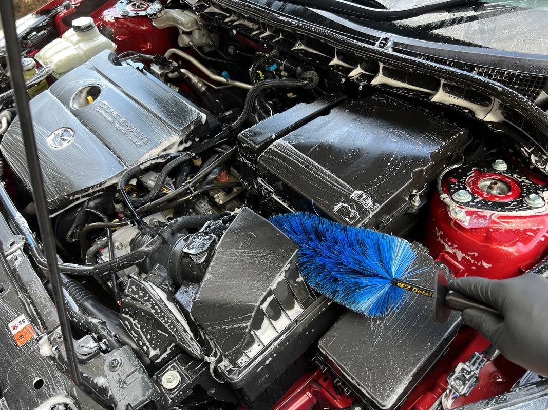

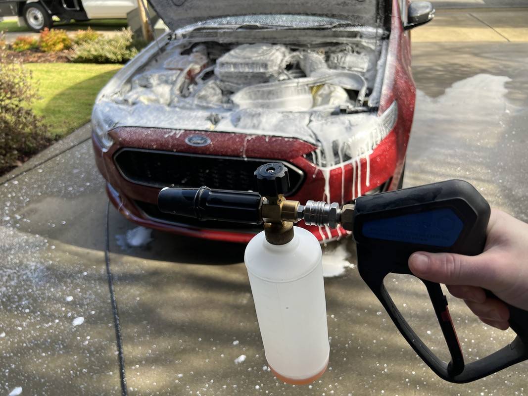

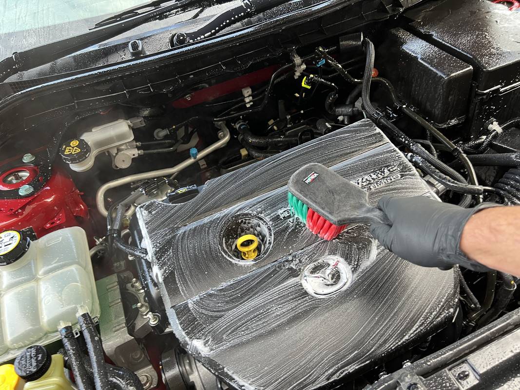

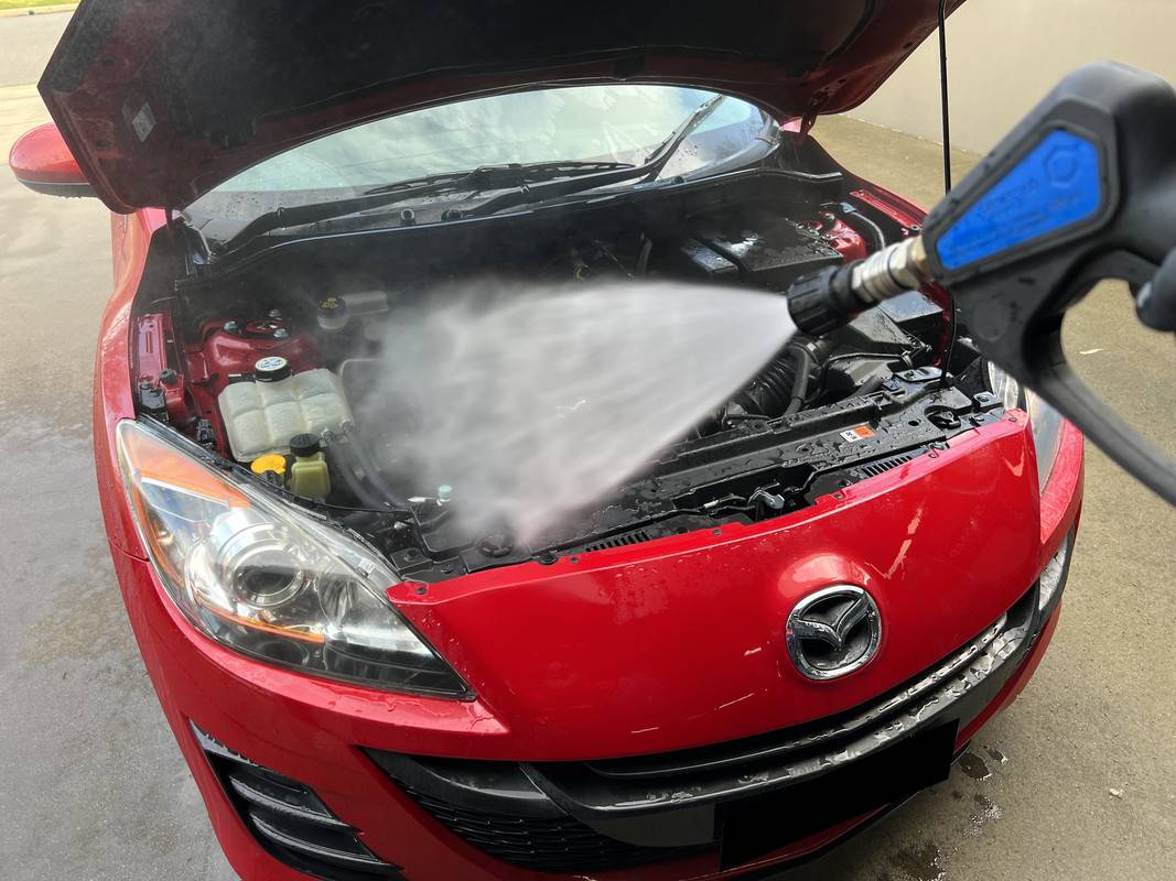

I was once a FIRM believer of not using any form of water to wash an engine bay. Only when I was confronted with the need to do so (don't ask), did I realize it's completely fine............with appropriate caution.
Below was an extreme case of washing, using a foam cannon to soak the engine bay. I did however cover the battery and pod air filter with a plastic bag beforehand. (A towel placed on top of the bags will weight them down and prevent the bag being dislodged by the flow of water.)
In most cases, you are really only using the pressure washer to rinse off the dust, and then removing any cleaning agent you may have used. In general, don't focus on one spot for too long and cover any sensitive areas like the battery, alternator, open air filter ect.
Once you are finished, you can then use your leaf blower or compressed air to remove any standing water. Run the engine for 10 minutes to speed up the drying process if needed.
I have done this process a number of times without issue. On modern cars, this process is safe provided you cover anything sensitive and observe appropriate care with where and for how long you aim the hose.
