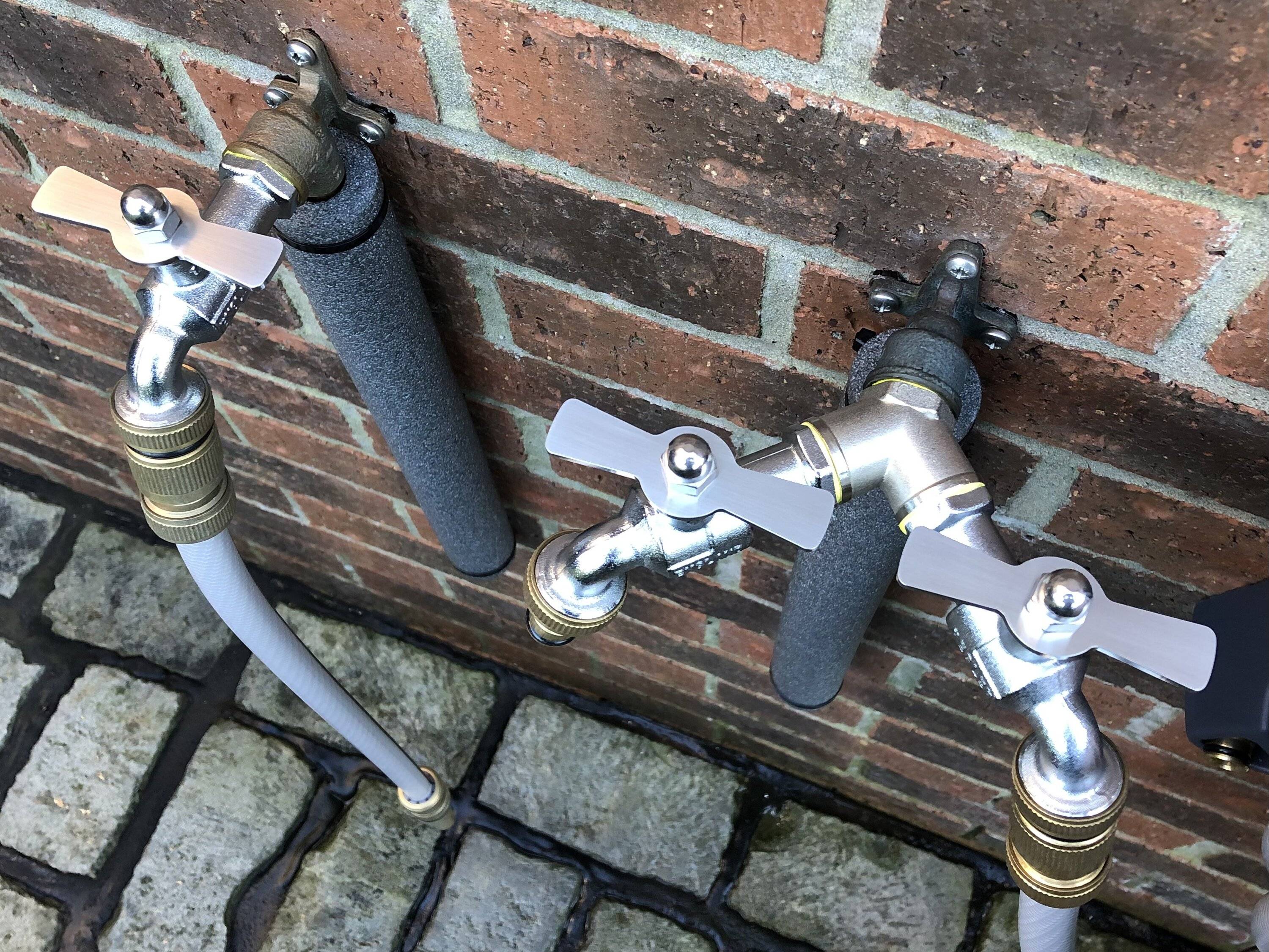

Just something else to consider with your washer.
I recently changed from a traditional garden tap to a full flow 1/4 turn ball valve type :
At the same time, I switched from feeding my washer from the standard hose (with an auto stop end), to a dedicated hose with open fittings and no restriction.
The difference in the performance of my washer was noticeable :like:
Sometimes the little things can really make a difference in getting the best from your kit :like:

WD: Dear LORD I love those hose bib quarter turn valves! Are those a UK thing as I've never seen them in the US?
Thanks
They are a UK make (Pegler) but I'm reasonably sure other companies must offer a similar design ?
https://www.pegleryorkshire.co.uk/E...U_Chromium_Plated_Hose_Union_Ball_Type_Bibtap
They are a little modified from how they are supplied as standard. The original handles were only plated and had started to corrode, I also didn't like the shut off angles due to the Y splitter that I put in the cold water feed . The current handles are stainless and my design to keep everything parallel to the wall when shut off.
Everything on that setup is now brass, plated brass or stainless so they should look good for years to come.

Thanks, Brutha and of course it was those gorgeous HANDLES that I was salivating over. :-) Yep, knew I could get a SS ball valve, I have many standard brass 3/4 ball valves on homemade hose bibs for the water well we use for irrigation, etc. I found SS handles for them but I MUCH perfer the petal handles on yours. Oh well...thanks, WD.
