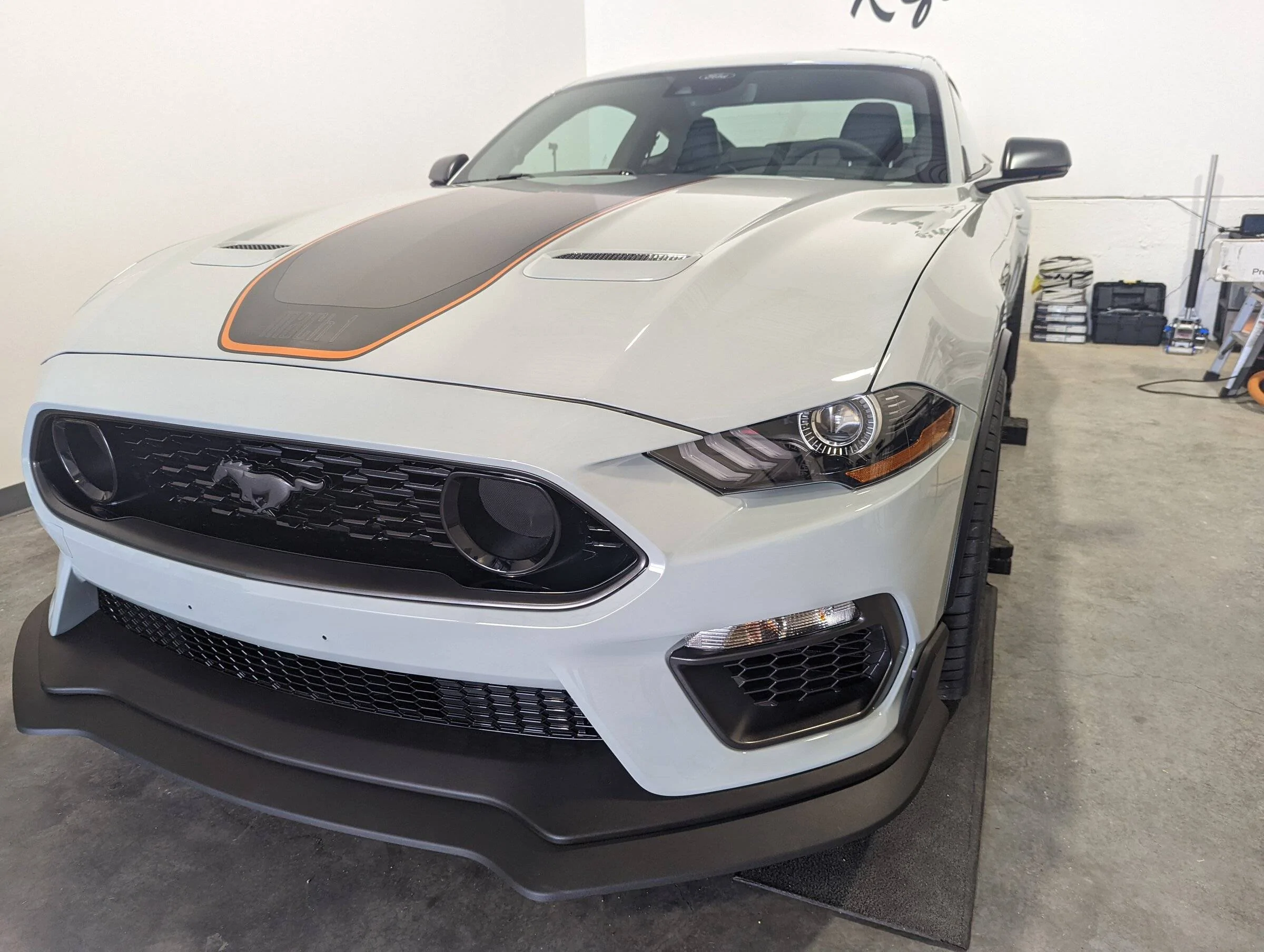

Getting my car back tomorrow since it is done. I'll get pictures. Currently have a 101 degree fever and achy feeling all over but that won't stop me from getting it.
Zelek
Feb 11, 2016
102
4,824
4,774
Hutto, TX
2021 Mustang Mach 1
As promised, here are pictures.

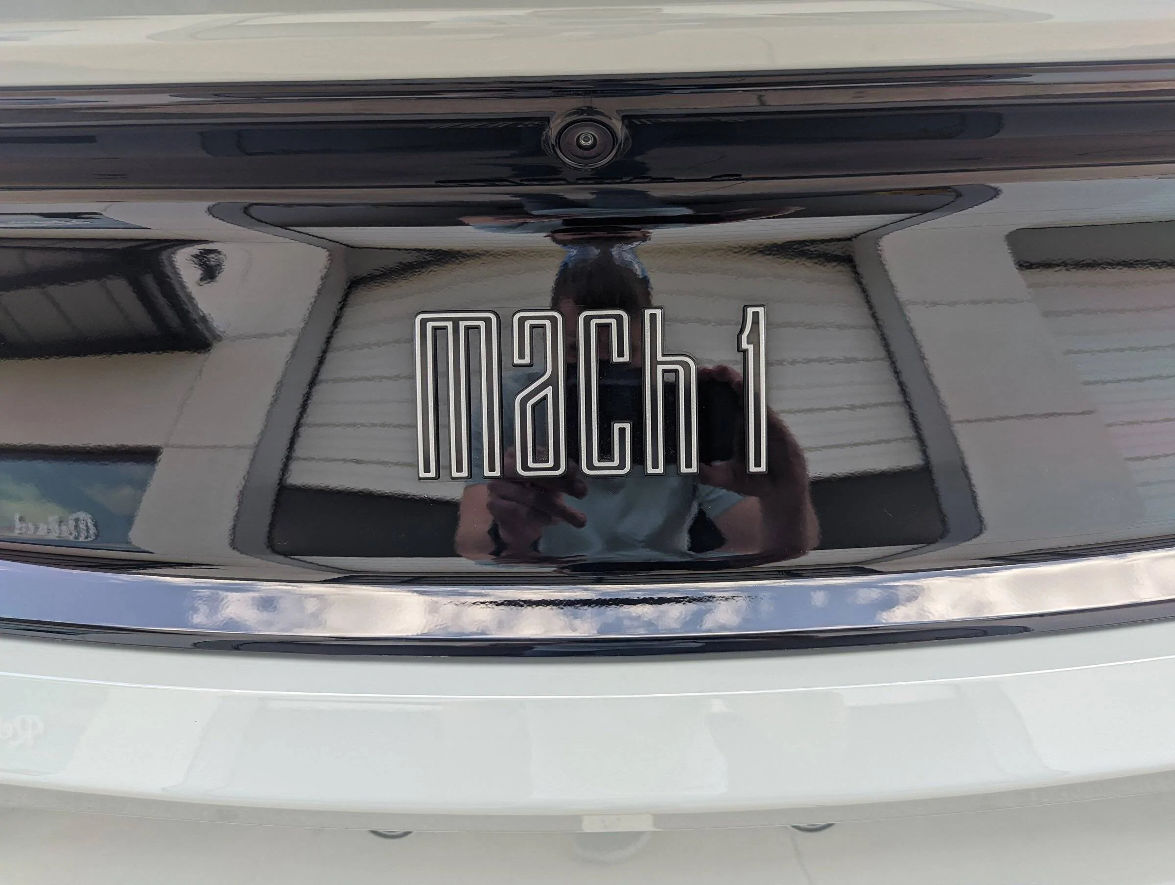

Look how great the Mach 1 emblem came out:

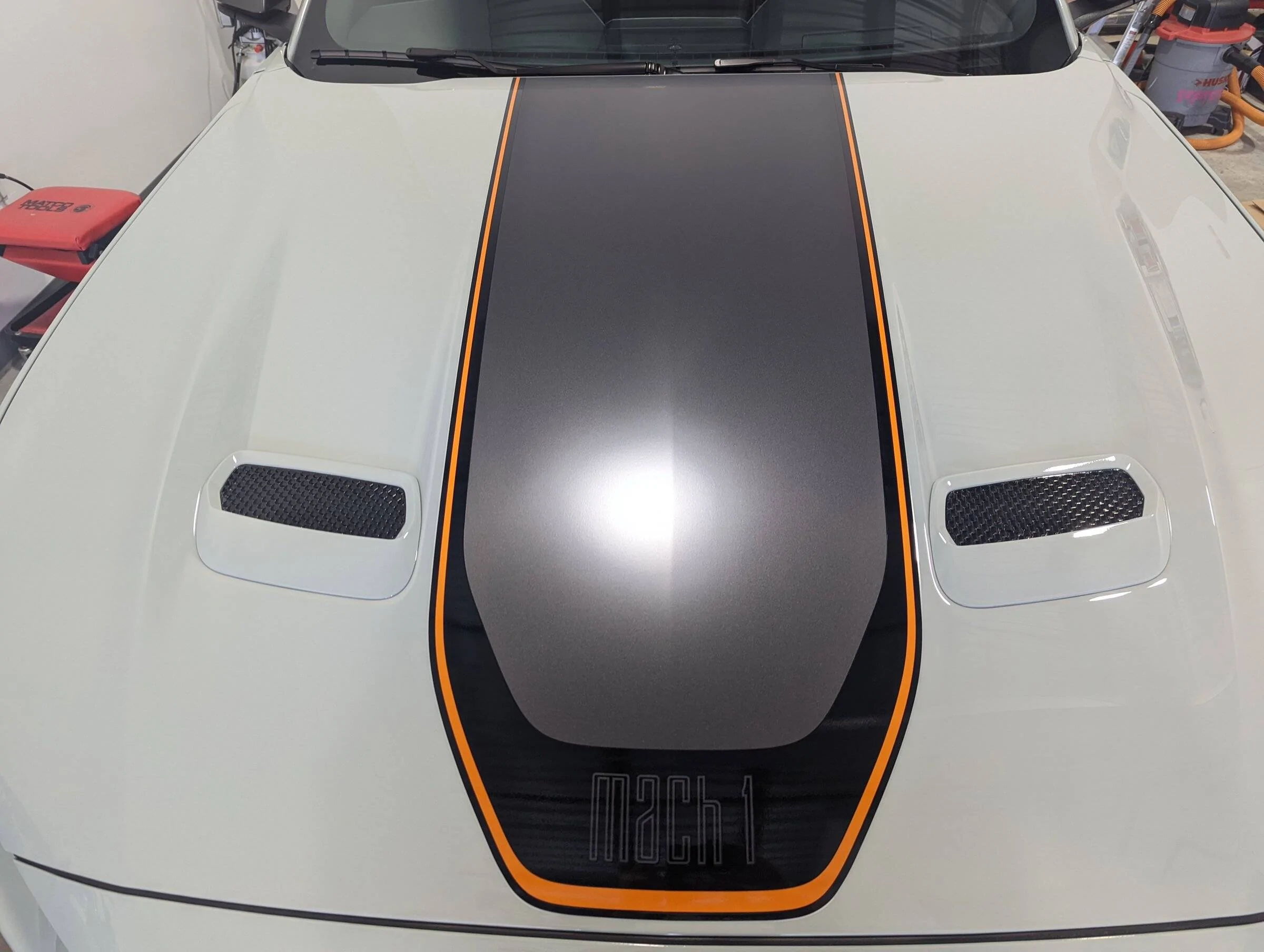

looks too nice to drive it! what did you end up doing with the hood vinyl? cut around it or covered in PPF?
Zelek
Feb 11, 2016
102
4,824
4,774
Hutto, TX
2021 Mustang Mach 1

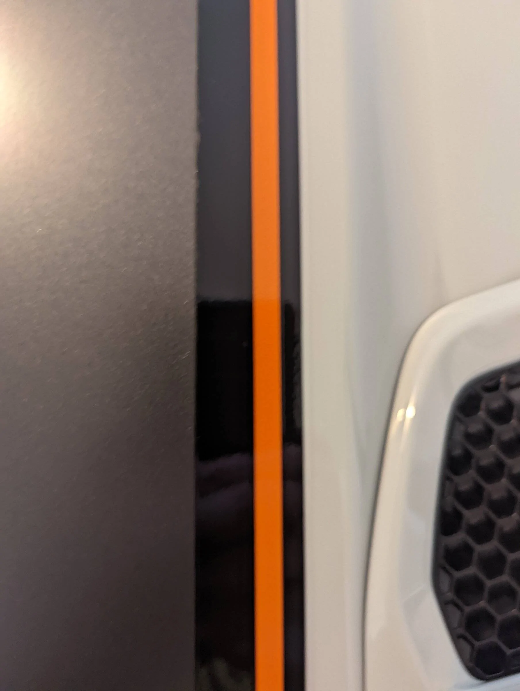

Matte piece cut and put up against the gloss strip. All hand cut.

If you want the best protection remove the vinyl, PPF the whole hood, and reapply new vinyl. The hood graphic is cheaper than a PPF wrap and definitely cheaper than repainting the hood. You can ceramic coat vinyl to help protect it.
I consulted with one of the top wrappers in the NJ/NYC area and this was their way of doing things. Everything is removed, Decals, badges, etc and re-applied. Not sure if they understood how large the hood decal is though. I think the WORST option here is cutting around the vinyl. A wrapper who doesnt know what they are doing WILL cut through your clear coat and possibly paint, hand cutting around such a large decal. Then on top of that there is what is called shrinkage and you risk having a large enough gap between the vinyl and PPF where dirt will collect, or premature failure will occur.
Long story short the BEST option is removal, PPF, and then reapply new (or old if possible) decals, then ceramic coat the vinyl decals (or whatever else you choose to protect it), unfortunately I think the only vinyl out right now is expensive OEM but in the future they will be a tenth of the cost.
The next best, less expensive option, is to cover the decals. The only risk here is failure over the matte portion (the FMJ vs non FMJ debate, which may also be ppf material dependent). Regardless there will be a small ring of separation between the vinyl decal and PPF. It wont be that noticeable from a distance but it will be there. It will be less noticeable on oxford white, and more noticeable on shadow black.
Lastly, the cutting around thing just doesn't make sense. The vinyl, if protected, will last longer than most here will own the car before it gets wrapped around a tree or sold.
Hopefully in the future ford offers the ability to ship with the decals unapplied, the same way they are doing the splitter. Until then you should be consulting with the wrappers as they will have the most experience than anyone here. They will breakdown the pros and cons of each, give a recommendation, and leave it up to you to decide.
