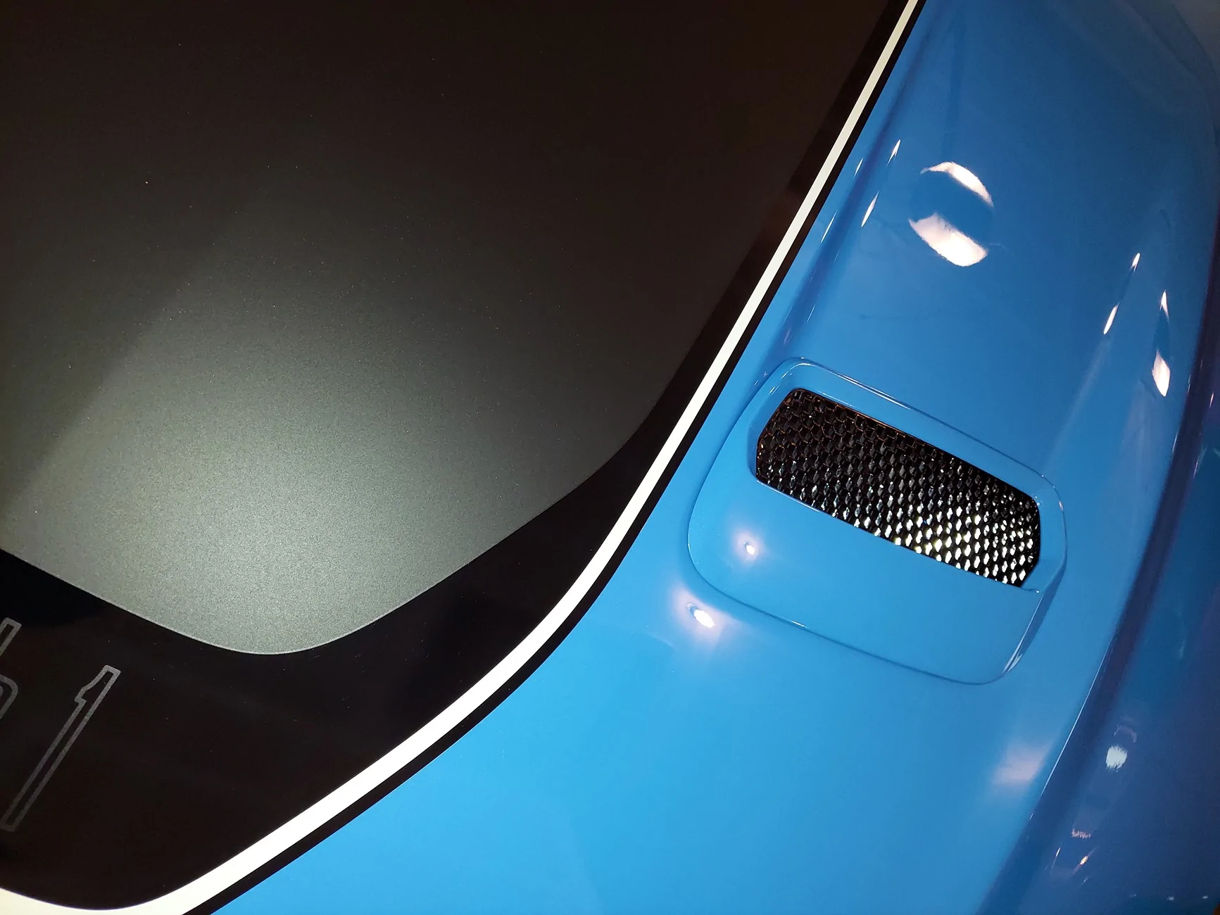

I do have PPF across the painted areas of the hood.
My installer is an Xpel franchisee. As part of any agreements, they are given access to Xpel's vehicle database, something akin to a large repository of CAD drawings. Using large plotters, they cut PPF for one panel at a time, install it, then go on to the next panel.
The painted area of my hood is covered in PPF. The decal is not. The PPF as it came off he plotter had a blank section where the decal is, but was otherwise one piece. The PPF goes right up to the edge of the decal and stops.
An additional option for the decals is ceramic coating. While not offering impact protection like PPF, ceramic coating will protect the decal from the elements. This might be worthwhile for a vehicle which sits outside or is a Daily Driver.

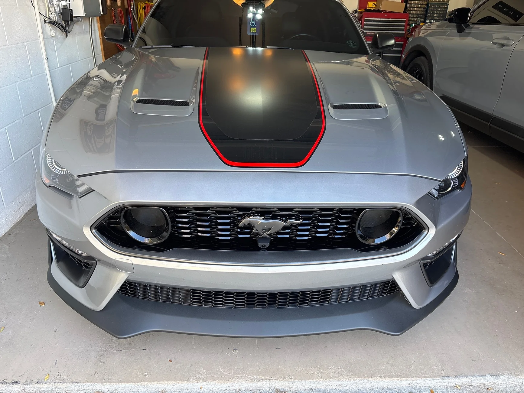

I had the complete front end of my Mach 1 PPF applied. I did both front fenders, the front end, the headlights, the hood, the front pillars, and 11 inches from the top of the front windshield back.
The guy that did the PPF work on mine cut around the decal and because the decal is a matte finished, he applied a matte finish PPF to the decal.
Is it a local guy that does fantastic work. You can’t even tell it on mine that there’s PPF applied. He installed XPEL PPF.
When he did the front fenders, he actually removed the lettering and reapplied it. You cannot tell the difference. It all depends on who you get to do the work.
Total cost about 2k.

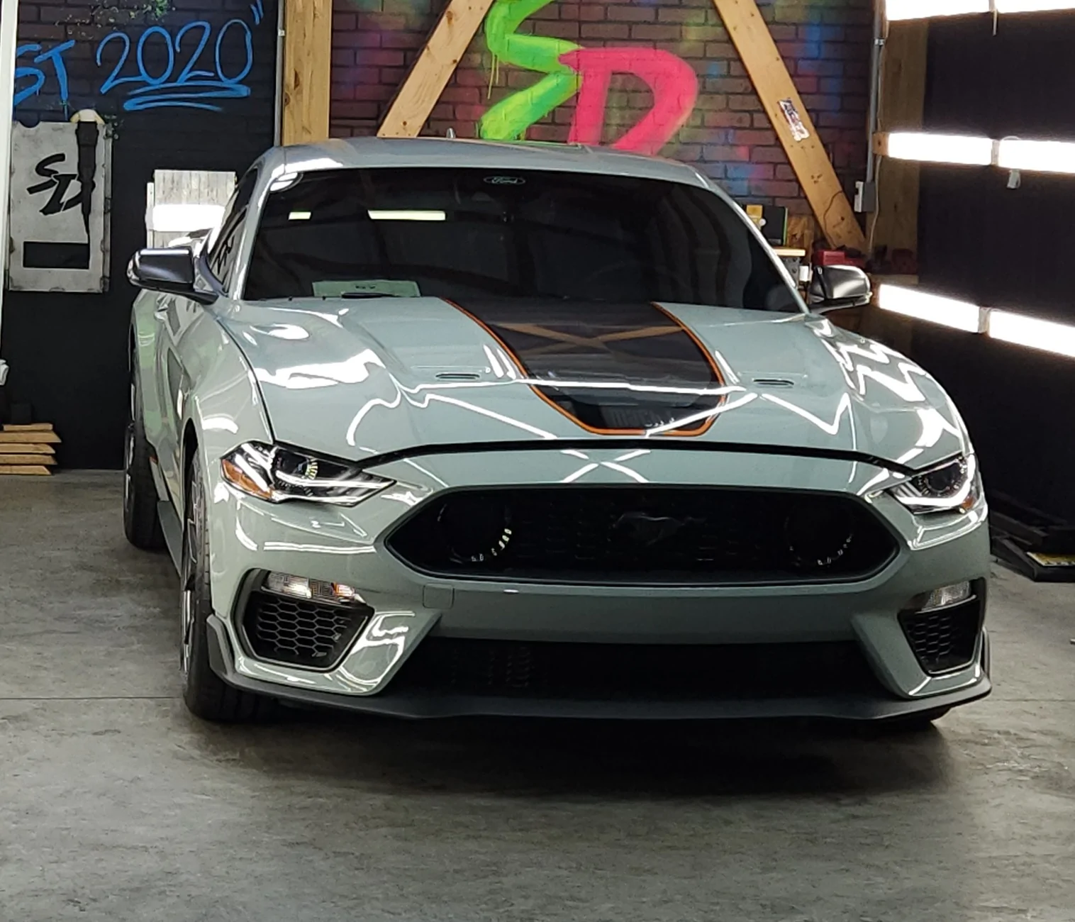

Mine is FJG and I did apply the PPF over it.
This is the only decal that can have PPF applied over the top of it.
I did the entire nose, A pillars and the front section of the roof, rocker panels, behind the rear wheels to include part of the rear bumper and the top section of the bumper where the trunk opens.
