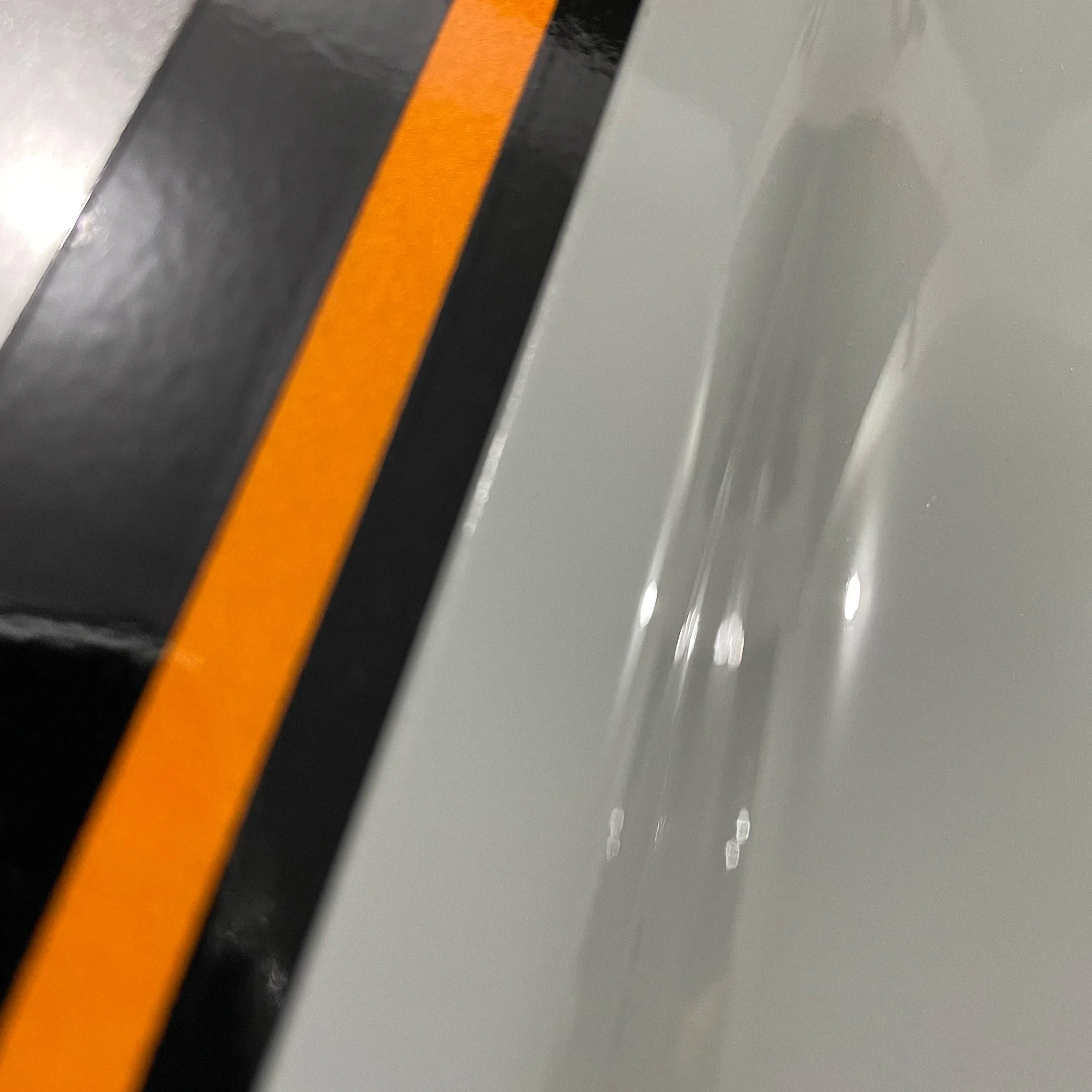

What do you mean "until they trimmed it"? Is that good or bad?
Good, in that they did exactly what I asked for based on their recommendation. They cut out the PPF so there is nothing on the vinyl. It’s cut right up to the edge. The thicknesses of the PPF and vinyl are so close that with a good seam you can’t tell there is even film on the hood.
Zelek
Feb 11, 2016
102
4,824
4,775
Hutto, TX
2021 Mustang Mach 1
Are you able to see the seam? Did he have to hand trim that piece or was it done by the computer? I need to run that by my guy. I would be worried the edges will lift in time.
I can't see it even when I try. I believe that was done by hand. It takes good knife skills to cut it.

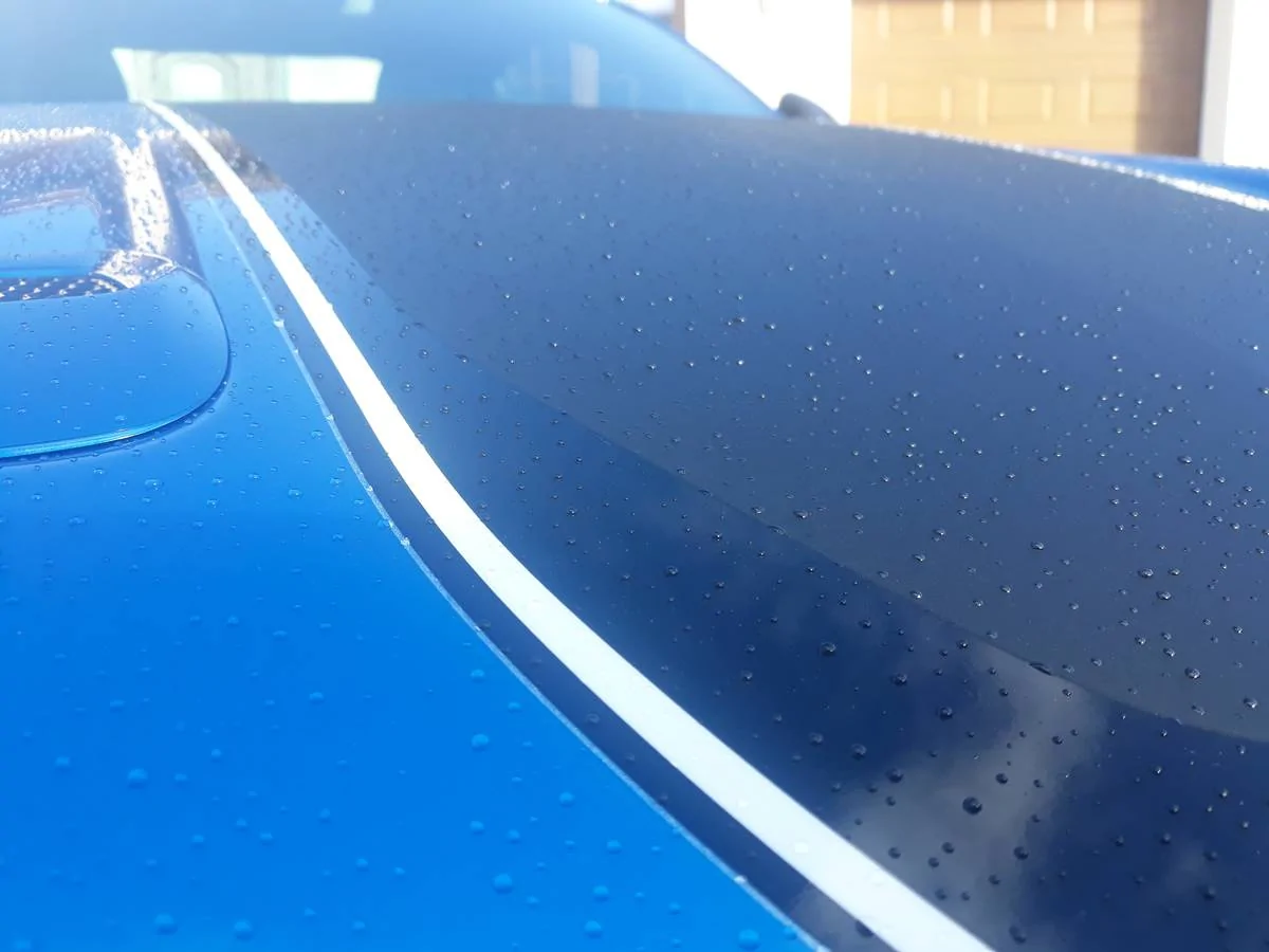

Yes, it will, necessarily, it's due to the thickness of the vinyl and PPF bending over its edge, it causes maybe 1.5 mm line of air around the vinyl. Doesn't bother me at all, I'll rather take that than dirt collecting between PPF and vinyl or scratches and holograms on fragile glossy part of the vinyl.
Thanks. This picture is actually interesting because your matte looks fine. On this thread, there was a conclusion that the non FJG colors had a rougher matte which could cause failure during the wrapping process. seems like just the wrap over everything is fine
