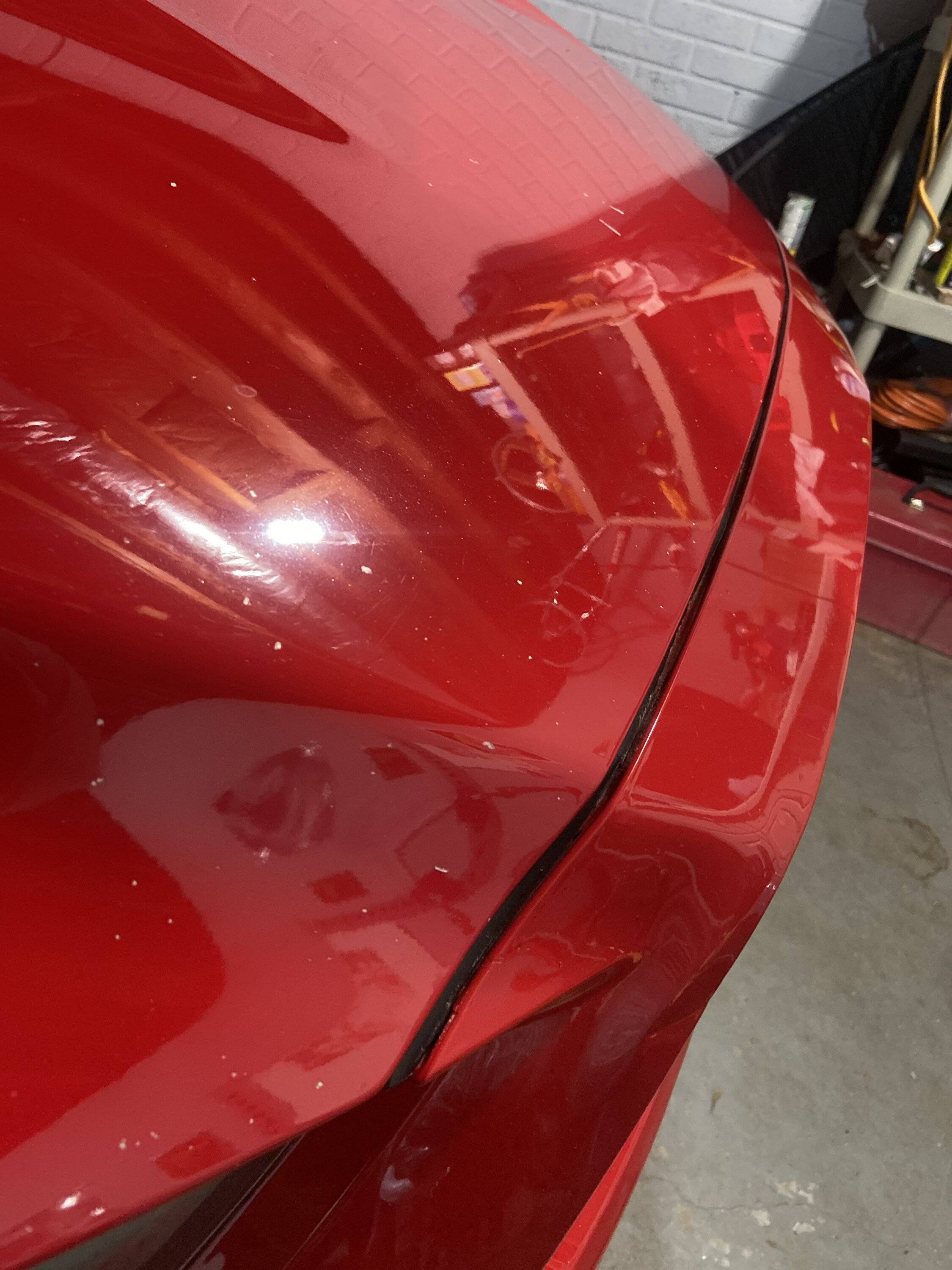

I have the same same issue pretty badly. Admittedly my car has 150k miles but it has so many marks. I have been wondering if it was just me.
It’s like this across the entire front of the hood.

Yeah I would get it before it gets bad. Luckily you can only make out two of the rock marks from over 10 feet away because of the red paint and the rest of them you need to be like 7 feet away or closer to see.

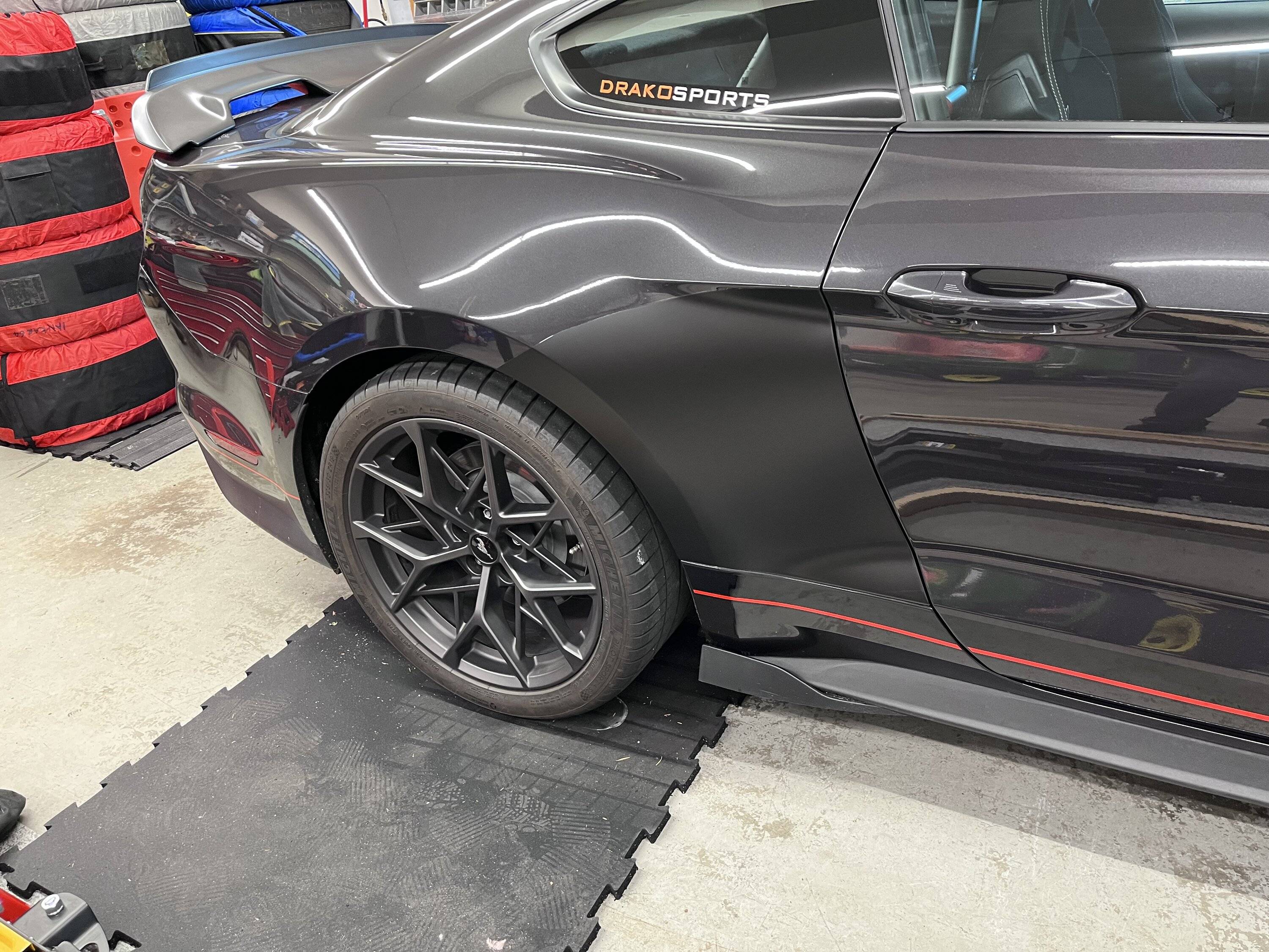

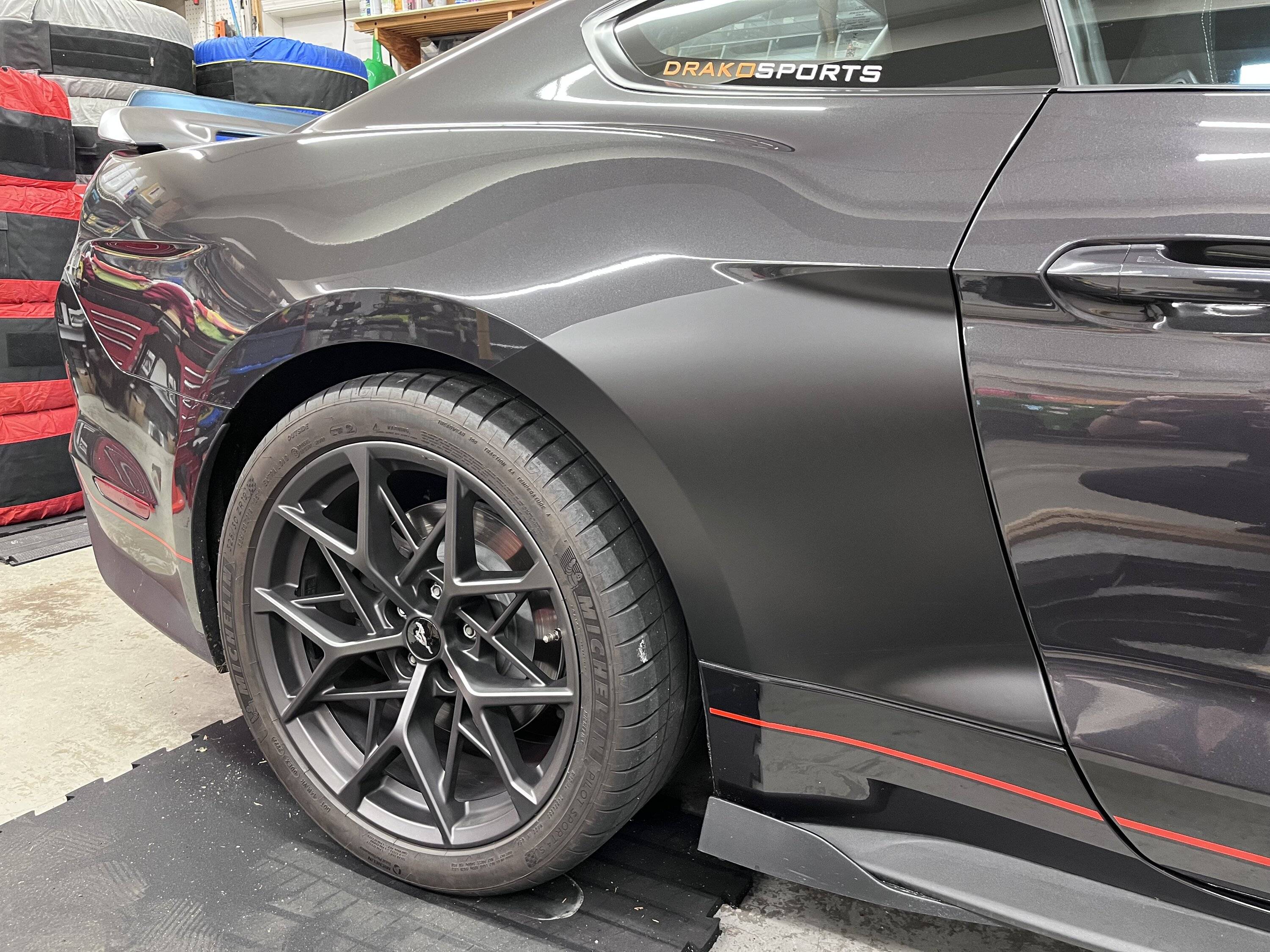

I had the same issue with the rear fender area. I did PPF the front with the Track package but when I noticed the rear getting chipped up, it was too late to PPF. So I got PPF done with a matt vinyl. For the front though, I don't think this method would look good.
