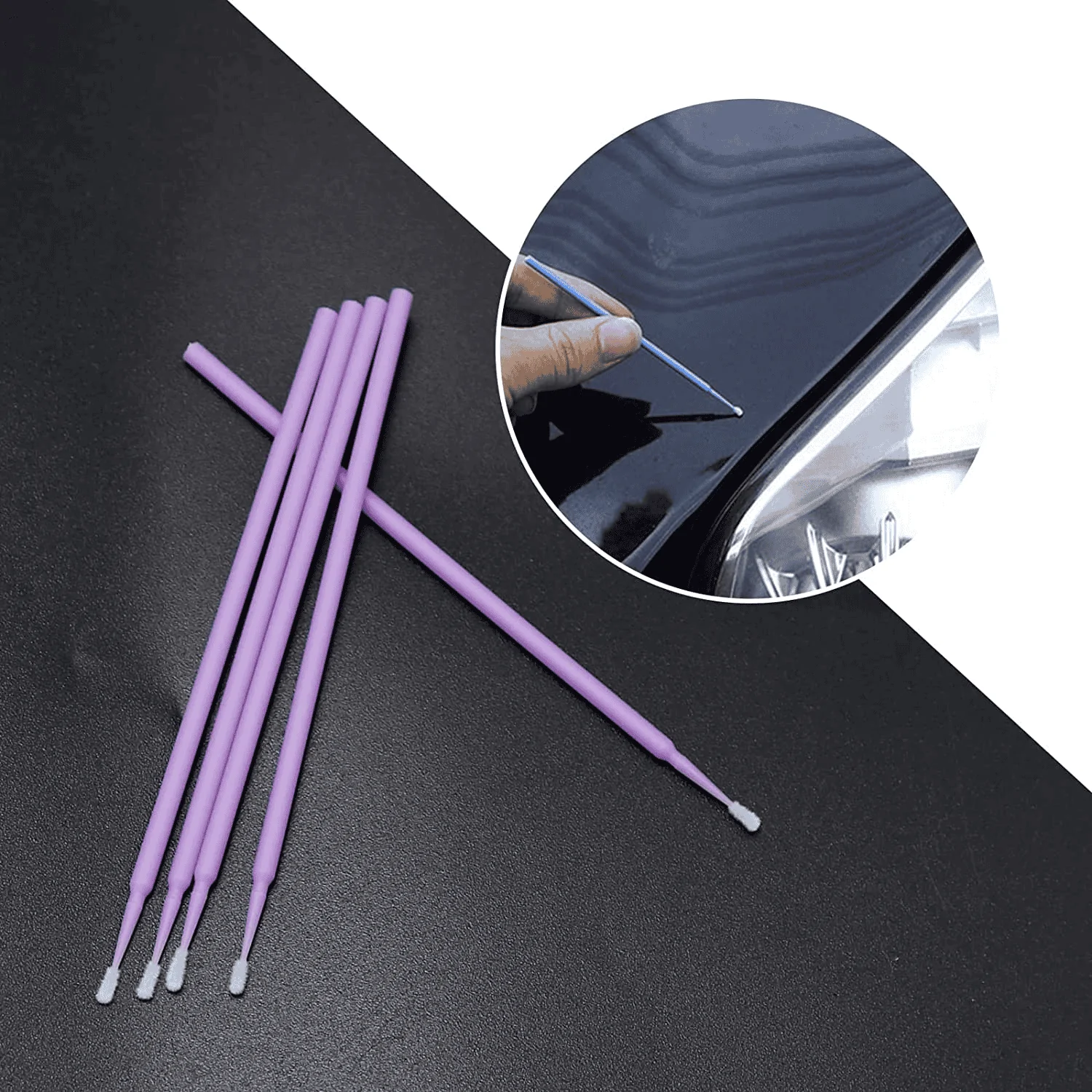

I have had 2 ingot silver cars and luckily the primer used from factory on both cars was a light grey color which did not contrast with the ingot silver vs white cars with black primers or those with dark colors and a white primer. I have touch up paint stick applicator box that I found cheap on ebay. It has all kinds of sizes of soft tips and plastic handles and just take a small dab of the touch up paint I have and I dispose of the stick. it applies better than the touch up paint brush.
I need those. Got a link?

Touch Up Paint Brushes for Automotive Paint Chip Repair Disposable Micro Applicators (1.0, 1.3, 1.8, 2.5MM, Multi)-200PCS https://a.co/d/6xO2Gd6
This is why I love this place, you guys show me new things almost every day.
The applicator was stopping me from doing any touch ups until someone mentioned these tiny, disposable applicators.
Mine arrived yesterday.
Thanks once again!
