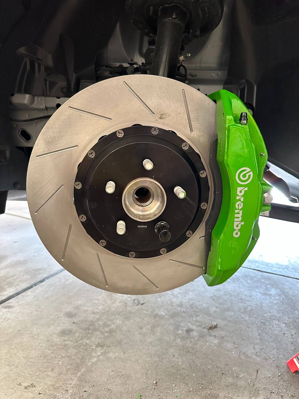

Dax
I did mine with the G2 product. Ford "Gotta have it" Green. Car still stops. I think Brembo is just making sure the lawyers are happy, so that when someone gets paint into the caliper, or on the pad etc. and then tries to blame Brembo, they can point to that fine print.
