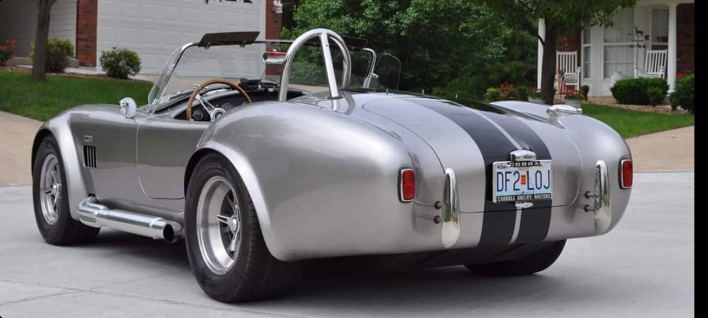

Check out Wilwood. I had them on my Cobra.
