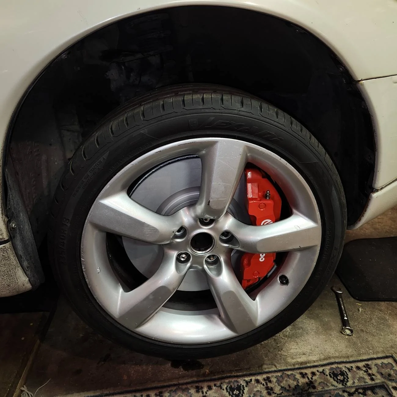

I think its lawyers talking telling people not to powder coat Brembo calipers. Aren't the R Model calipers powder coated red? I powder coated some 18Z Brembo's on my Z and have tracked them for 3 years without a problem and with no fade. It was a bitch getting the factory powder coating off.

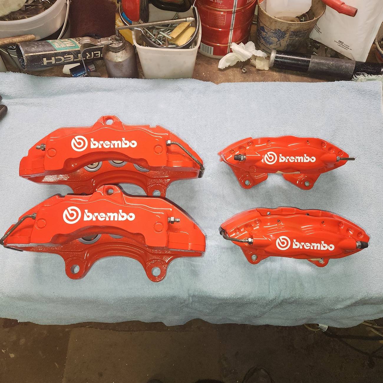

For looks and longevity of looks there's no substitute for powder coating period. I get it that a lot of people either don't want to go trough the trouble or aren't knowledgeable enough mechanically but I've seen a lot of painted calipers and all of them looked like they'd been painted. My calipers.

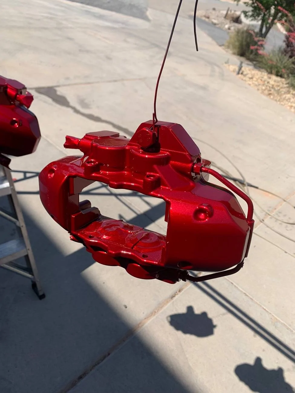

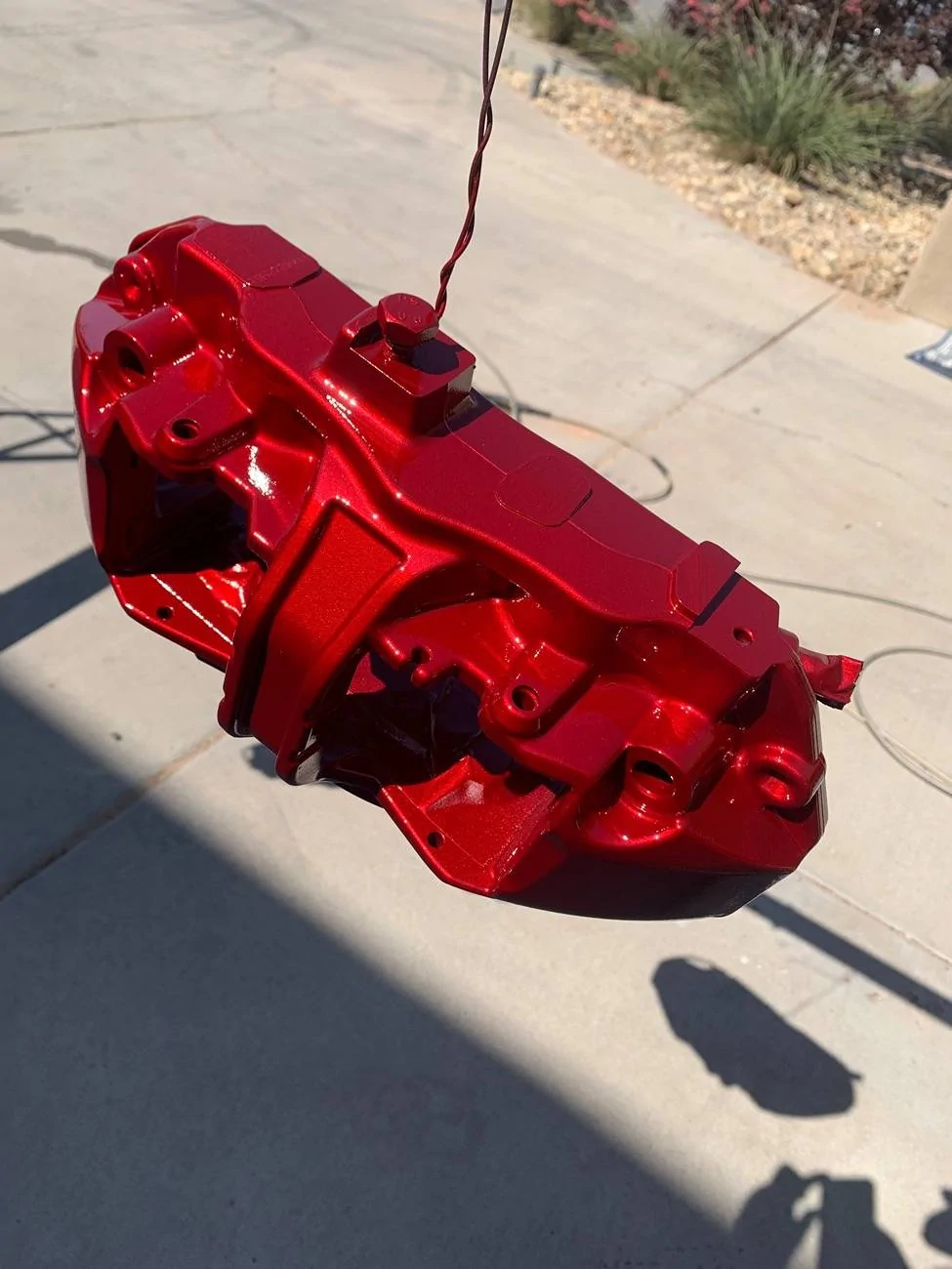

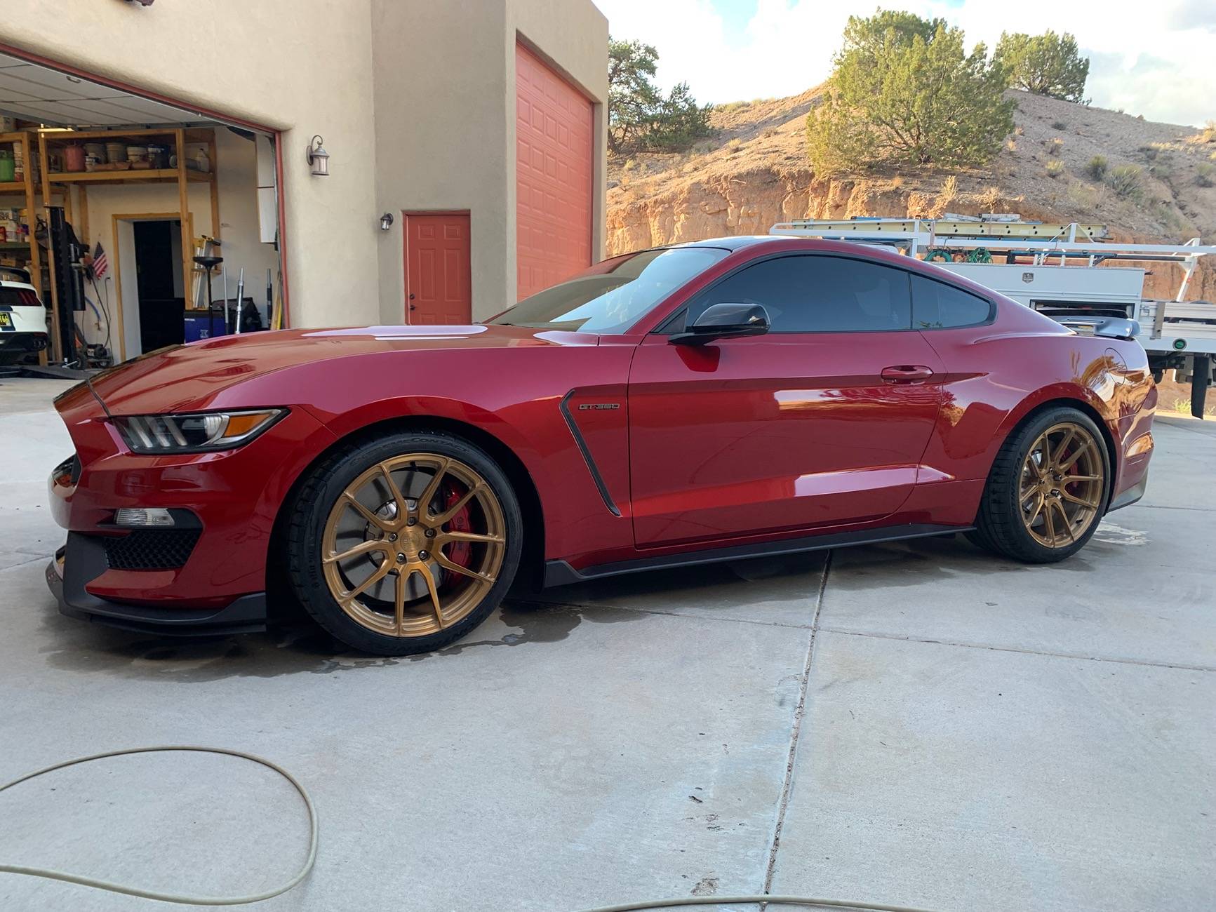

Powder coat is not the end all for durability or appearance. I’ve seen just as many subpar applications with powder as I‘ve seen with paint. That said there is a huge difference in doing it off the car as opposed to trying to leave everything assembled and work around it. It comes down to what level of finish someone wants. I’ll leave alone how many parts I’ve seen rendered useless because someone wasn’t paying attention to the cycle time in the oven. There are colors, like candys and tri stages, that powder won’t duplicate.

That’s interesting. Evidently they’re not on the same page. From Brembo’s site. Same exact process I used. Epoxy primer, urthane base, acrylic clear.

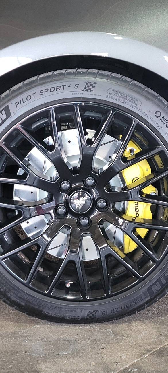

Calipers painted, brake hats anodized
