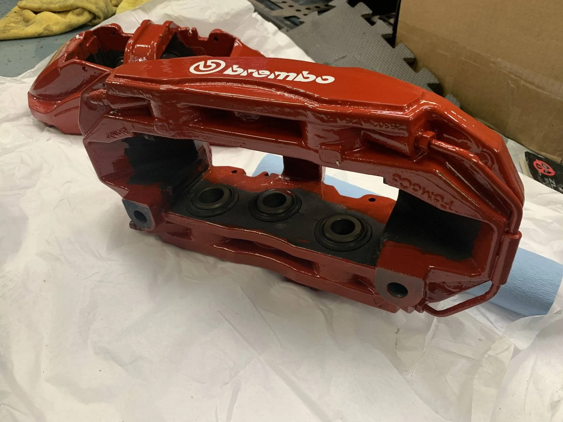

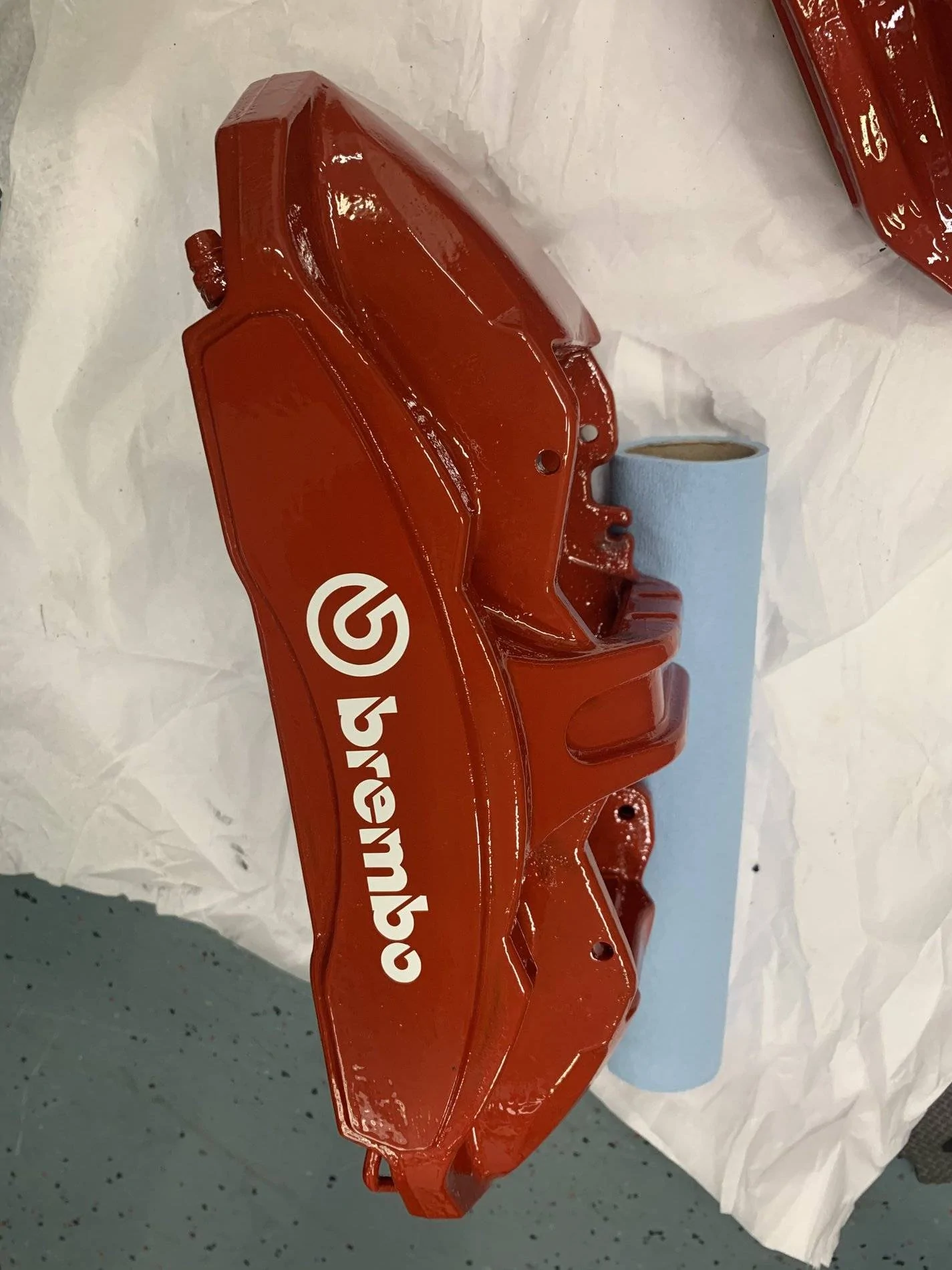

one kit will do 2 calipers. I did a set to sell them (since regular calipers were more plentiful in the classifieds). While it self-levels, getting a truly smooth surface is very difficult. Though under a wheel at normal viewing difference, it would be hard to differentiate them from the oem R caliper ( I bought a set of those, they're not perfect either)

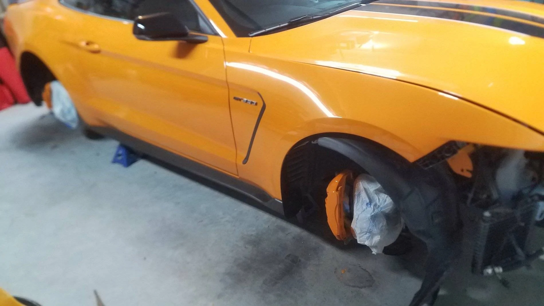

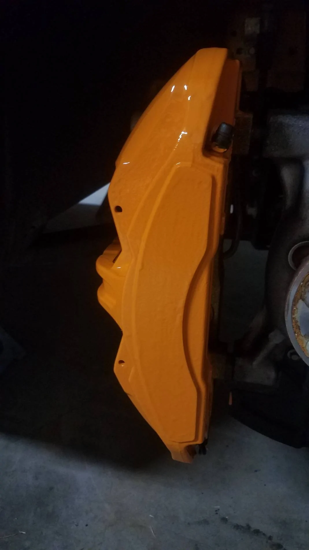

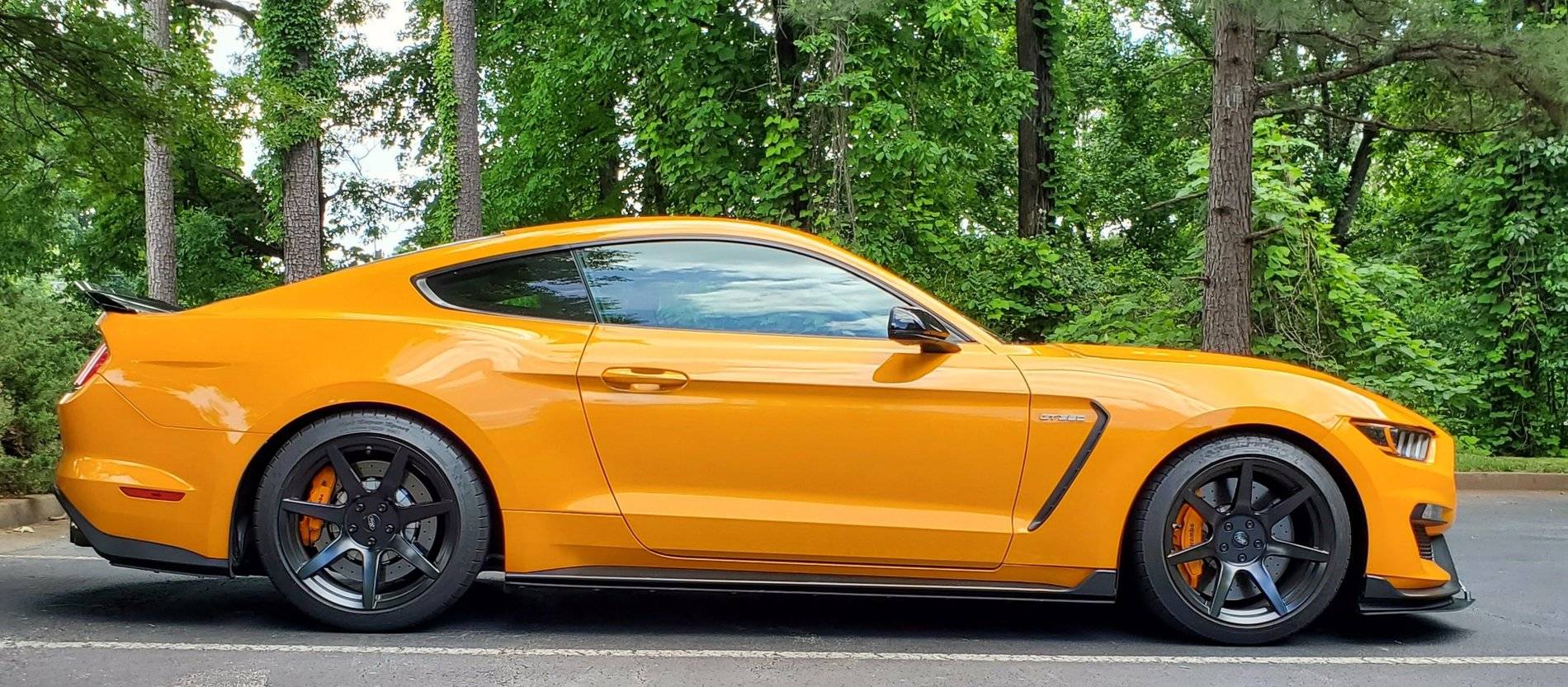

Custom color matched to my paint code since it wasn't one of their standard offerings. I think it's $110 vs $60 to have that done. Brushed base coats, then sprayed the last coats via Preval sprayer. Logos are vinyl graphics. Only painted the visible portion of the calipers so was able to do it with 1 kit.

You painted it without even removing the caliper? Was it hard to do it that way?
I removed the front caliper enough to remove the pads and rotors. I should have done the same in the rear.
It was easy since I was only painting the front face and the top half of the caliper. With the 19" wheels I run you can't see past the painted section of the calipers.

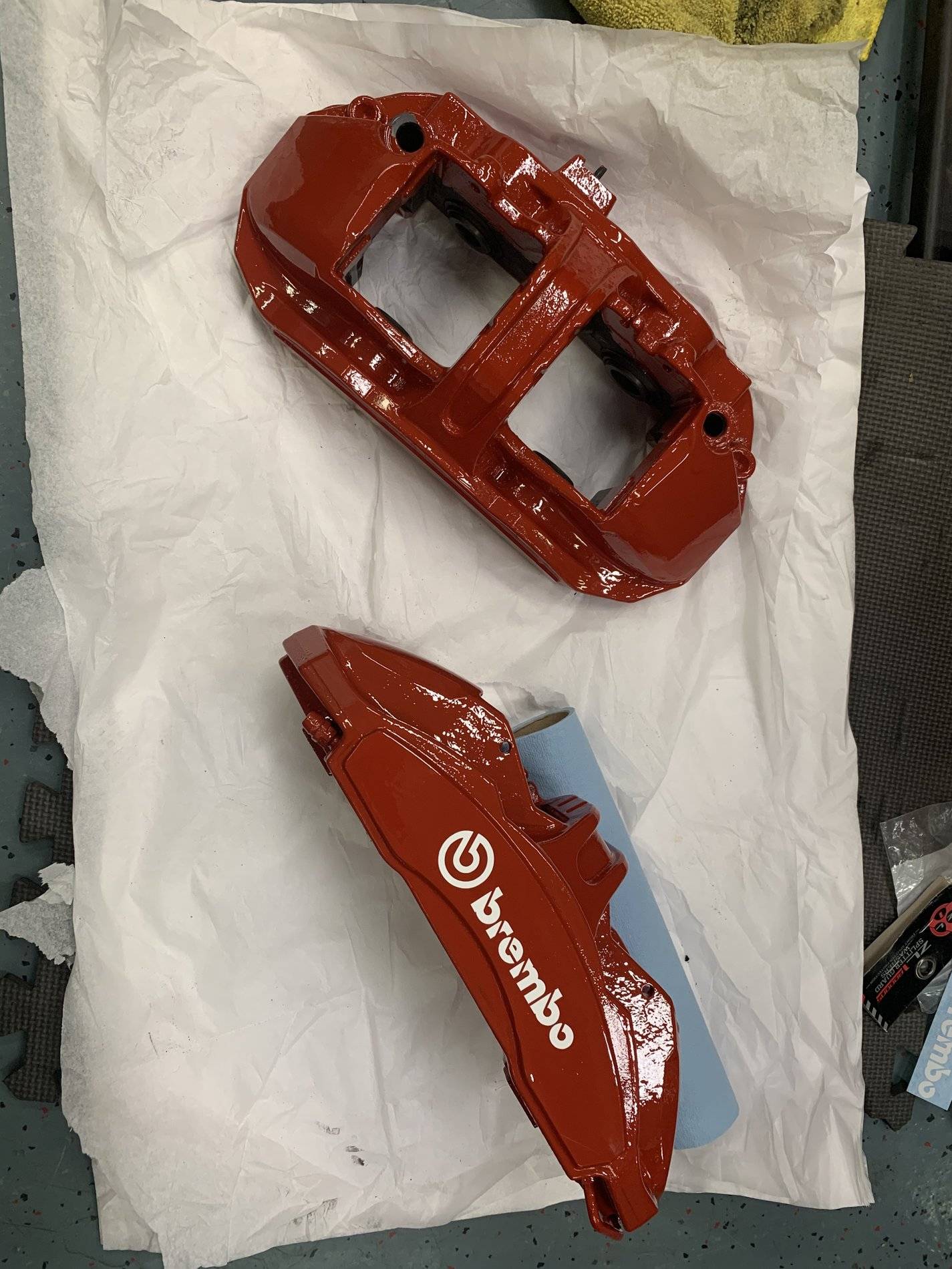

sabtaj1
Sep 11, 2019
31
1,157
1,340
Bettendorf, IA
Jason
2019 PP1 Mustang GT, 1965 Fairlane 500 wagon

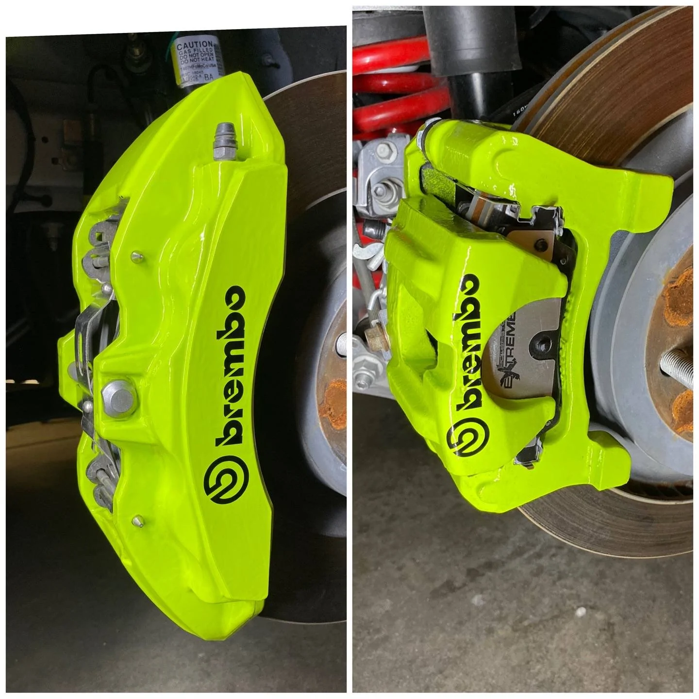

It’s a lil job but was worth it. Very happy with the way they turned out. And ya ya, I know. The rears aren’t Brembo but stickers came as a set. So whatever. I did grind down the casting lines on the rears.
