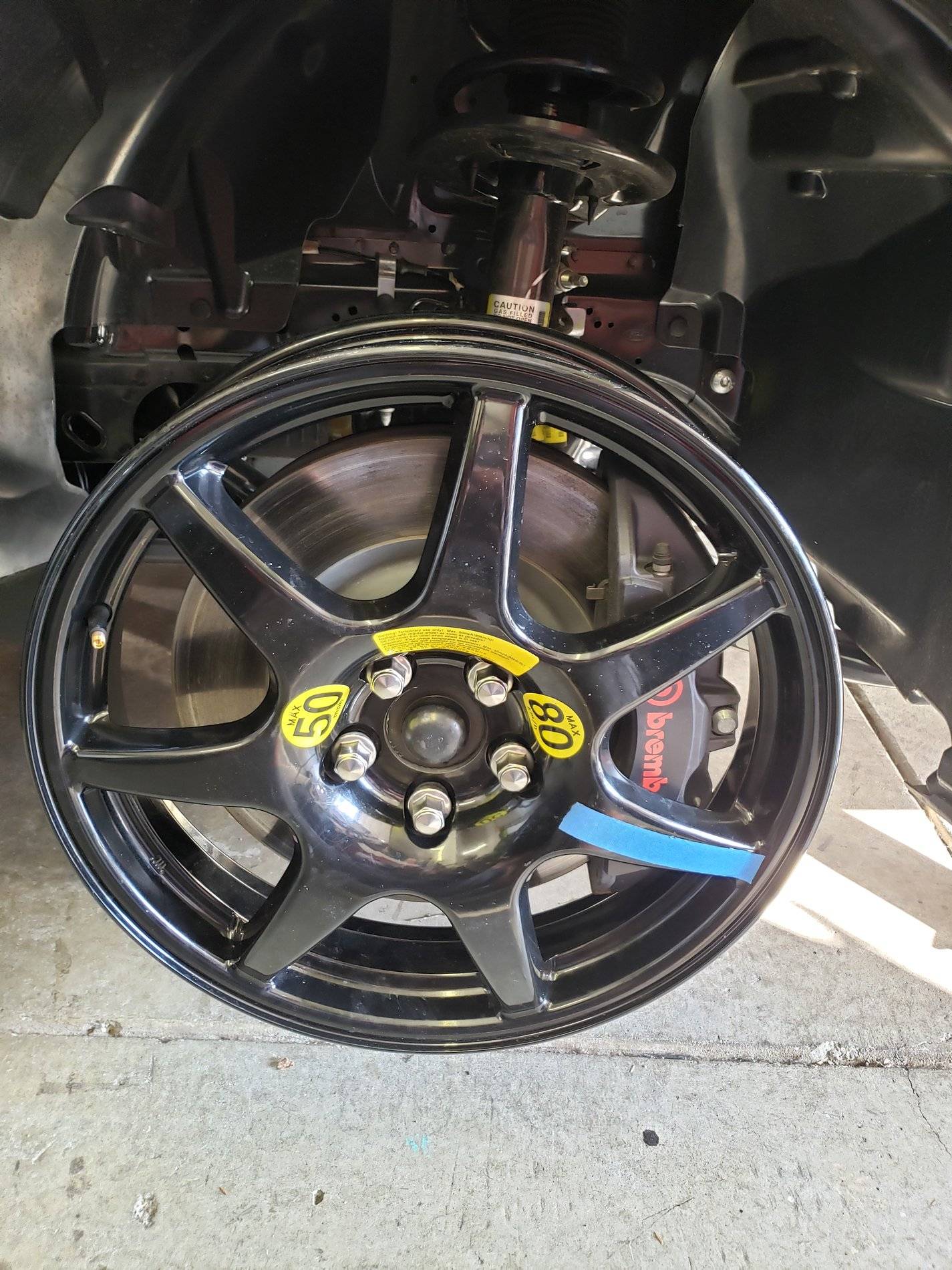

If you are looking for a cheaper alternative to the $400.00 priced spare, source a used 19X4" spare tire/wheel assy for a Hyundai Equus. I used Car Parts dot com for one and got one shipped for $115.00. Your local junk yard may have them too. The only thing that need to be done is to have the hub bored to fit the Mustang, the machining cost me $40.00. So for me, it was $155.00 instead of $400.00. The idea of the Equus spare tire assy was NOT my idea. I found the information on this forum posted by another member.
14,682
12,216
what's the clearance to caliper front face?
