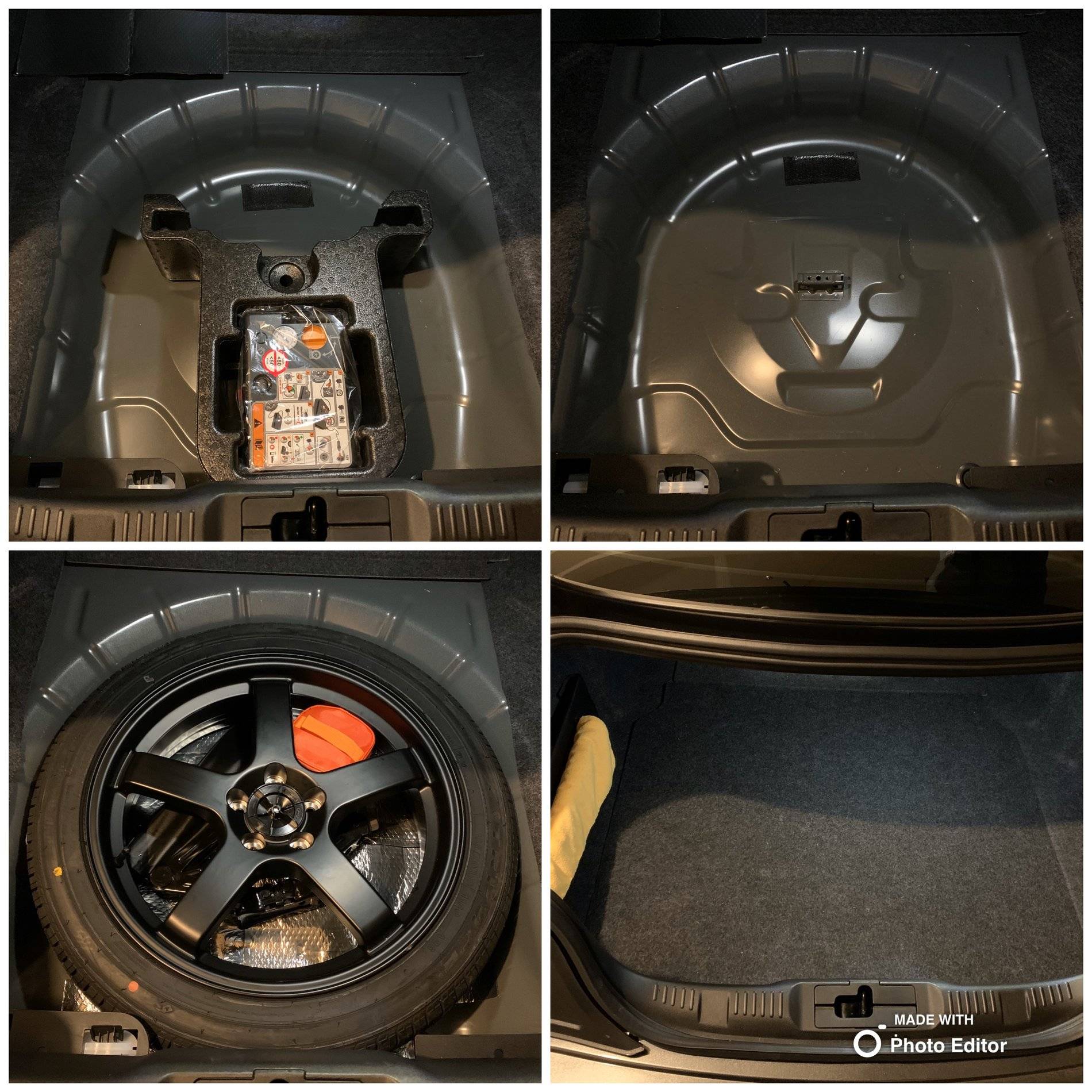

I went the AA route with collapsible jack for peace of mind too. Added some sound dampening sheets to the floor pan to reduce rattling and vibrations. Fits perfectly. I even added a roll up tool pouch with 150 ft-lb torque wrench, collapsible lug wrench/socket and some extra hand tools all tucked beneath spare. And even fit emergency LED road flares, as well. Better safe than sorry imo.

The AA wheel fits PP2. I called them and asked when I upgraded and personally test fit it to the front.

My 2017 Mustang is just the base V6 (which I love), without PP. I decided to go 'old school' and forego some trunk room (it's just me and my wife, and we don't take the kitchen sink when we travel). I found a new aftermarket wheel for $50, and am putting a good used tire on it. The cost is pretty reasonable, and I'll be using my little 4,000 lb floor jack that had been gathering dust and a 1/2" breaker bar I picked up for $11.

Hi EFI, so a 235-35/19 on an 8.5: wheel fits in the spar tire compartment? Now that's nice to know. Thanks! My question is this: I thought the real issue with spares was not the tire, but the PP Brembo brakes that don't clear the non-PP wheels. Is your car a PP1 or PP2? What specific wheels clear the PP brakes?
