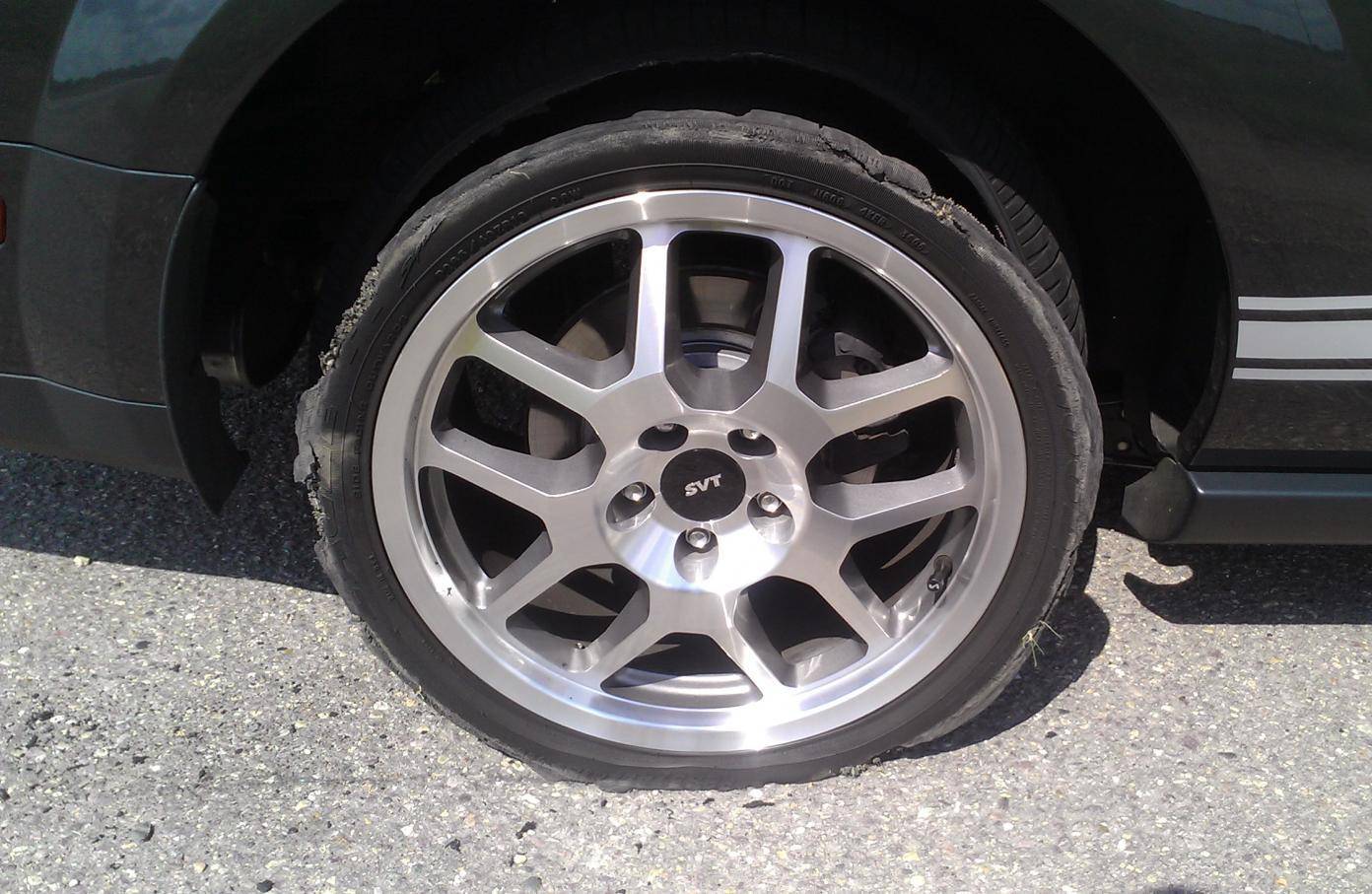

My former GT500, late on a blistering hot summer Sunday afternoon after a car show on a rural highway. No spare (thanks Ford!), no AAA, just the "mobility kit". Sidewall separation at highway speed. What a pain in the ass it was. No vehicle I own will ever be without a spare again, and it's the reason my '15 has a full size unit in the trunk.
Yup. Once you've lived through it (my 495 story was true and was also 75 miles from my house), the value of a spare goes way over the cost.
