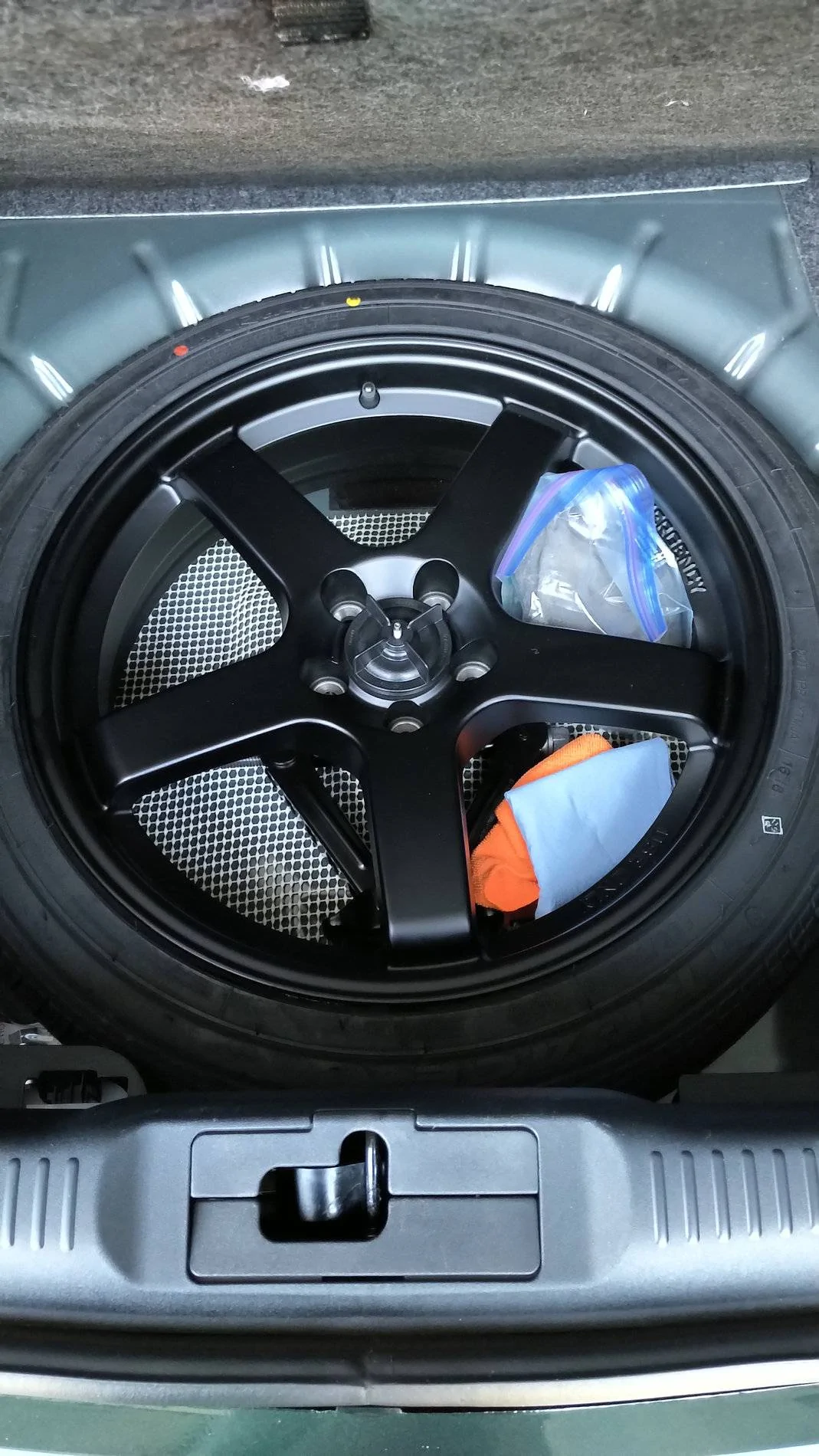

Have the AA spare tire and Ford OEM Jack. All fits nice an neat, although the trunk floor panel isn't quite flat, close, but not quite.

Yes you can put the factory jack under the spare but cover does not lay flat. There’s a significant bump which sucks. I put the oem jack in a small canvas bag.
FWIW, my trunk floor lays flat with the AA jack underneath the AA spare.
