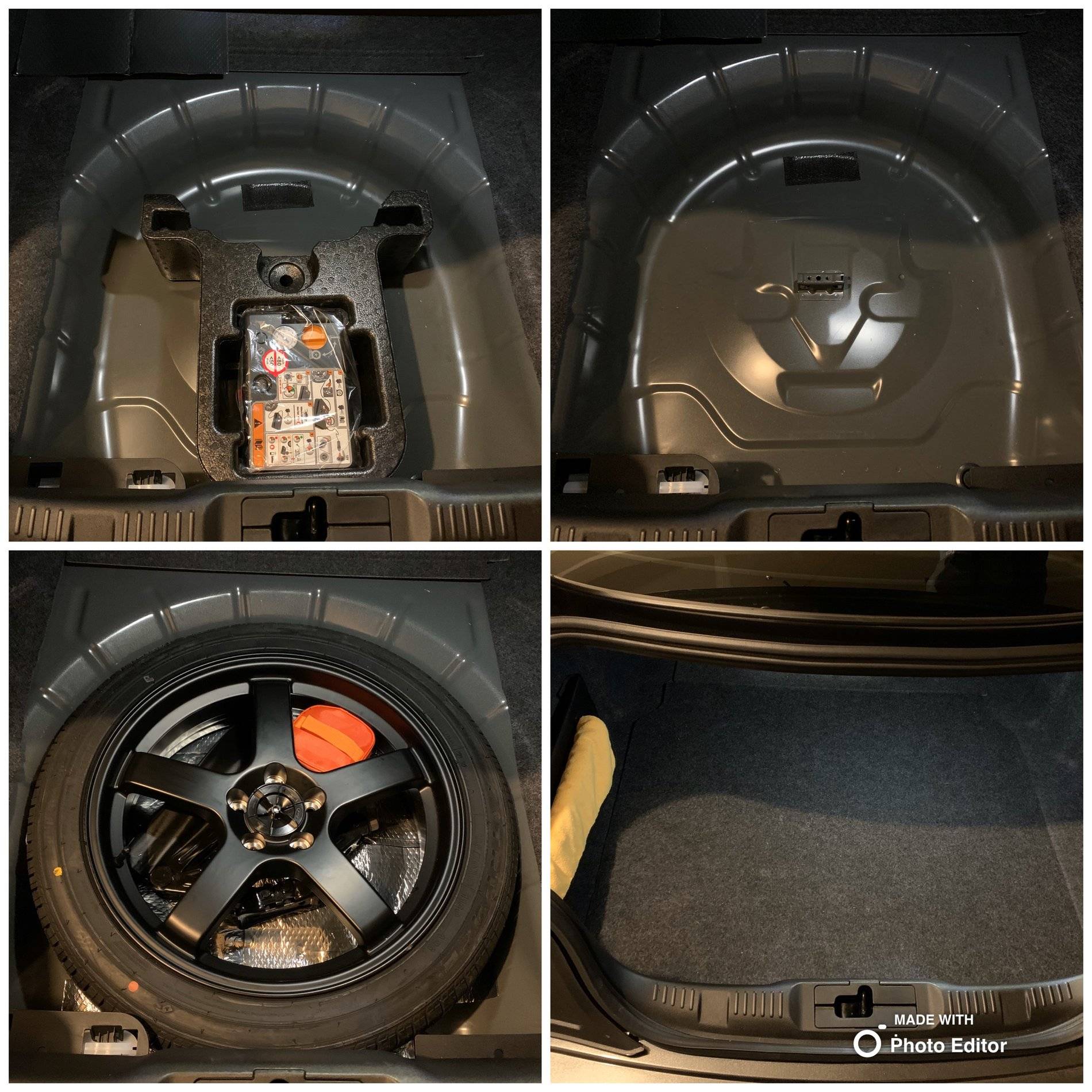

I went the AA route for peace of mind. Added some sound dampening sheets to the floor pan to reduce rattling and vibrations. Fits perfectly. I even added a roll up tool pouch with 150 ft-lb torque wrench, collapsible lug wrench and some extra tools beneath spare. And even fit emergency LED road flares too. Better safe than sorry imo.

My AA spare arrived a couple of days ago. Now, I need to locate a scissor jack.

AA was an expensive option but it’s a tight fit in the spare tire location and you have to relocate the jack. Only reason you need the AA spare is if you get a cut sidewall.
