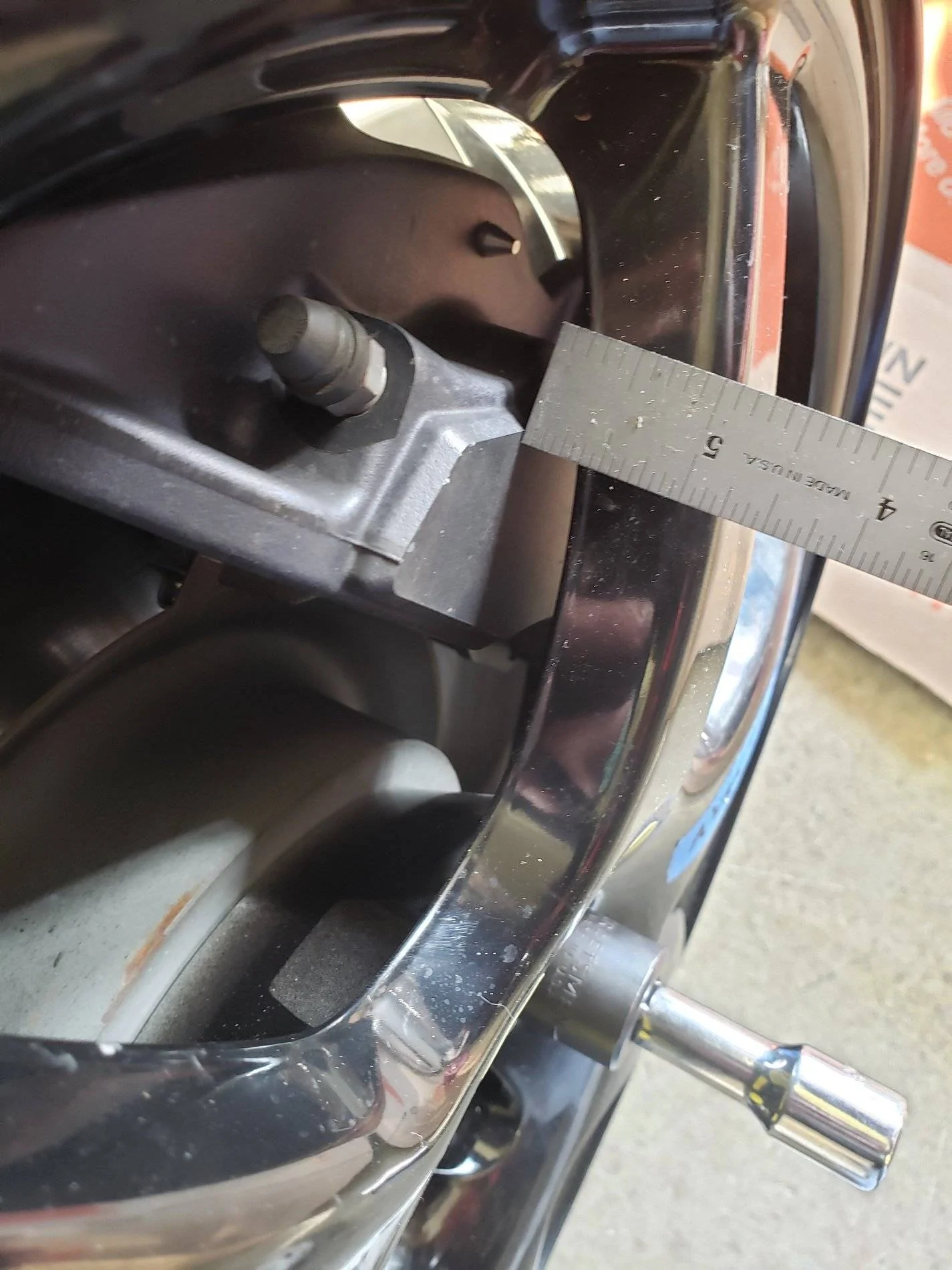

what's the clearance to caliper front face?
Sorry it took longer than I anticipated, life gets in the way of things and I work on the weekends.I just took a photo showing the clearance. Quite a bit, it's a lot more than I had with my Wilwood 6 piston BBK on my Fiesta ST.
