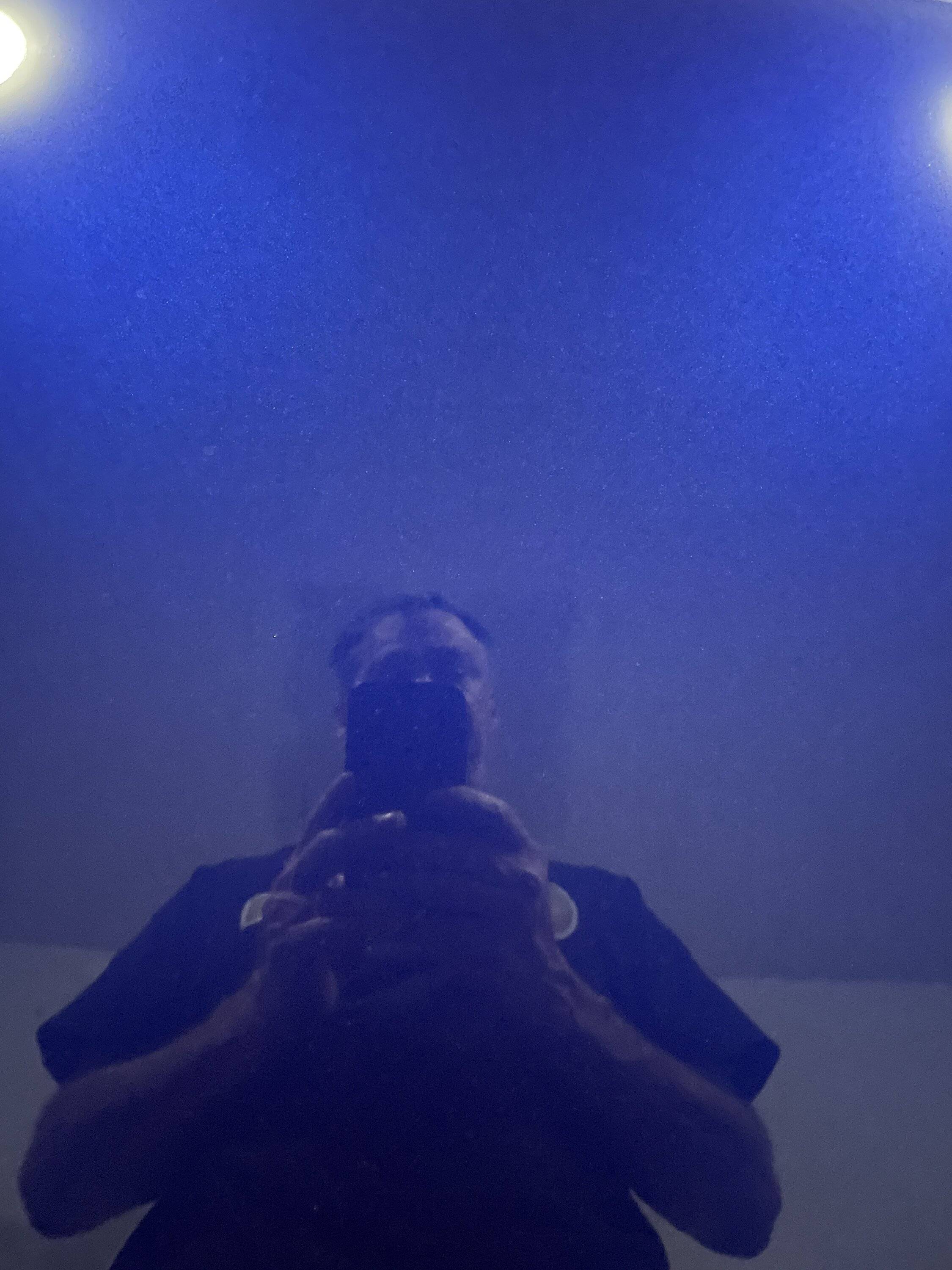

Didn’t get a good before but love gyeon pure on blue and red cars.
Paint was in decent shape so did a very quick paint correction and applied it.
will add bead maker after 24 hours, I think gyeon said keep it out of the elements for 12 hours.
