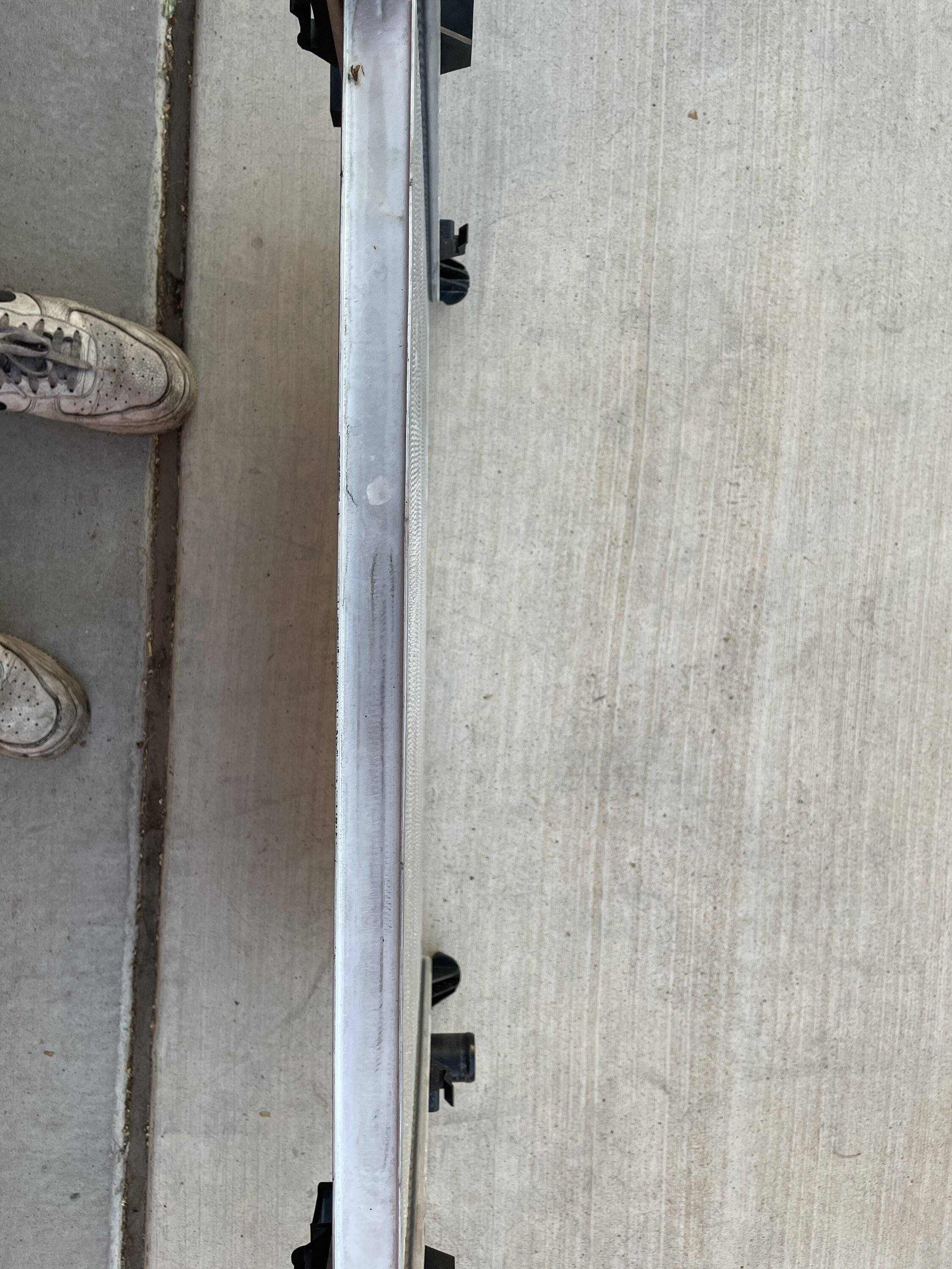

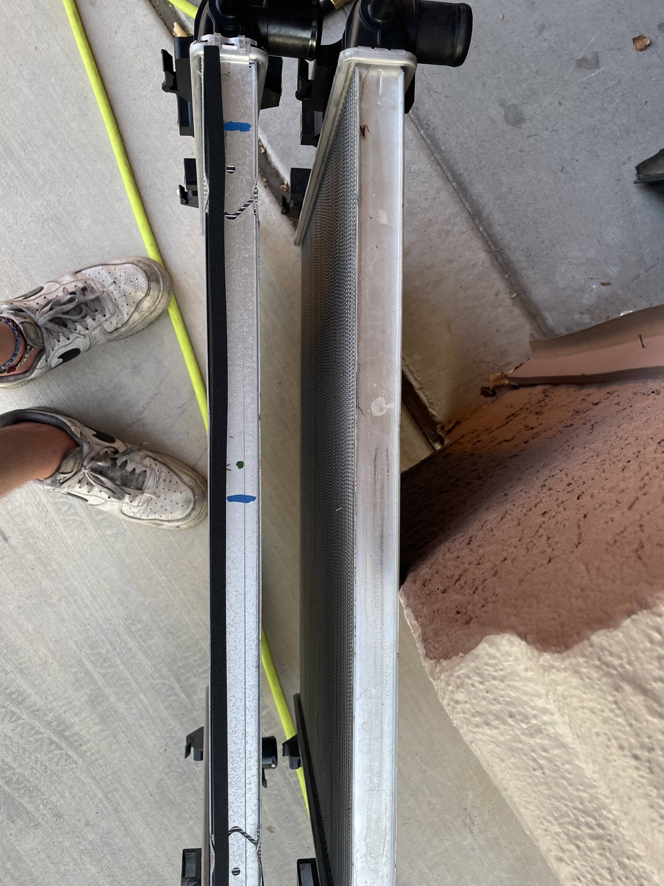

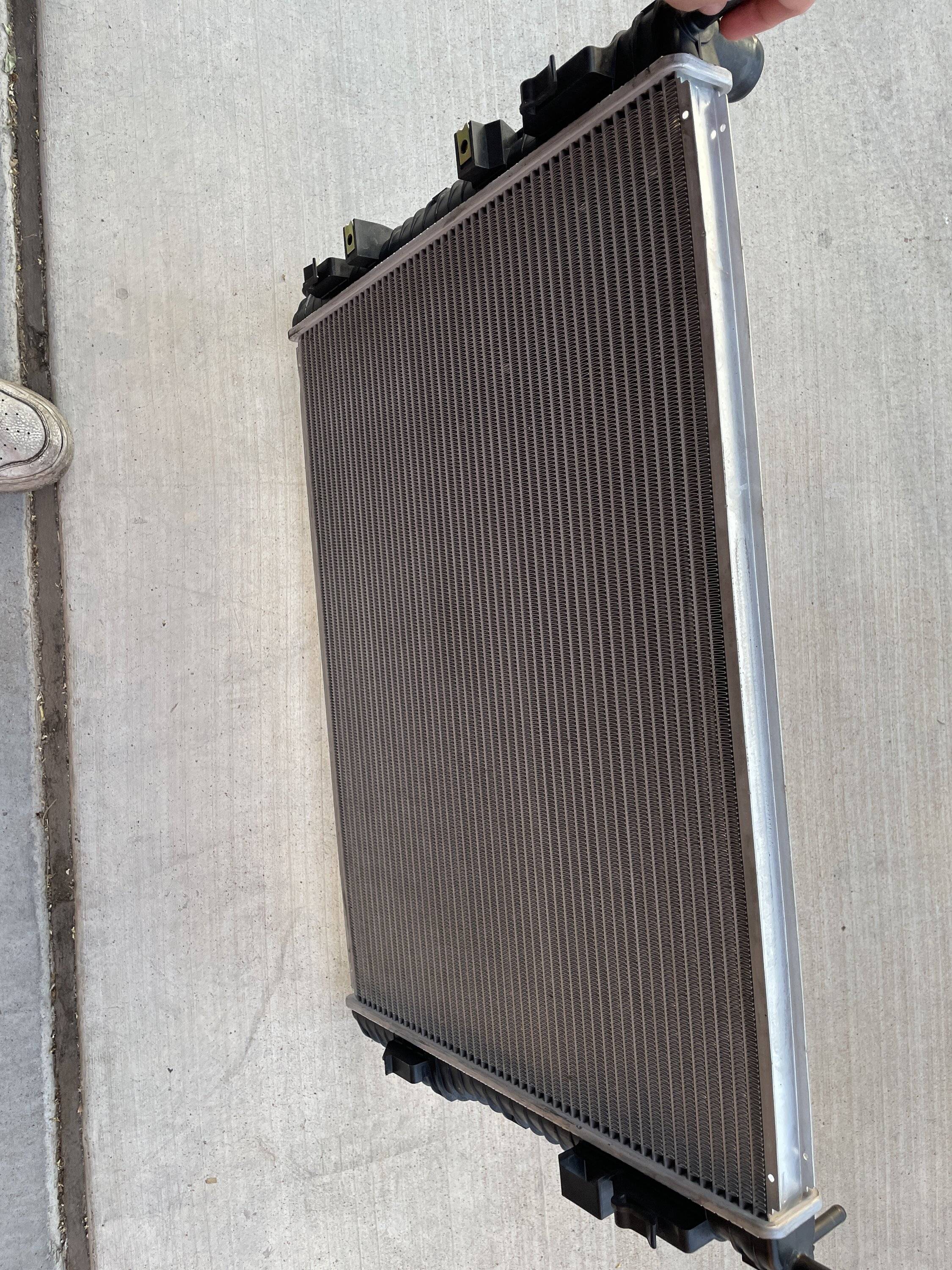

Also, the Performance pack radiator measured in at 1.45" whereas my old one (from carparts.com) measured in at 1.30". So not much of a change.
This just caught my eye.
PP = 1.450" wide
Non-PP should be 1.125"
Wonder what Car-Parts.com sent you @ 1.300" ?
Post a few picture of the Car-Parts.com radiator.
PP = 1.450" wide
could it be that they sent him an ecoboost premium radiator?
