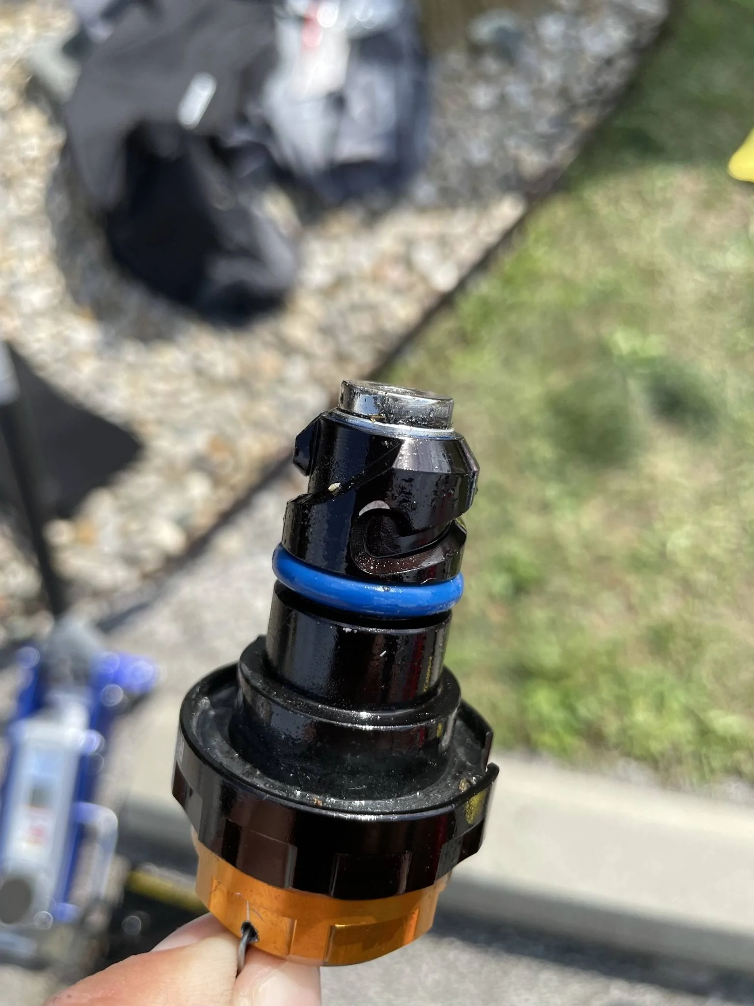

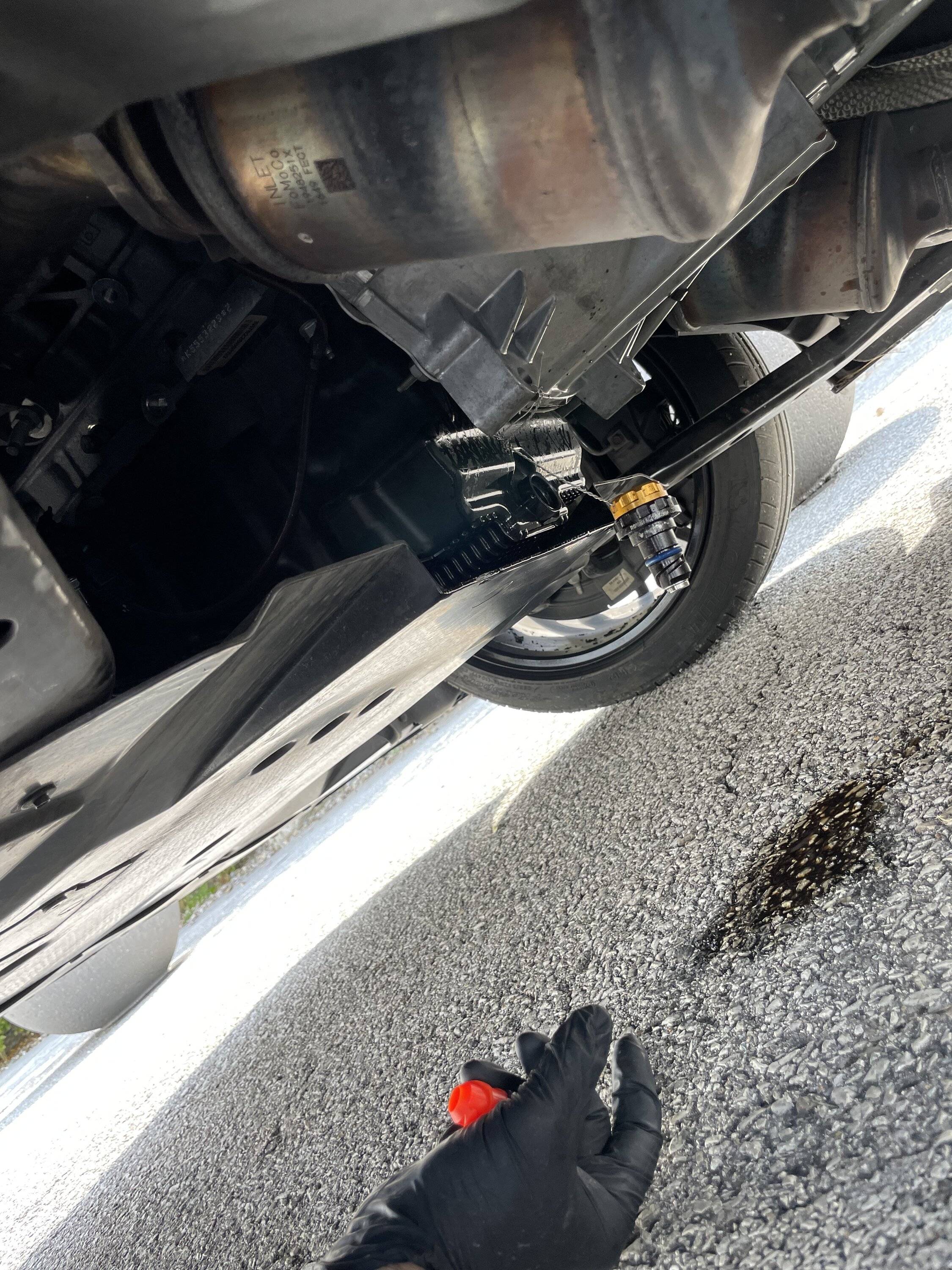

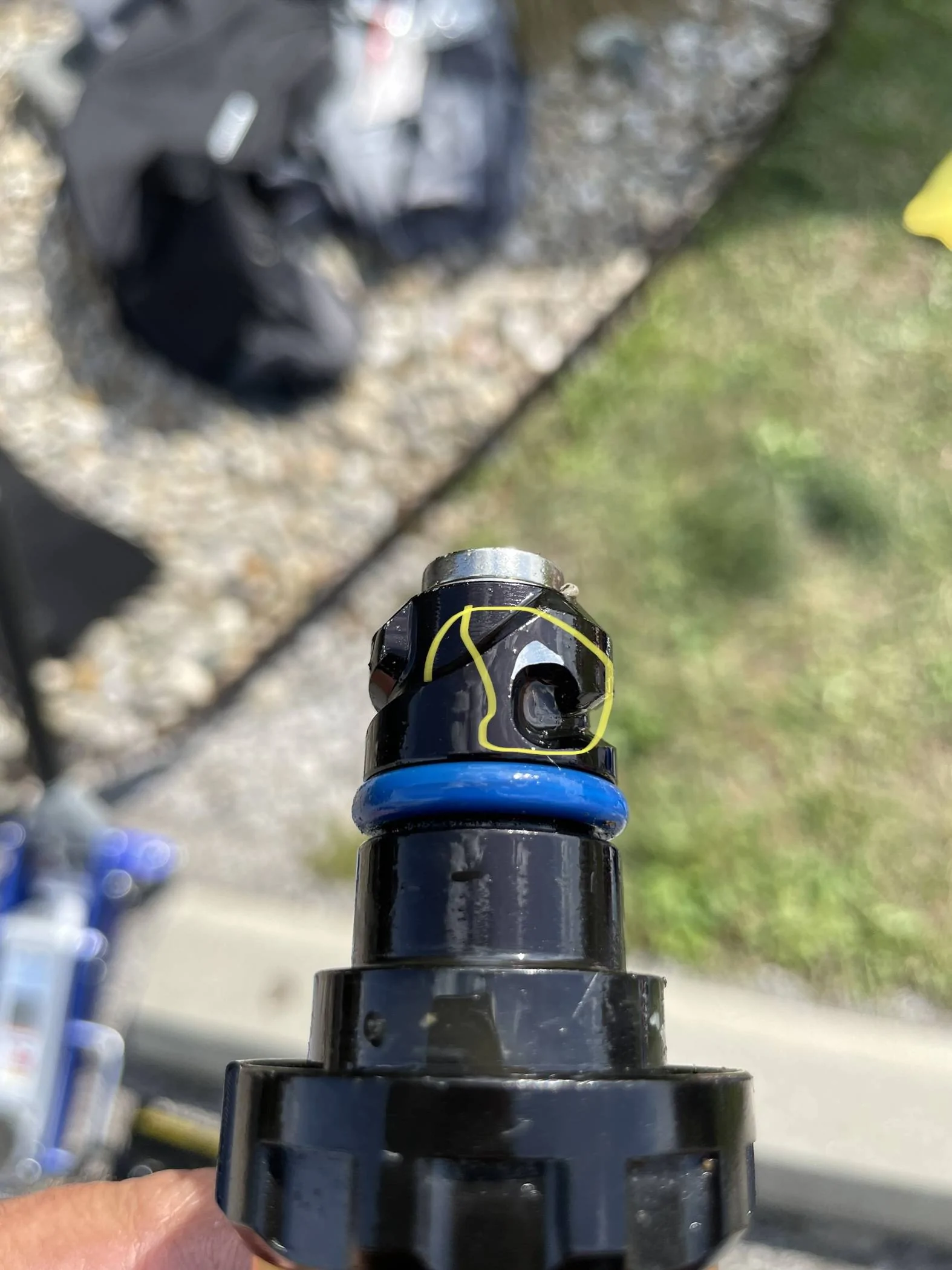

I felt the same way…. Right up until my ronin plug was ejected during a downshift while on track. I lost all 10 quarts. Luckily I got the engine shut down in time and saved it.
After posting about my issue, I had 4 different gt350 owners reach out and say they had identical issues with their ronin. Oh… and mine was safety wired as well. Here’s a pic of the plug hanging from the safety wire, lol. You can see where the plastic nubs in the oil pan sheered off aluminum as they ejected the plug straight out. It did not rotate while backing out. It also sheered off one of the plastic nubs in the oil pan, meaning it needed to be replaced. $1200 under warranty.
It’s been postulated that the resonance frequencies of the plastic pan and the aluminum plug don’t play nice with each other. That’s way above my pay grade though….

Sorry for your bad luck. I have a Ronin, and I safety wired to prevent lossening or ejecting. I am switching it to a UPR due to it seeps and the UPR is doubled O Ring. I have nothing against the OEM plastic ones except for the reasons I listed above. Even with the OEM, I would SW. Good Luck
