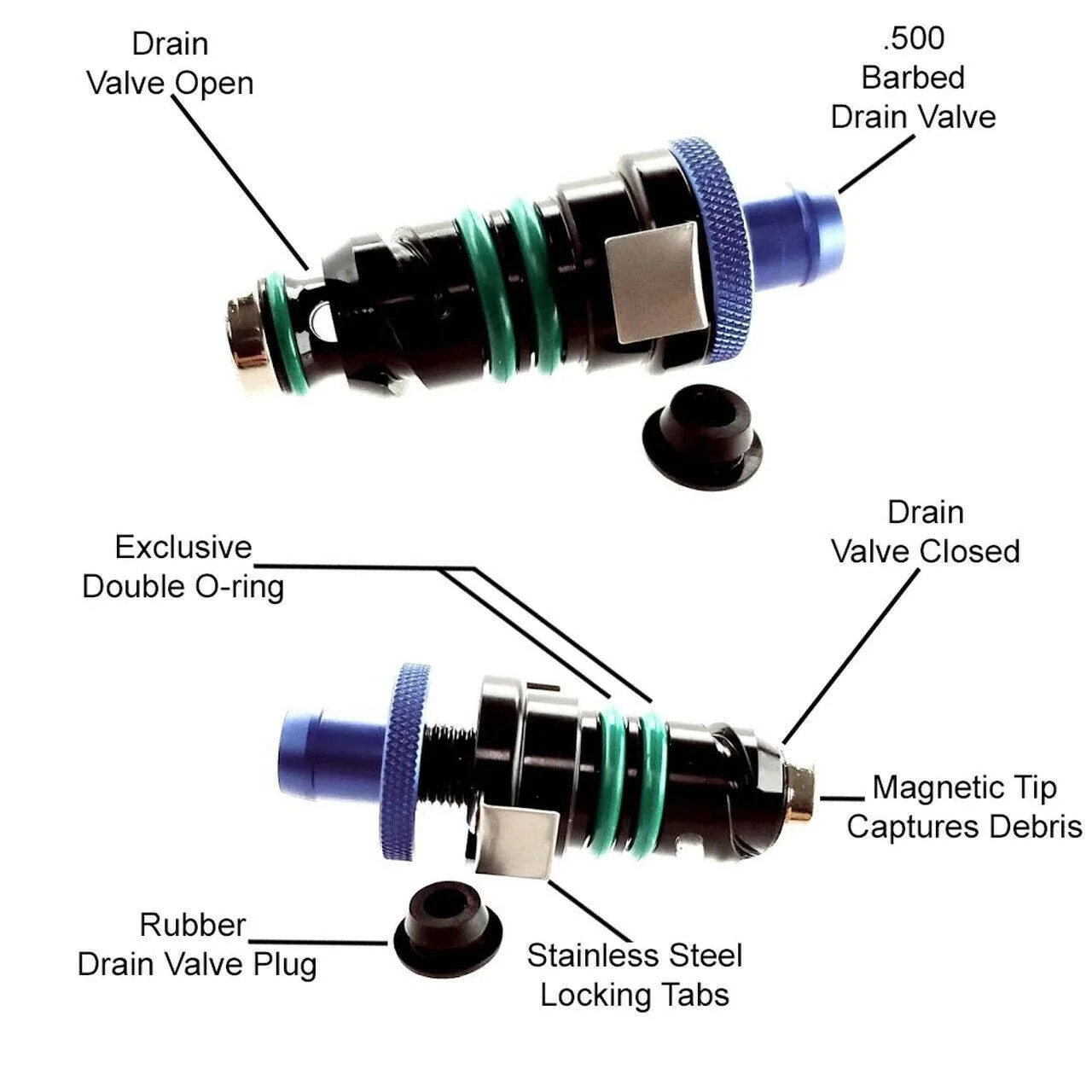

I installed a UPR 3025-02 on my first oil change. On that oil change My drain pan/container ran over because it was receiving more oil than it could drain into its container. Plus, I really don't trust the plastic plugs. The UPR plug I installed allows for controlled release of oil from the pan.

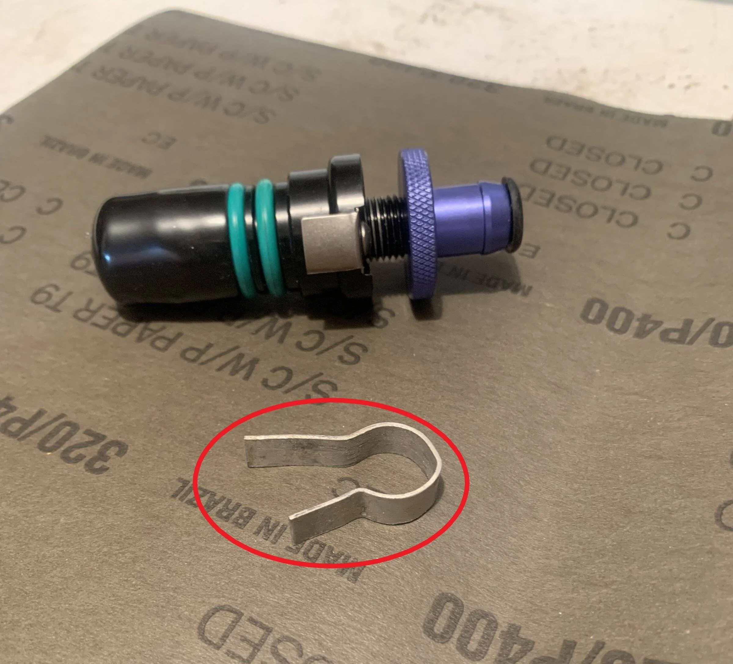

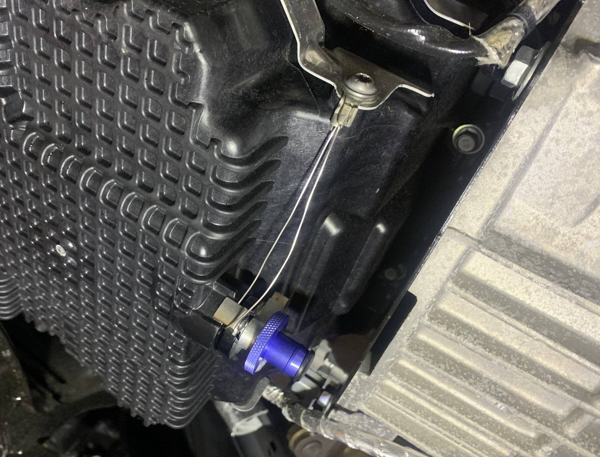

In addition, I added a safety wire to the locking tab so the base cannot unscrew. The moving part of the plug screws in to drain. This leaves threads exposed. The 'screw in' to drain plug also doesn't lock closed very well, so I trimmed and bent an aluminum "clip" around the threads. Now the threads are protected and the plug cannot be screwed in without first removing the clip. The third photo, below, shows the clip, it also shows the protective boot on the plug when shipped.

that was a great idea. think I will have to perform this mod to mine. once again, great idea!

I used the one you pictured, noticed the locking tab would cut into the pan some. I put the OEM back in.
