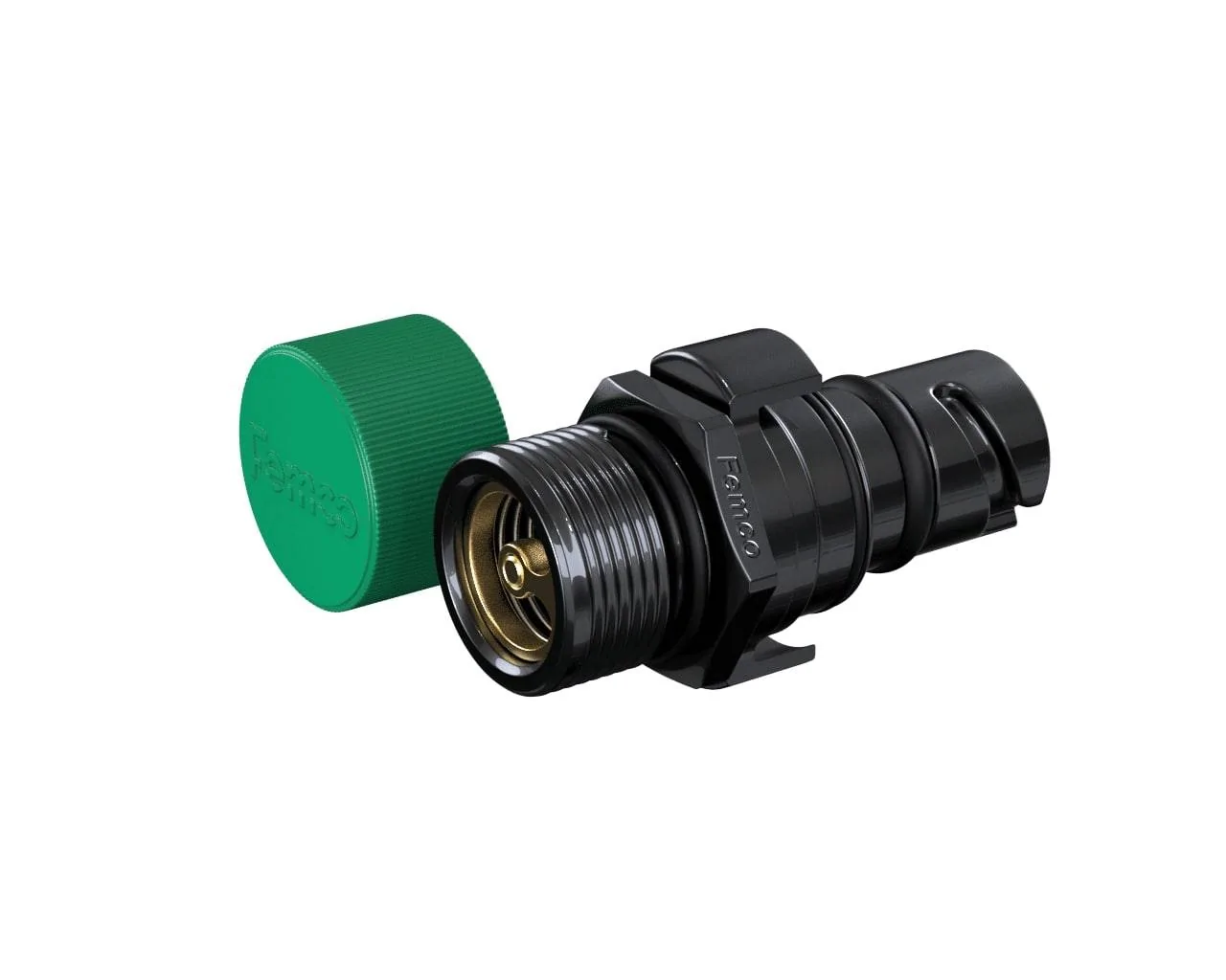

Installed the Femco 6420001 oil drain plug over the weekend that should drastically reduce the potential for messy oil changes.
When pulling out the original plug, oil quickly overfilled my large drain container…that 10 qts came out fast.
Pulling the oil filter was messier than anticipated as well even when creating a makeshift funnel under the filter. Looking forward to the 3D printed filter guide when it’s available.

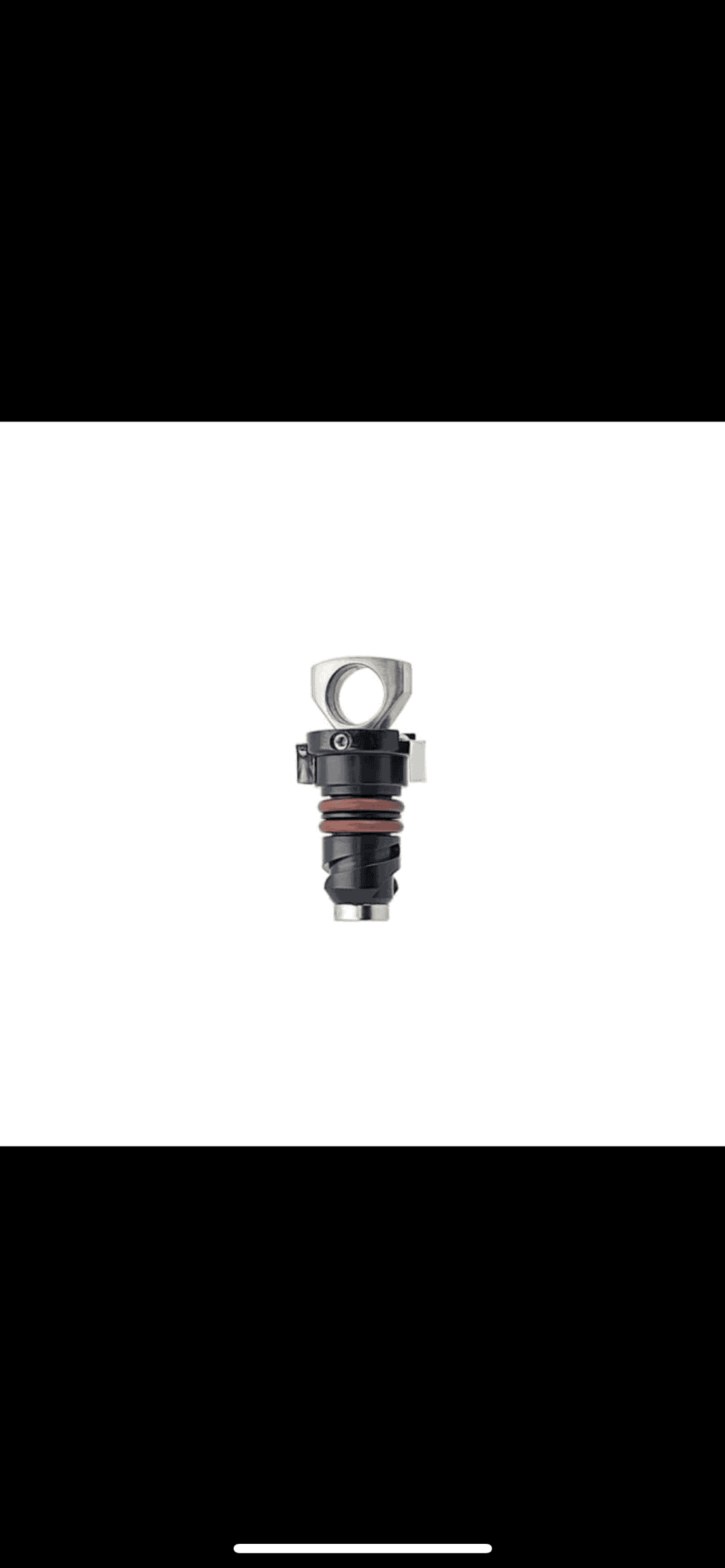

I just wanted to add this video to clear up the installation and removal of any UPR Drain plug or Drain Valve. We have thousands and thousands of Ford's running our drain plugs and drain valves and do not recommend prying the tabs, as for running over something and breaking or dislodging the drain plug is not something we've encountered.
We've seen many oil pan failures and plastic drain plug failures as we get emails about the tabs breaking from the pressure against the detents after being R&R's a few times. Mostly we hear about the leaks from the plastic drain plugs. That is why we moved to the new patented double o-ring seal.
Also heard about a handful of people that did not correctly tighten drain plugs in the plastic oil pans allowing them to back out or vibrate loose. That's the most common problem with the plastic drain plug and the exact reason we designed the metal tabs to bite into the oil pan to eliminate any chance of ever coming loose by itself.
We've been working on a UPR Gen2 Drain Valve with some updates I developed to simplify the design. The revision was for ease of use as we strive to improve our products, not because of any issues or problems with the first generation other than all the inferior copies forcing us to build a better mouse trap.
Check out the video, and you can see a walk-through on the UPR Drain Valve.
UPR Ford Easy Oil Drain Plug Valve.
Gloves are much better when installing or removing the UPR Drain Plug or UPR drain Valve so you can grip the metal tabs and turn them past the detent lip in the pan when removing. Allowing you to remove the drain plug without prying the tabs. (Prying the tabs is not recommended as they are designed to withstand daily operation over and over, but not to be pryed.)
Note: the UPR drain valve will not open or vibrate loose and does not need to be cranked tight to close you just snug it closed, and the detent and o-ring keep it secure. Just make sure you close it completely before refilling it with oil.
This is purely an informational post to explain the design and function, so everyone knows exactly how the UPR Drain Valve works. Thank you, and please PM me any questions or requests, or you can directly contact us through [email protected] as he's very knowledgeable and can always help.
Not here to flame or debate anyone, just wanted to share this with our fellow enthusiasts. Yes, we offer an unconditional lifetime warranty against manufacturer on all our products as well.

My plug must be the generation before the easy drain valve, it has a hole in the sliver handle.
I've had mine for about 14 months and 2 oil changes without issue.
Do you have any reports of my style having problems?
