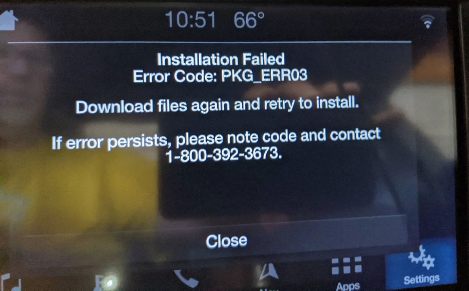

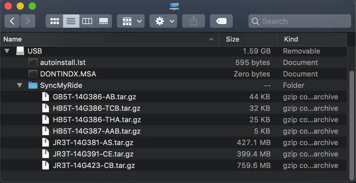

So my issue (now solved) may be Apple Mac specific. When I originally downloaded the 3.4 zip file, my Mac immediately unzipped the file. I ended up with 7 files and no folder named SyncMyRide. The 5 files that should have been in that folder each had SyncMyRide\ appended to the file names. When I tried the USB this morning, I immediately got the Error 05.
This afternoon I created the SyncMyRide folder and moved the 5 files into it. I then renamed the 5 files by removing the SyncMyRide\ from the file names.

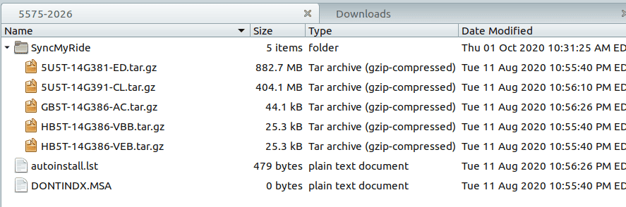

I get the same problem when unzipping on linux.
The files in the zip are named "SyncMyRide\5U5T-14G381-ED.tar.gz"
I renamed the files and put them in a folder named SyncMyRide so the folder structure looks like this:
Same as it does on the Ford website:
However, the car gave an error.
Installation failed​
error code: PKG_ERR03​
download files again and retry to install​
I downloaded again. I verified the files were the same with a MD5 hash. The hashes match.
Code:
> md5sum 5U5T-14G381-ED.zip
2ccf0758398139768f69200e747db5c9  5U5T-14G381-ED.zip
> md5sum 5U5T-14G381-ED-1.zip
2ccf0758398139768f69200e747db5c9  5U5T-14G381-ED-1.zip
I tried again with a USB 3 stick and it said it wasn't recognized. Both are formatted with the exFAT file system.
There are no log files on either USB stick.
Going the WiFi route, it seems to be stuck on "Searching for Updates"
Just spinning and spinning...
Code:
I would find a Windows PC and use that for the download / extraction
