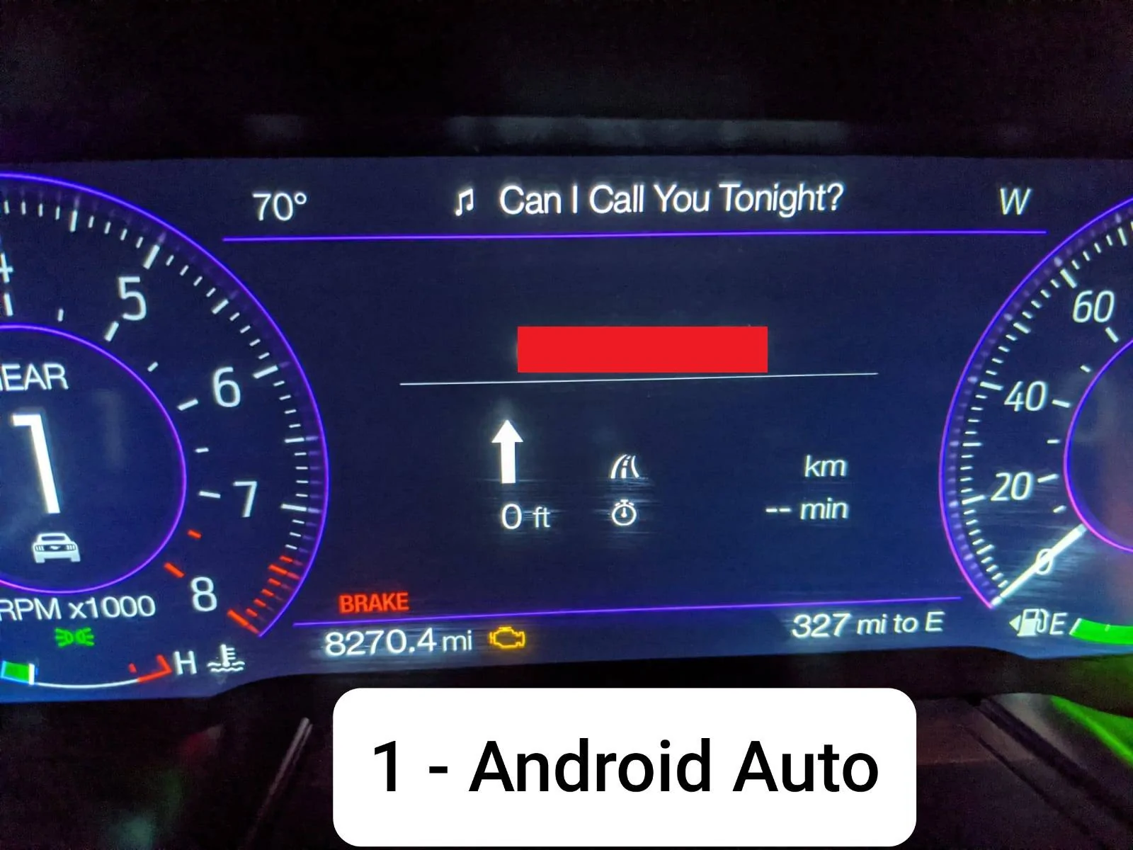

I have my AA plugged in most of the time. Do you ever get the error of "-- km" and "-- min" for distance left/time left in your cluster when in Waze or Google Maps? I can't seem to get rid of it. On factory nav it shows distance left/time remaining properly.
Most issues reported with AA and SYNC3 are 95% with AA. What is your current AA version? If outdated, try to update to the latest. Also try different cables.
My version is 5.6.603444 for AA, an update from 09/04. I've had this issue for weeks now though, pretty sure before then.
