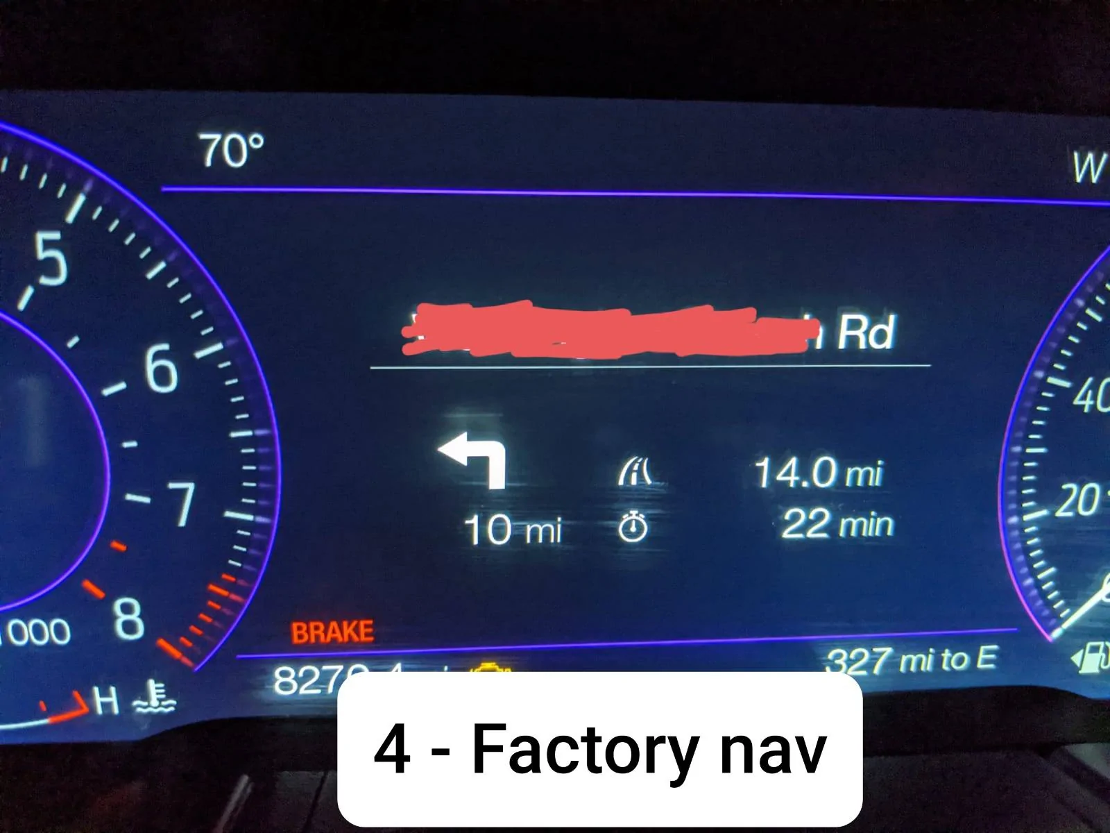

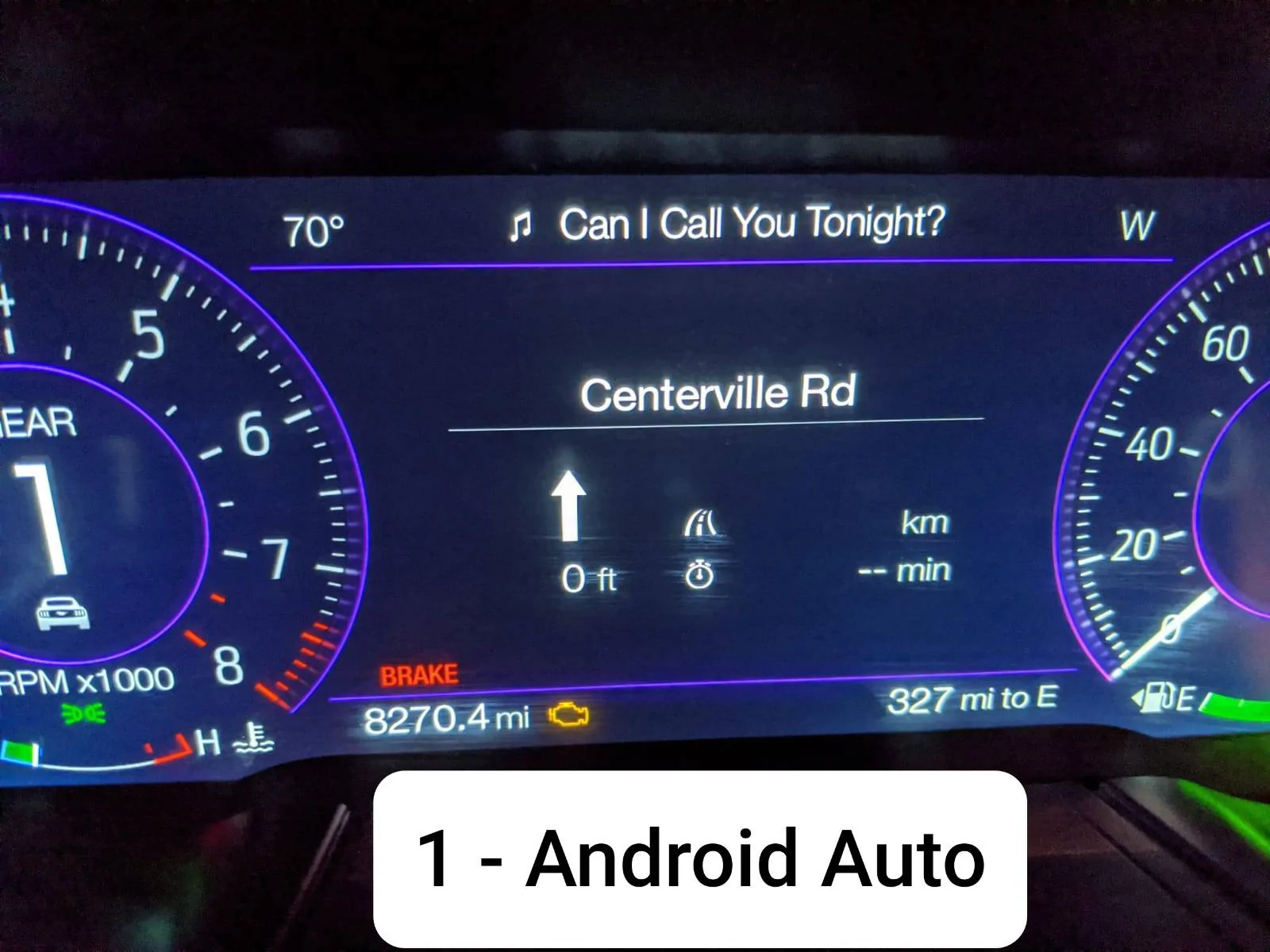

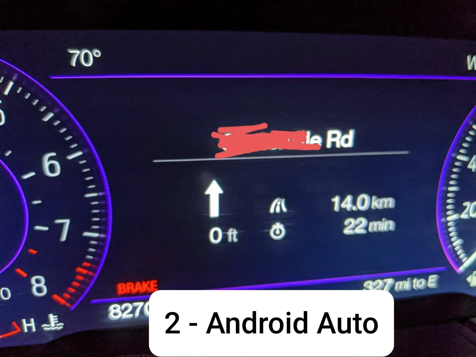

Have just completed a 1,000-mile each way trip with my Bullitt (a comfortable breeze really). I've always relied on Google Maps (as it has my favorites etc saved), but it was unable to give me an automatic bypass of a 2hr accident delay. Kind of like "oh well, this is still the 'fastest' route," even though the built in nav and Waze immediately found a bypass, saving me an hour. With Google Maps I had to manually drop a pin at first. Crazy.
Anyway - in-dash Android Auto - do you guys have a similar issue, where it does show turn and direction (i.e. 5mi to the next turn), but shows -- for total distance and time left? In addition, despite my dash and AA being in miles, it shows "-- km" for remainder of the trip. Anyone else?

That's a picture od your dash with stock/built-in nav, right?
My Android Auto/Waze doesn't give me that decreasing bar until the turn or the total trip distance left...
Have you tried putting it to the normally blank screen in the trip/mpg screens?
Yes, I have. See my attached pics:
1 - Android Auto on the main/blank screen (running Waze this time, Google Maps is identical)
2 - Android Auto again - here you can see that i was able to snap a pic of when you start navigating, for a second it flashes the right number, but wrong units (compare to #4, I had same destination, should've been 14mi, not 14km), time correct. But then it disappears within like a second, see #1!
3 - This is what it appears like on a shared screen with trip computer.
4 - Factory nav, working correctly.
Basically this is the "-- km" i was talking about. For a second, Android Auto (whether Google Maps or Waze) flashes right number + wrong units and then immediately goes away.
The little filling bar countdown till turn i get only on factory nav, but i think that's normal.
