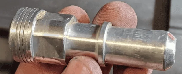

Gee, maybe I should just feel fortunate that "Mint" Auto Sales of Orlando, Florida did not charge me extra for the big-ass nozzle I found at the top of cylinder three's valves under the intake manifold. It is quite fancy.

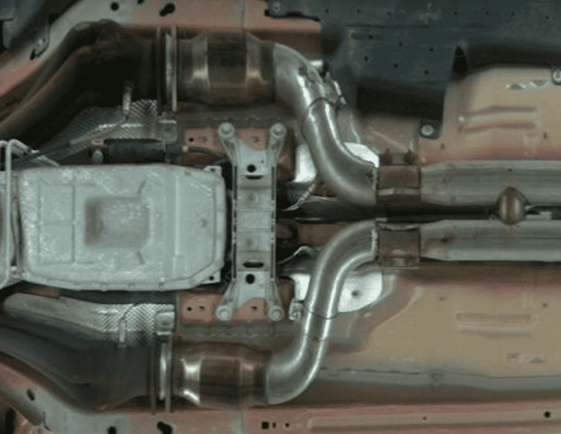

Regarding this statute: I believe the crux of it is that there are still O2 sensors and two cats installed and visually undamaged. That means by this statute there has been no "tampering". If there were no cats or ones that looked damaged or broken/mission O2 sensors, that's different.
I was asked if as far as I knew, did the car have an exhaust system with no leaks, with O2 sensors and catalytic converters, was there any obvious physical damage to them and were there any emission-related engine codes. I answered it truthfully that I was not aware of any leaks, there were two aftermarket hi-flow catalytic converters with O2 sensors installed upstream and downstream of them and appearing to be connected. This satisfied the part about not being tampered with and also the statutory requirement of (1)(a) and (1)(b) because the cats and O2 sensors are there and visually undamaged. But it doesn't guarantee that they are functional. I did forget to say anything about the pending codes that came up one time because of the long-tube headers. Sounds like that code is a given if you use long tubes.

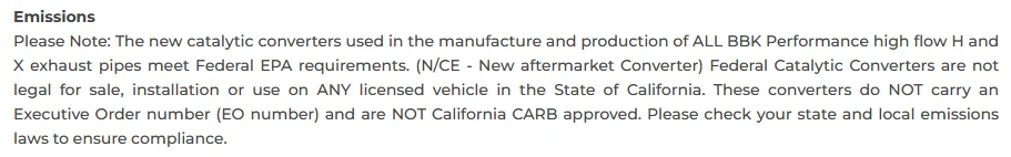

I think the catted mid-pipes are from BBK and they say this about their cats:

Stuck rings or sticking valves has been offered up as an idea. As has cylinder damage, valve damage caused by the nozzle bouncing around between cylinders under the intake for an unknown length of time, over-boost damage, head gasket damage, warping due to overheating, other malicious causes and voodoo.

My takeaway was that the car has cats (aftermarket) and O2 sensors installed and visually undamaged so they do not meet the definition of tampering. As long as they are there and look in good nick, that's all that's needed, no statutory violation. This does not imply any type of warranty that they actually work or will pass emissions.
