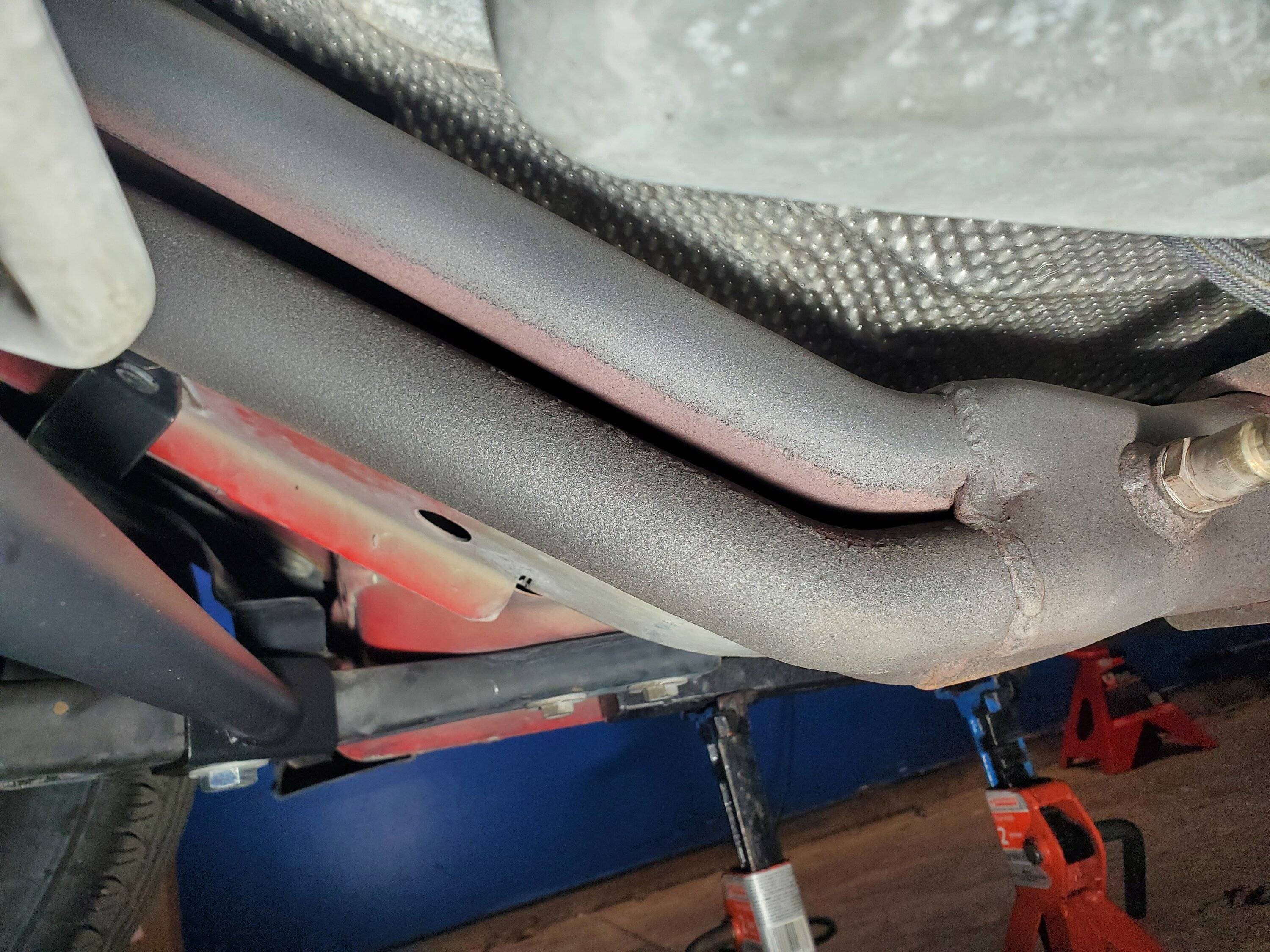

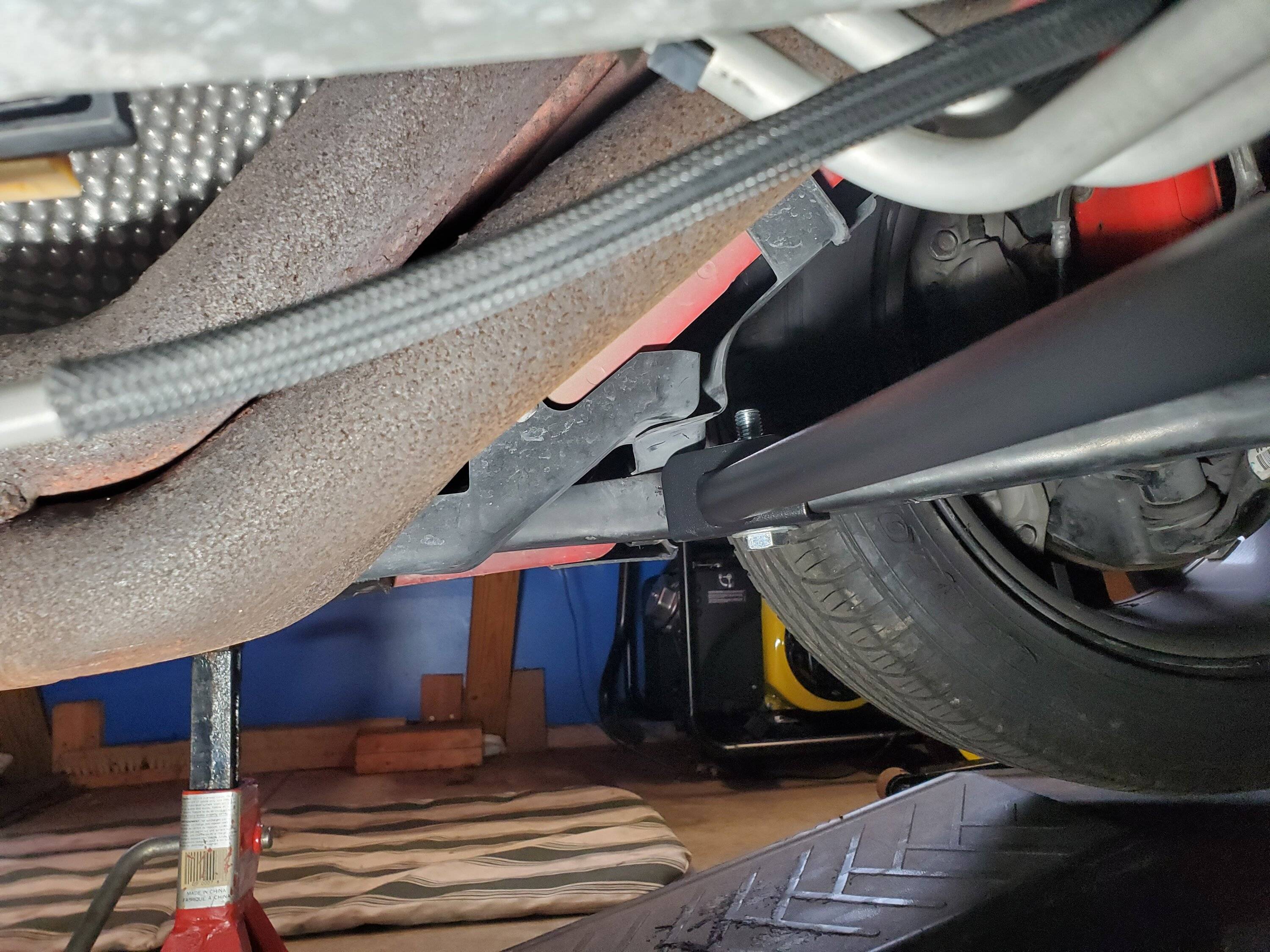

Santa did end up bringing me a Steeda Extreme G-Trac K-Member Brace for Christmas. It installed just fine with the BBK long tube headers in place. The biggest challenge was getting the compression cylinders located inside the frame when mounting the rear bolts. I ended up having to grind about 1.5 mm from each cylinder to get them to slide in place. Other than that, no real issues. Now I have to see if I can return to CJ Pony Parts the brand new, unopened Steeda Ultralite 2-point G-Trac brace I bought after Steeda told me the Extreme brace would not work with the long tube headers. I'm glad Santa did not know about this potential fitment issue with the Extreme brace and brought it for me regardless. Santa for the win!
Whilst under Oliver installing the brace, I found a few new things to address. There are only two clips holding the passenger side rocker panel in place where there should be about 10 of them. I ordered the Christmas tree style clips to get this properly mounted back in place.
I also found something strange on the bottom part of the fender liner on the front right fender. An opening about 2 inches tall by 8 inches wide has been cut off the bottom of the fender liner at the rearward part of the liner. I can only assume the previous owner did this to run something through the bottom the fender liner. What, I don't know. Oh well, nothing some 2-stage epoxy and spare plastic won't rectify.
The engine still seems to be running well. No check engine lights, misfires, overheating, hard starting, etc. I still have the low rpm metallic vibration but have not yet found the source of it.

Lots of room between the Extreme brace and the BBK long tube headers. The headers are rather sad looking. Maybe 7 years in the humid southern Florida climate is as hard on them as it is here in NE Wisconsin.
