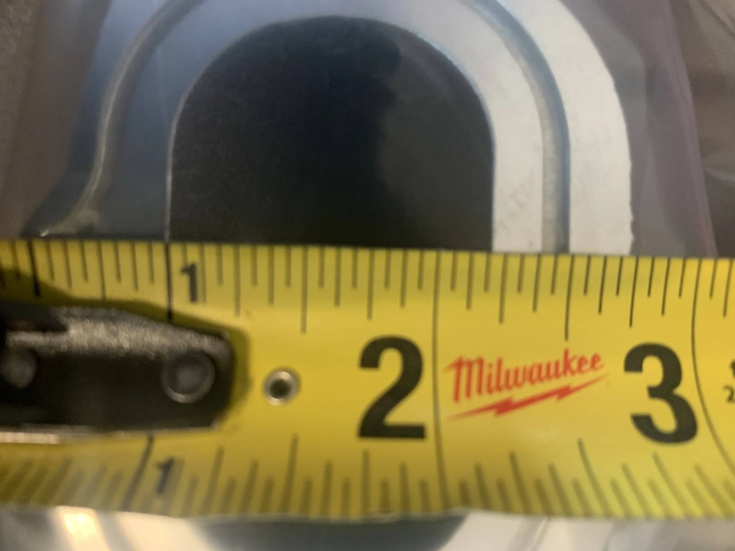

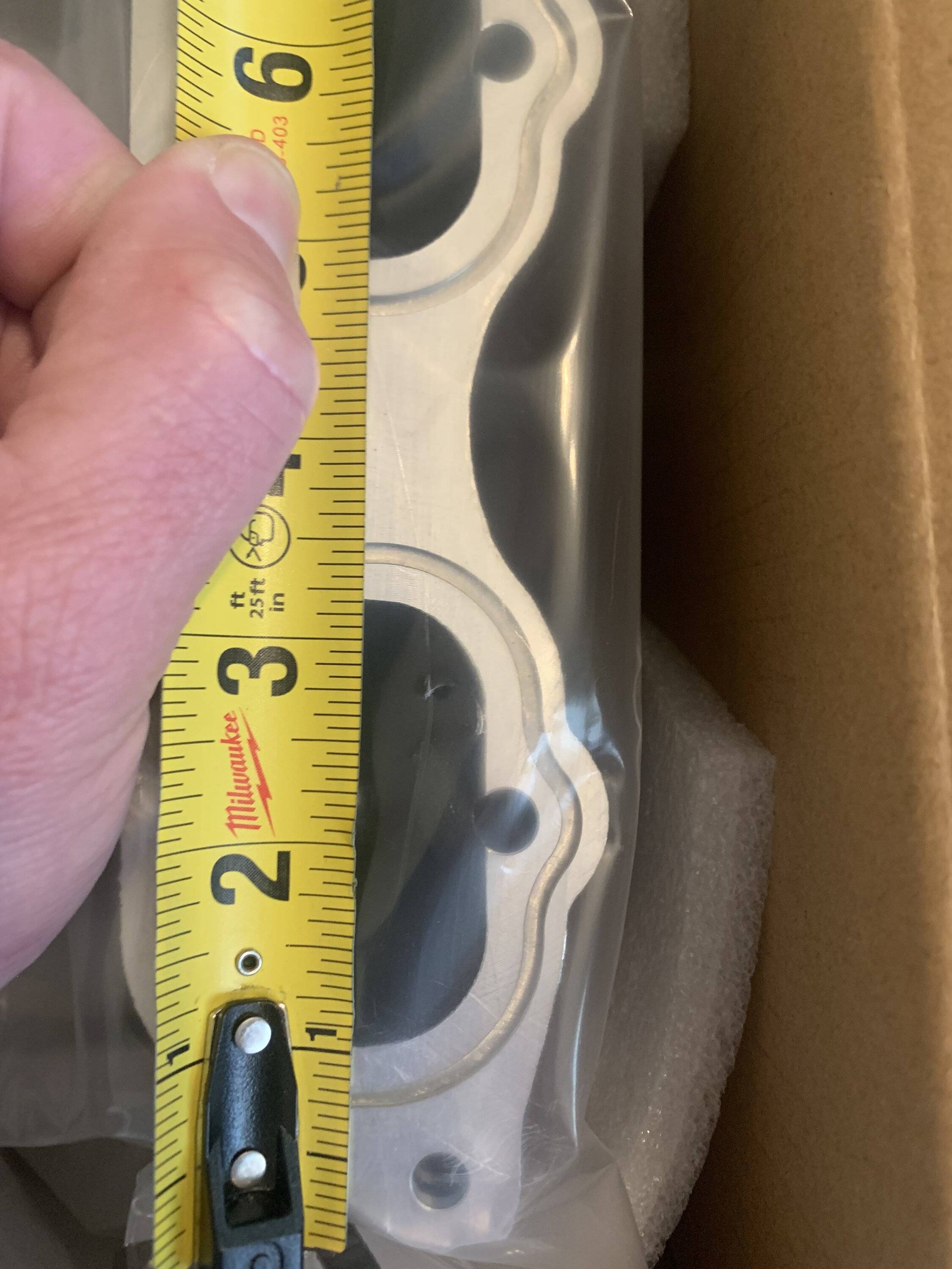

300-912 low-ram arrived. Attempting to be ready for Friday dyno...
Port measures 1 3/16 x 2 3/16
Those ports are smaller than a stock 15-17 manifold.

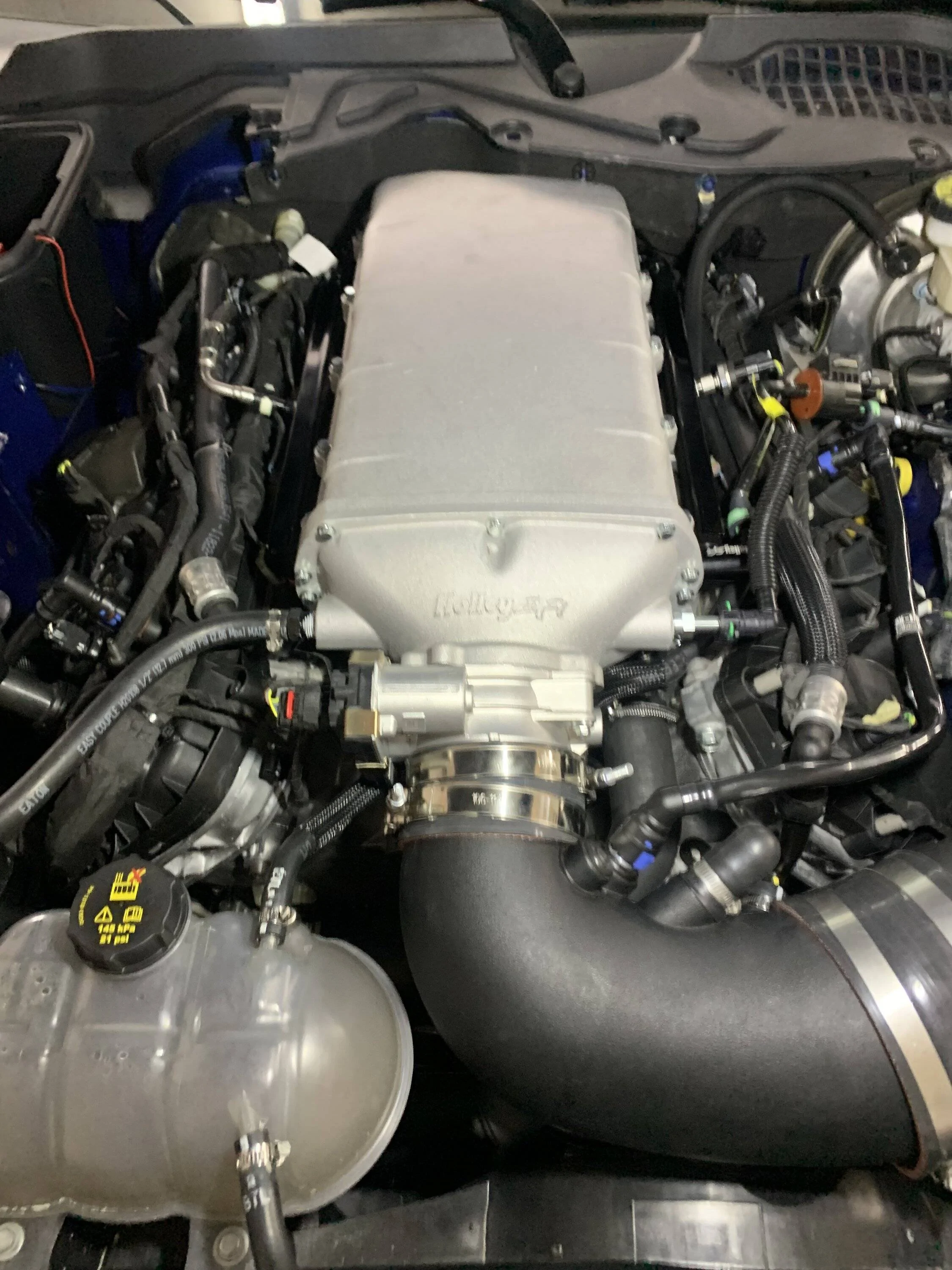

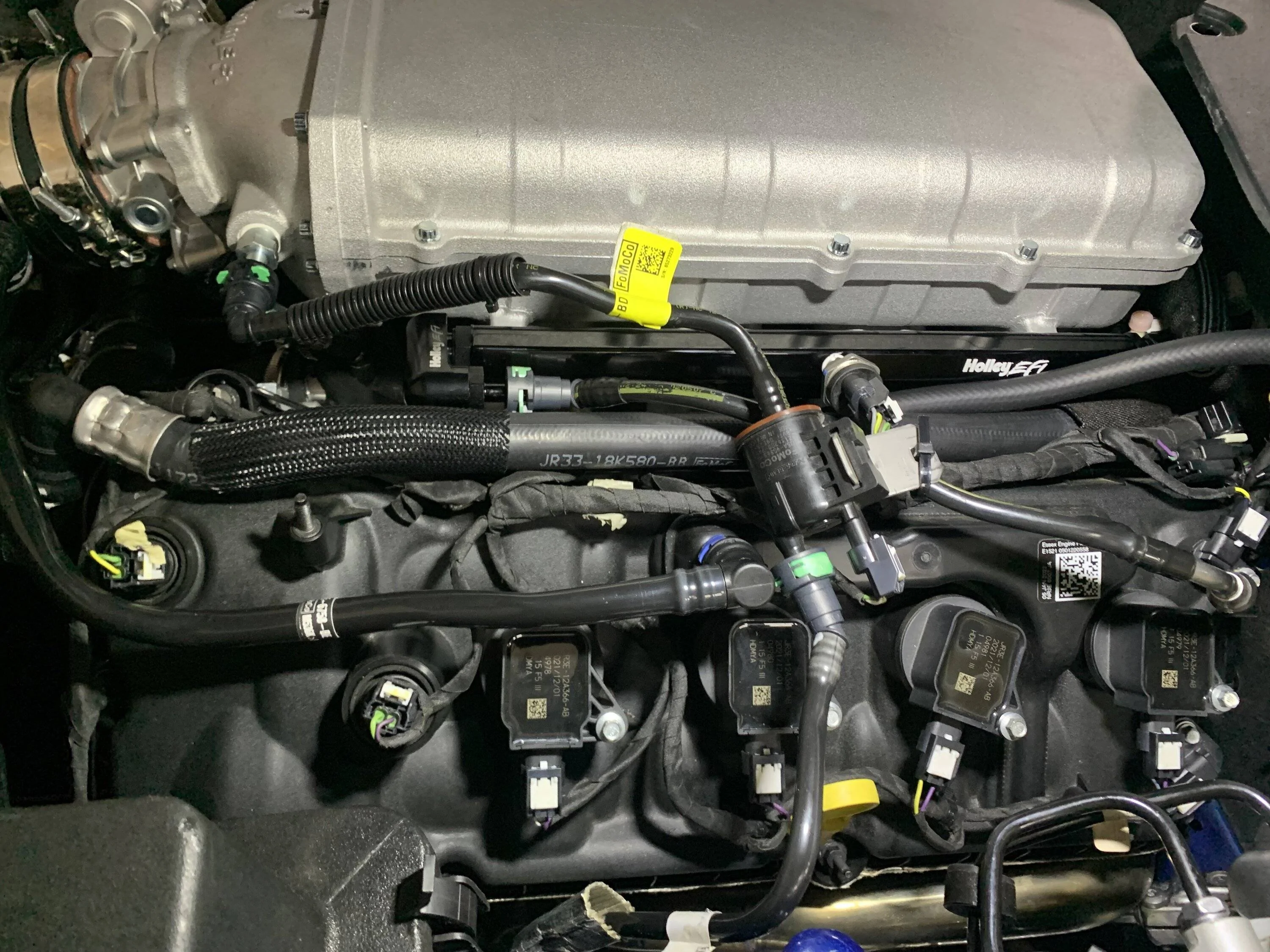

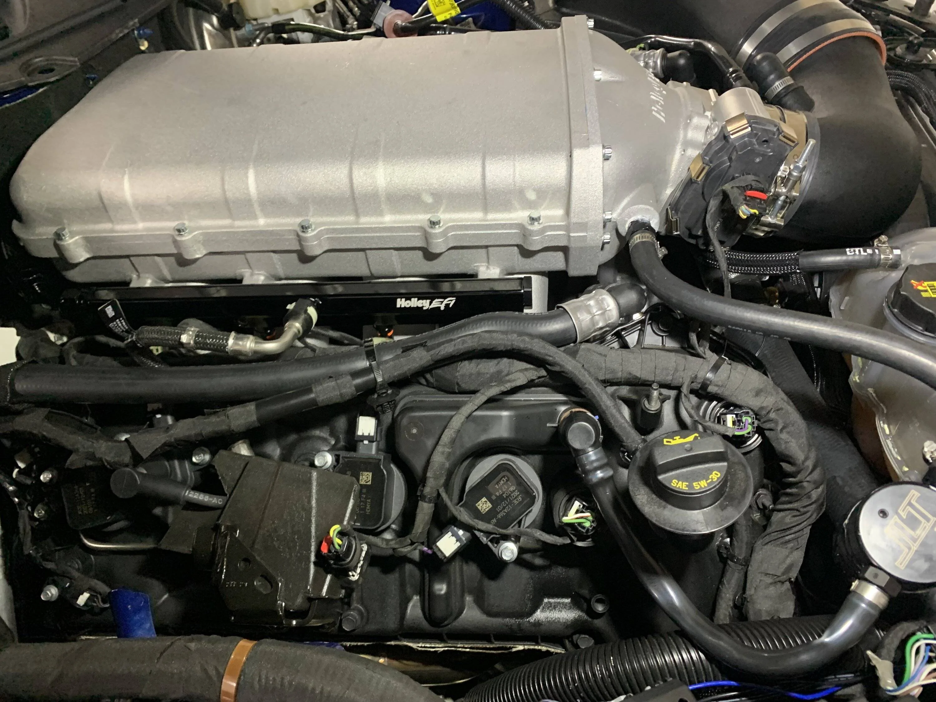

Seems like all is installed correctly but I"m getting a no start. I'm the tuner.

Did a quick log, trims look roughly the same. I don't necessarily expect the fueling to change due to the manifold. Planning on dyno Friday.

I've done cams and manifold since the last build. I thought hard about re-dynoing the cams before I put the manifold on for science but dyno $$ and time don't allow. I'm going to get the combo done and racing.
This dyno will be the Holley/Bullitt TB + Comp cams & valvetrain /electric water pump/little freer exhaust vs. Previous FBO on ethanol that was about 475rwhp.
