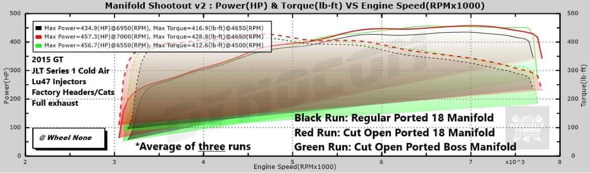

One of my next projects might be opening the plenum of the gt350 and porting that, runners are already ported as it sits. Recent dyno testing from Billy Kessel showed that opening up the plenum and porting the runner inlets on an 18 brought the power up to match a race port boss, still falling off at 7400 where the Boss carried to 7900 but was worth like 30whp over standard ported 18

I do my own porting so I’ll handle it. Did a race port boss and made a few mistakes on the reseal but I learned from that and have a much better method to go with now. After seeing Billy’s dyno testing, I’m quite hopeful it should be a nice gain.
Edit: snagged that dyno graph from his FB post. I misquoted his gains but still significant

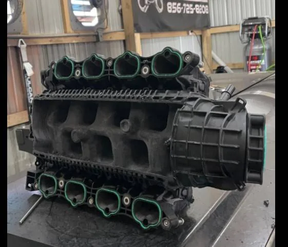

This is one of Billy Kessel's photos. AFS and Purgatory do the same thing with Boss/CJ manifolds, just on the top.
One thing to think about too is with the 18 and 350 pieces, you'll never see the reseal job. You can make it look totally normal installed, grudge racer style

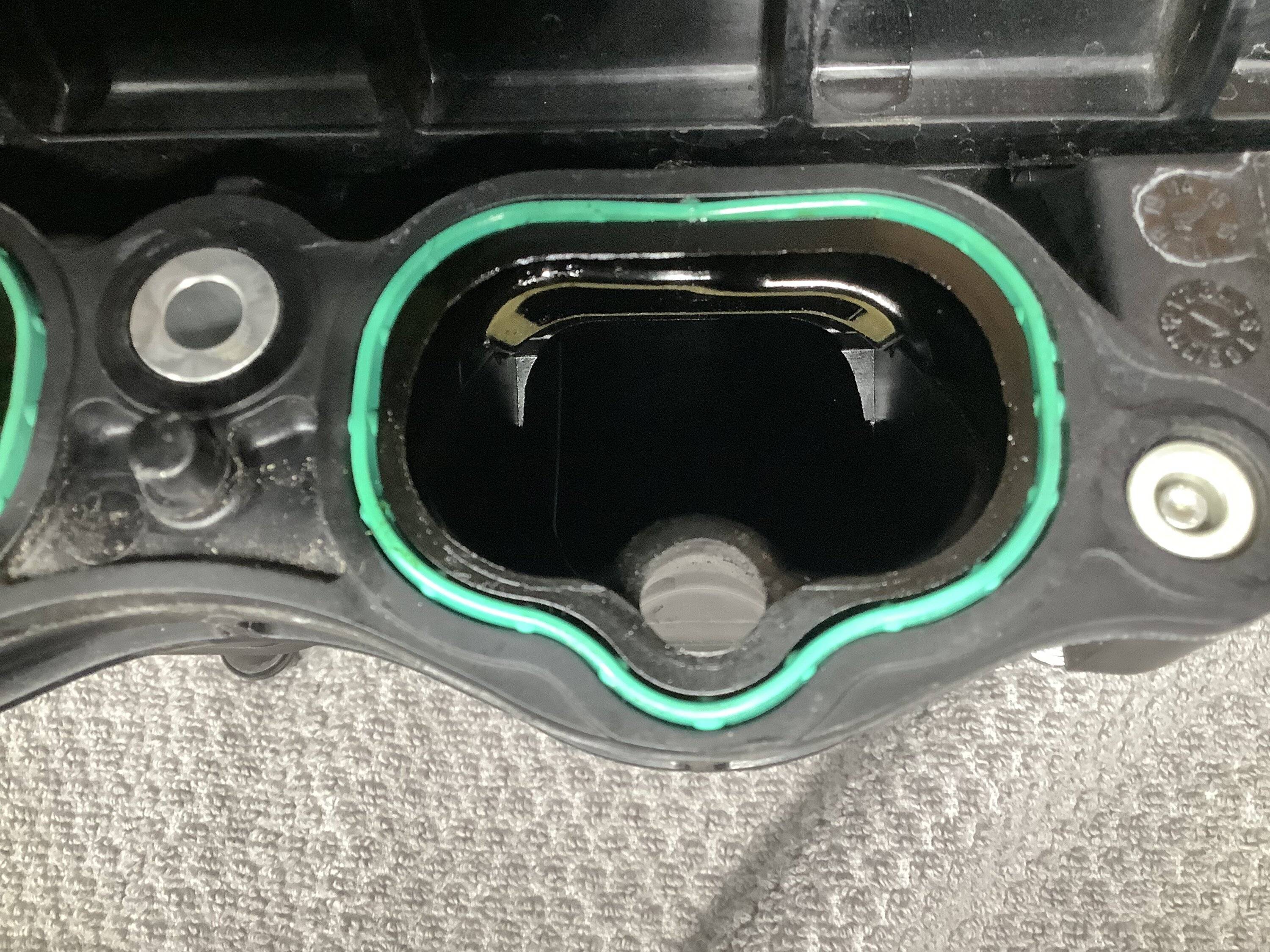

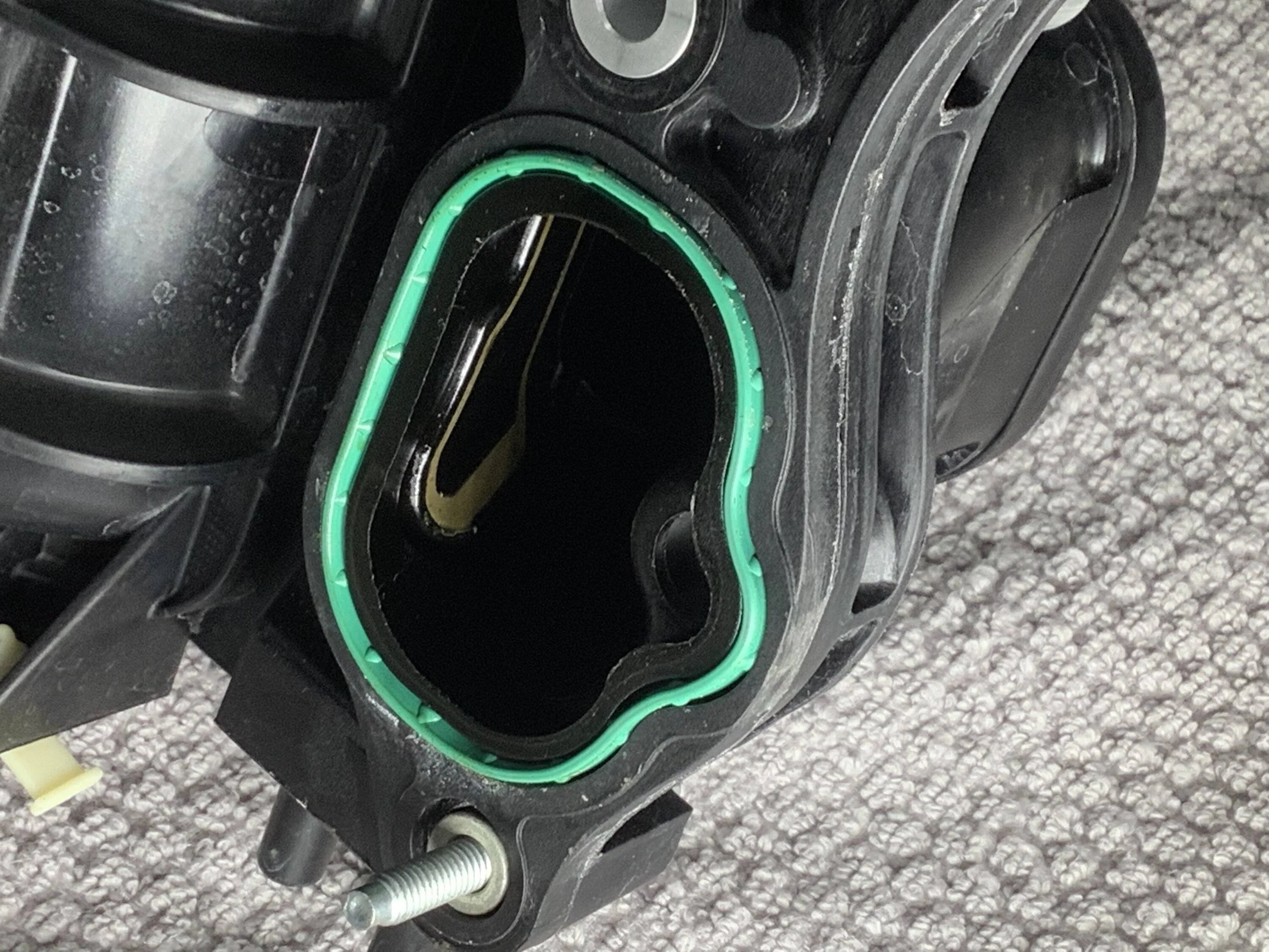

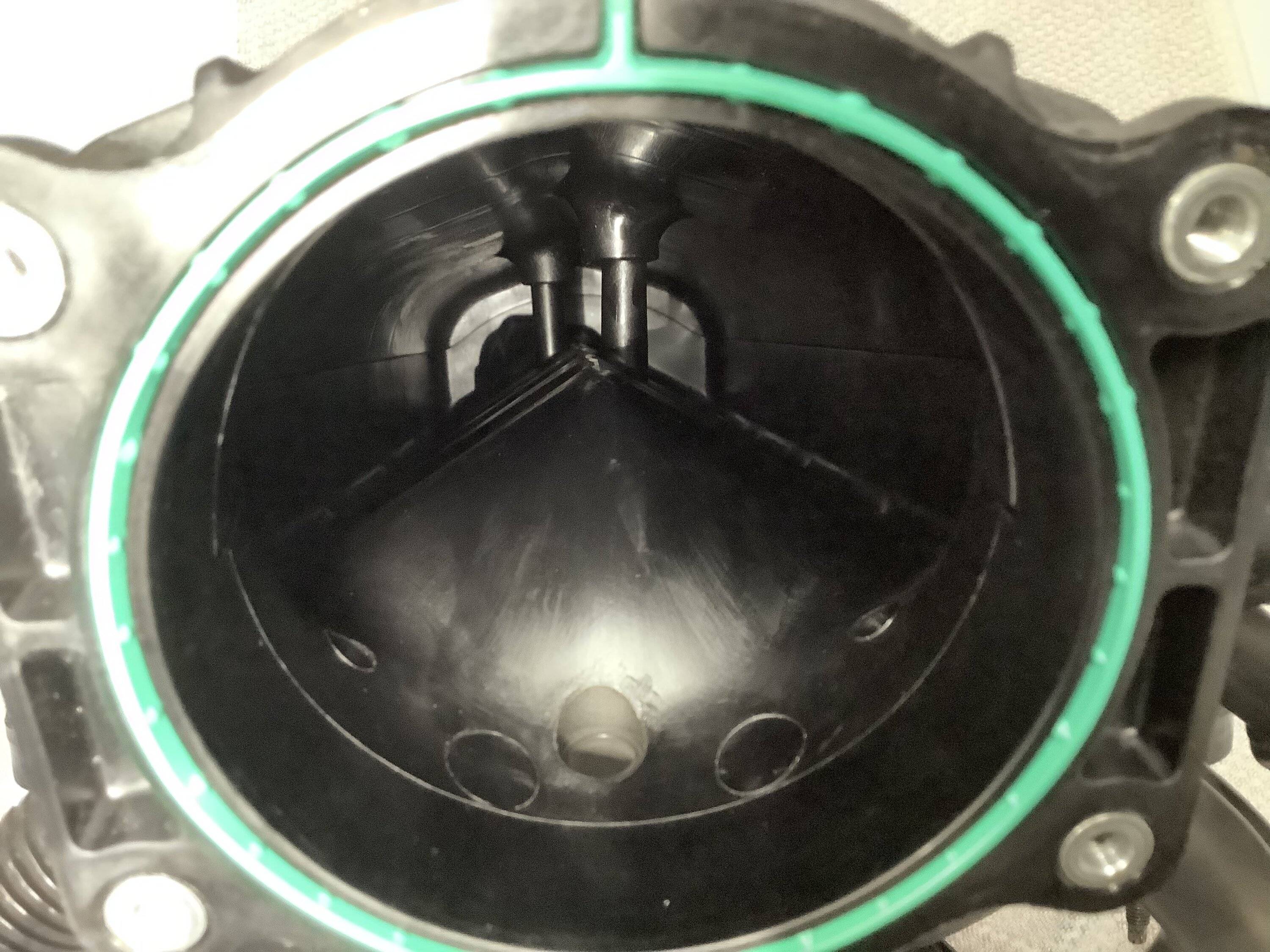

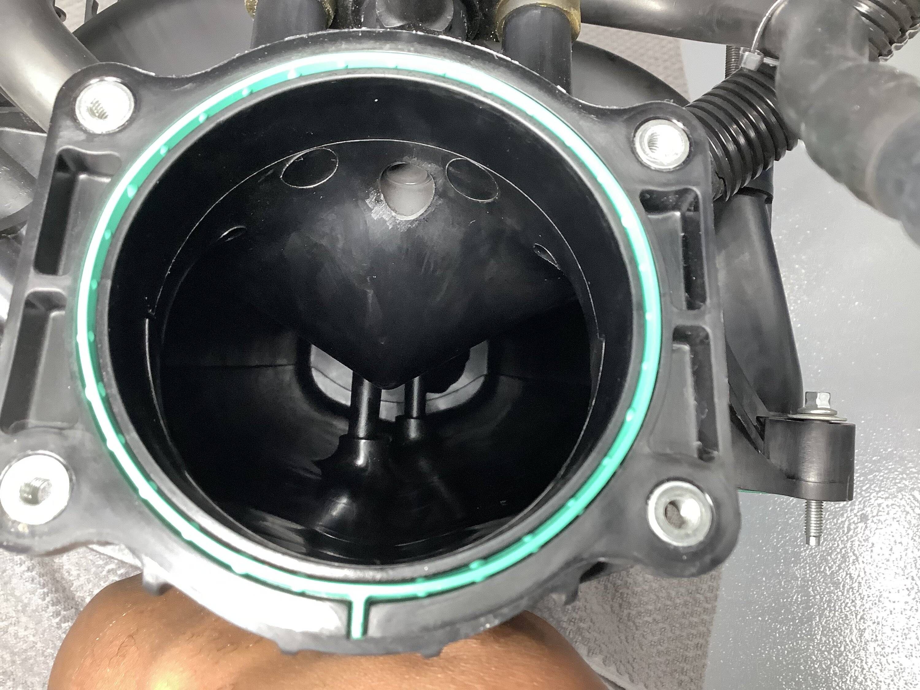

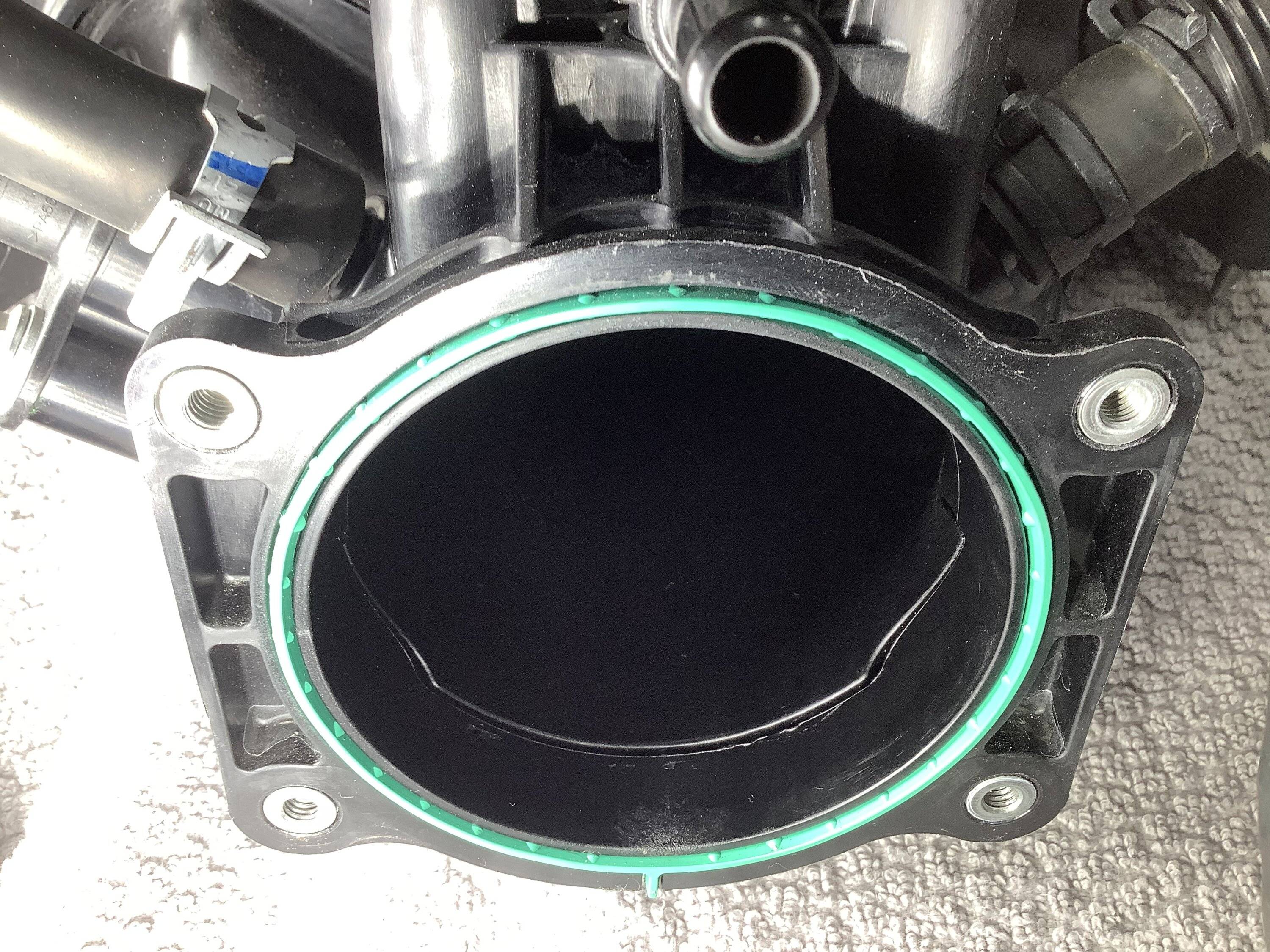

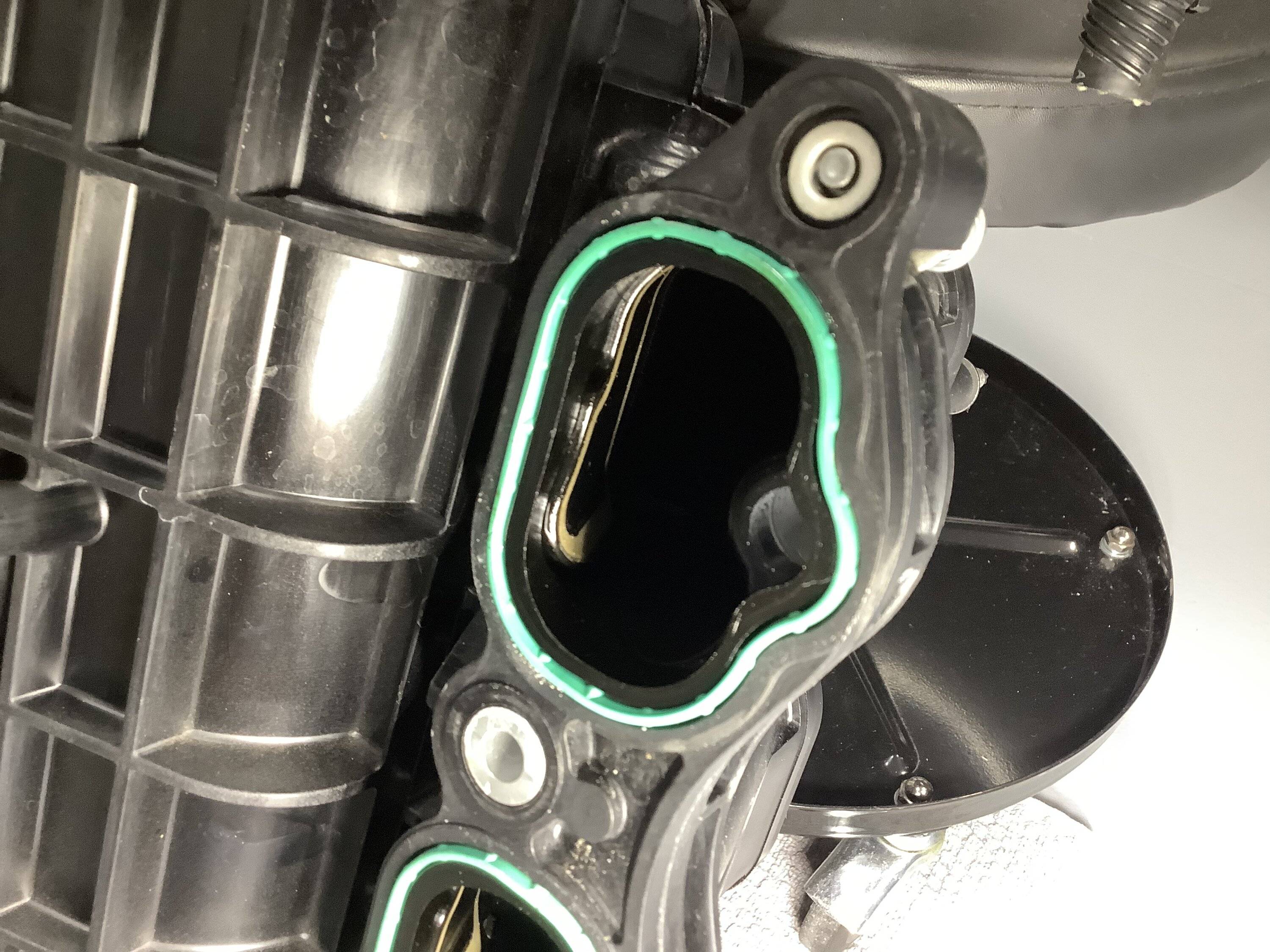

My 2019 Bullitt came with a GT350 IM. I’ve never seen a 2015-2017 GT350 IM off of a car, therefore, I don’t know whether they are the same. Here are some pics to show what my Bullitt IM looks like.
