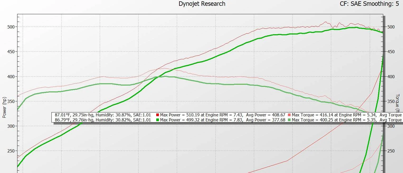

Blue line was November FBO on E"70", didn't have the ported 2018 &TB on that. Previous car was 472 with that on too.
Today, after tuning + Comp Cams NSR/supporting valvetrain upgrades, new 300-912 Holley Short ram, stock Buillitt TB. Bam.

Sure pulled up top. Any idea why so bumpy up there?

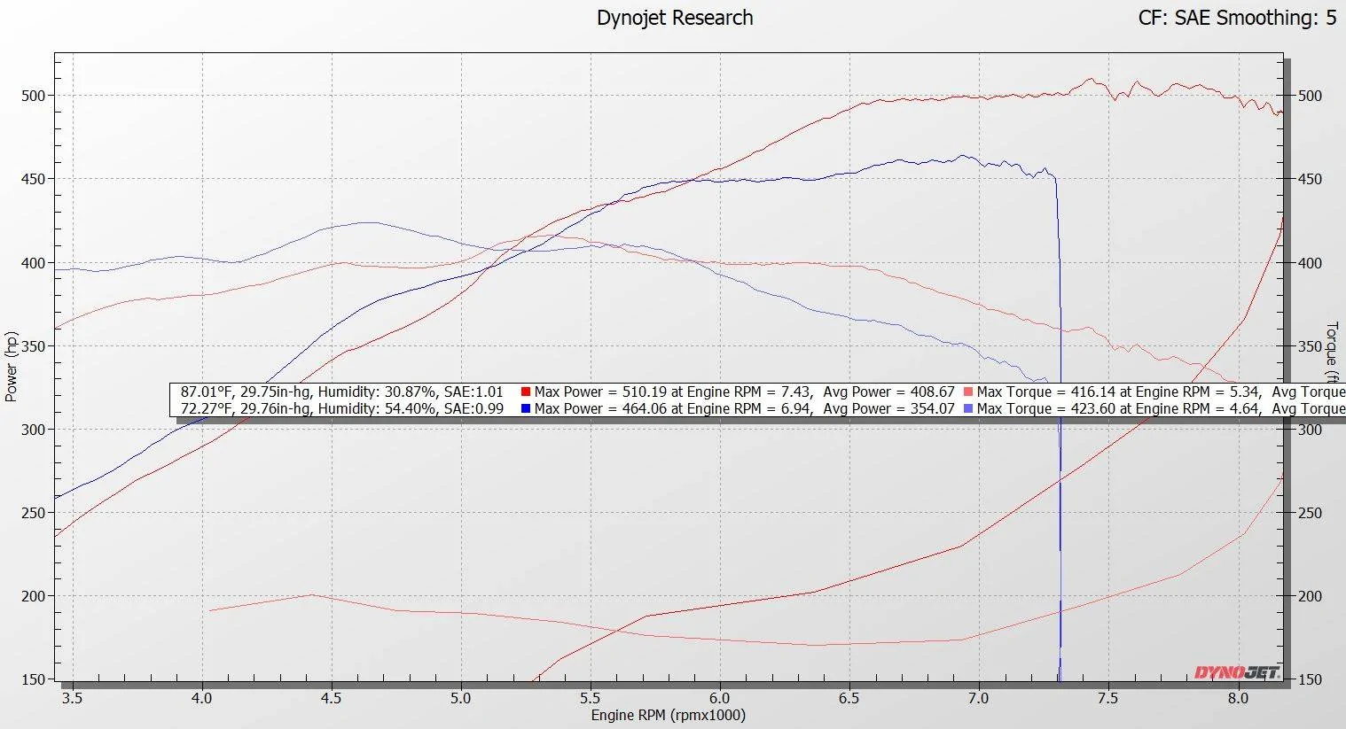

The squiggles up top were proven to be drivetrain related, suspension bounces and what not at up to 186mph. We tuned mostly in 6th gear which was way smoother. Here's almost the same tune, maybe a few hp down in spec in 6th gear compared to that final run in 7th. All SAE, no tomfoolery with the weather station. This is the high/2000hp dynojet version.. shop owner and my own comparison to other dynojet indicates this version is 5hp stingy.

Yup basically 40-50hp at top and extended power fairly flat to almost 8200rpm. I'm not sure what was limiting, I believe I had parameters uncapped to at least 8300rpm. With 8100rpm shifts, after the first few shifts at WOT, you're not really below about 7000rpm. So solid +40 rwhp down the strip, more or less.
Power peak goes from 6900 to 7800rpm

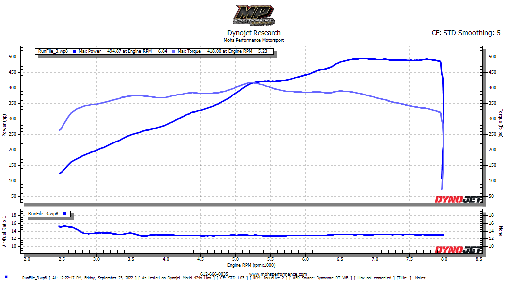

For comparison, user 'Kristang''s Gen3, Comp Cams with CJ and twinblade throttle body. mine is the Holley with untouched 87mm bullit TB. I have electric water pump. Kristang's #s are STD so subtract about 10 to compare to my SAE #s.
There's also a Comp cams/CJ from a year or so ago in the Dyno results thread sticky. Just cracked 500, maybe actually 503 or so with comp cams and CJ. But STD.
Holley and Bullitt TB +15 peak hp SAE. Mark G. claimed same as ported CJ. Seems about right if my build is ahead of the comp cams and CJ unported.

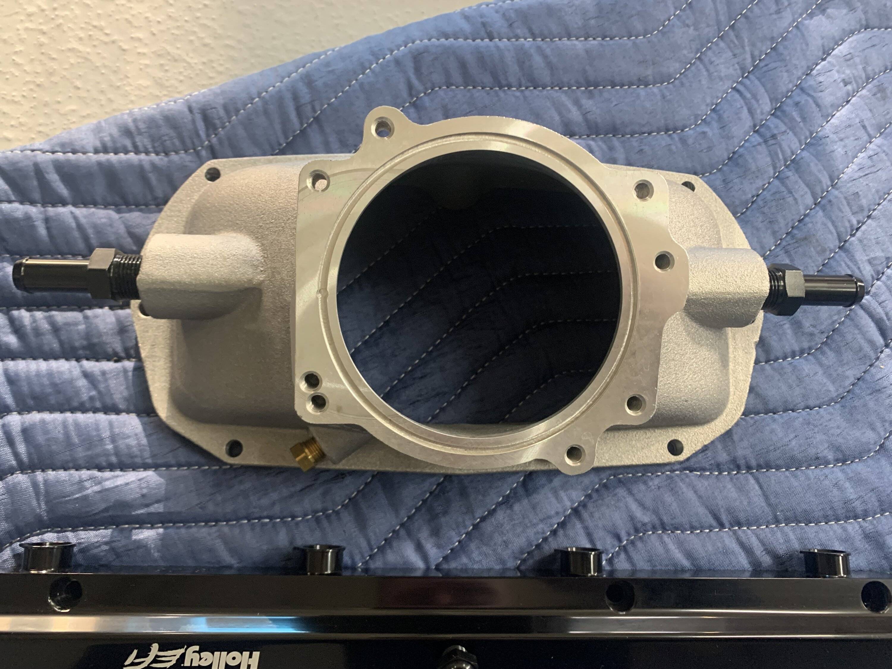

I don't know much about those specifically but I want to ! The stock Bullitt is ok but there's got to be some pickup with a bit more TB flow. The stock Bullitt (87mm) has a huge step in it. Bret Barber ports them and claims large but also admits it's really hard to tune. With the Bullitt as is, you have Ford's parameters to just cut and paste.
The snout opening is quoted at 93mm. Might be room for milling a few more mm like to 95mm or more if you get rid of that o-ring groove. My kit didn't have an o-ring for that groove so I'm installed just aluminum to aluminum.
After getting time analyze my tuning logs, I think there's good chance there's more in tuning as is. I had tried to test richer mixtures for some reason was still hitting 0.86 lamda at top anyway. I also see I wasn't testing in one direction for intake cams up to 5500 because I was commanding past a limit.

You should talk to Mike Soler.
He’d probably suggest porting out that O-Ring and going to a gasketed TB, depending how large of a TB you want to go with.

Anyone have any idea what the weight differences are between the Holley low-rise and the CJ? I can't find a weight for the Holley. I imagine it is significant in regard to "its heavier" but I'm not expecting anything extreme.
Also, anyone use one of these?
